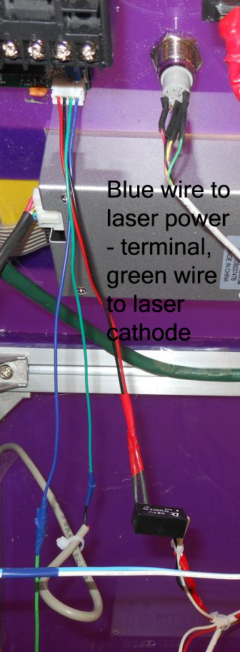

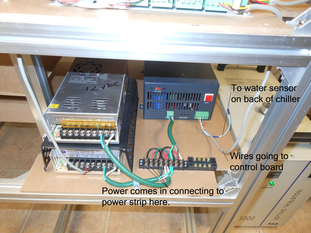

Ok, here are two photos, one showing the laser power supply and the other showing the meter wiring. I'm sure they're wired correctly but thought posting the photos would at least help confirm that.
Basically I have an outlet/switch mounted to a front panel where AC power comes in. The power coming in is connected to a terminal strip where it is distributed (in parallel) to several circuits which include the laser power supply, the 24v power supply and a 12v power supply used to supply power to an exhaust fan and a few other devices.
Then there's an upper control panel which has the DSP control panel mounted to it, the power meter and some other meters and buttons controlled by an arduino uno. Those circuits only get turned on when the buttons are pressed which turns on the air blower, air exhaust fan and a counter to keep track of the number of hours on the laser.
I'm really at a loss as to why the laser isn't cutting very deep and why the meter starts to display the current and then goes to -E.E. Anyone have any ideas, comments, suggestions?
Bob
Bob

Ok, I reversed the blue and green wires. Now I have the green wire on the meter connected to the negative terminal on the power supply. I have the blue wire connected to the cathode of the laser. The same test was ran, 70% power. The cut is still very thin, only a few thousands of an inch deep. The meter reads positive now but is only showing 1.7 when at that power, it should show around 22 to 24 ma.
So there's still a problem and I'm still wondering if the laser power supply is bad or if I have some setting incorrect. Any help, comments or suggestions would be appreciated.
Bob
Bob
Re: Power meter shows EE when laser is operating
Bob
Follow the diagram I sent you:
viewtopic.php?f=16&t=1759
You may want to reverse the Green & Blue wires as the they (supplies) sometimes swap the two wires
I mentioned many times not to use color code but look at the legend mark printed on the PCB
When laser is not firing and seeing "-" is normal as i5 is in open circuit
NEVER connect the current meter in PARALLEL to the load. You will blow the meter badly (kill it)
Now your current meter beciming a "voltage" as the internal shut should be cooked and well done

I just spent several hours aligning mirrors with targets taped over the round openings. This are pretty well aligned now. Reversing the wires did get rid of the negative reading and it's wired in series and is now reading 24.5 on the meter at 60% power. I tried 70% power and it went to 28.0 on the meter which is the max for this laser.
I was able to cut a 1/4" piece of plywood at 60% by slowing the movement down and power remained around 24 ma, so I think I'm in business now. I'll continue to run test cuts and get more familiar with what I can cut and at what power and speed.
Bob
