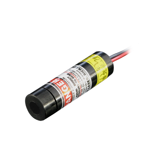

Found this low cost adjustable focus point 5mW 650nm (red) laser.
Length: 35.7mm
Diameter: 10mm
Power: 5V
5mW Laser pointer with adjustable focus point

I bought a bag full of these about 2 years ago and they are good value for money. They are also the ones I have had the lenses crack with the 100 watt laser. I have also had 3 other different brand ones crack as well so it isn't a design problem with this particular laser pointer.
The focus is adjustable as well.
