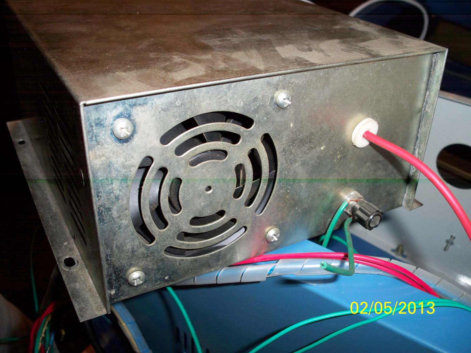

Correct type Power Supply?
wrench
Posts: 24
Joined: Sun Sep 13, 2009 12:54 pm
Post by wrench »

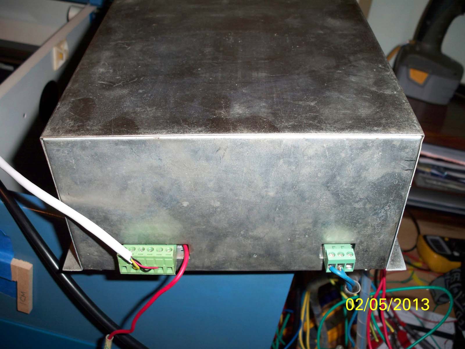

Can I use this Power Supply with the DSP Conversion? The Contacts have no labels or markings e.g TH,TL...
Posts: 4654
Re: Correct type Power Supply?
Look like OK.
The terminals should be arranged like this:
TH TL WP GND IN +5V
If you tide TL, WP to the ground and +5V to the IN, it should fire in 100%

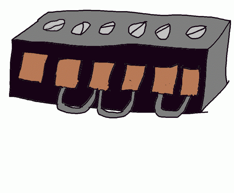

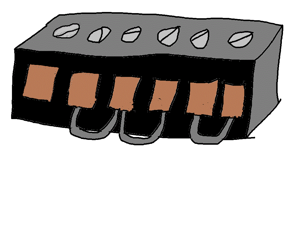

Tie like this?
Posts: 4654
Yes. But I'll add a push button switch between "TL" and the "GND". That way, you can manual control it On or Off by the button switch

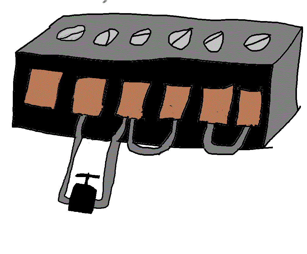

Like this? And what will this button control?
Posts: 4654
No, that is no difference at all.
Break the connection on #2,#3 (counting from Left to Right) then add a push button

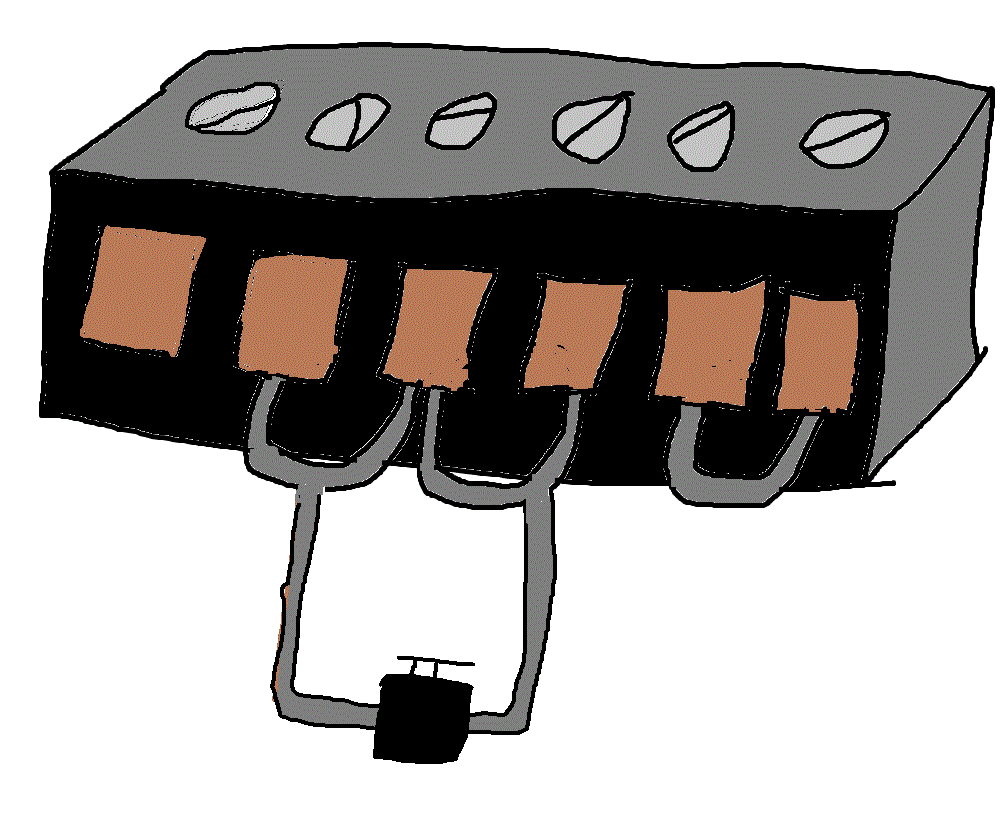

Like this?
Posts: 4654
You got it

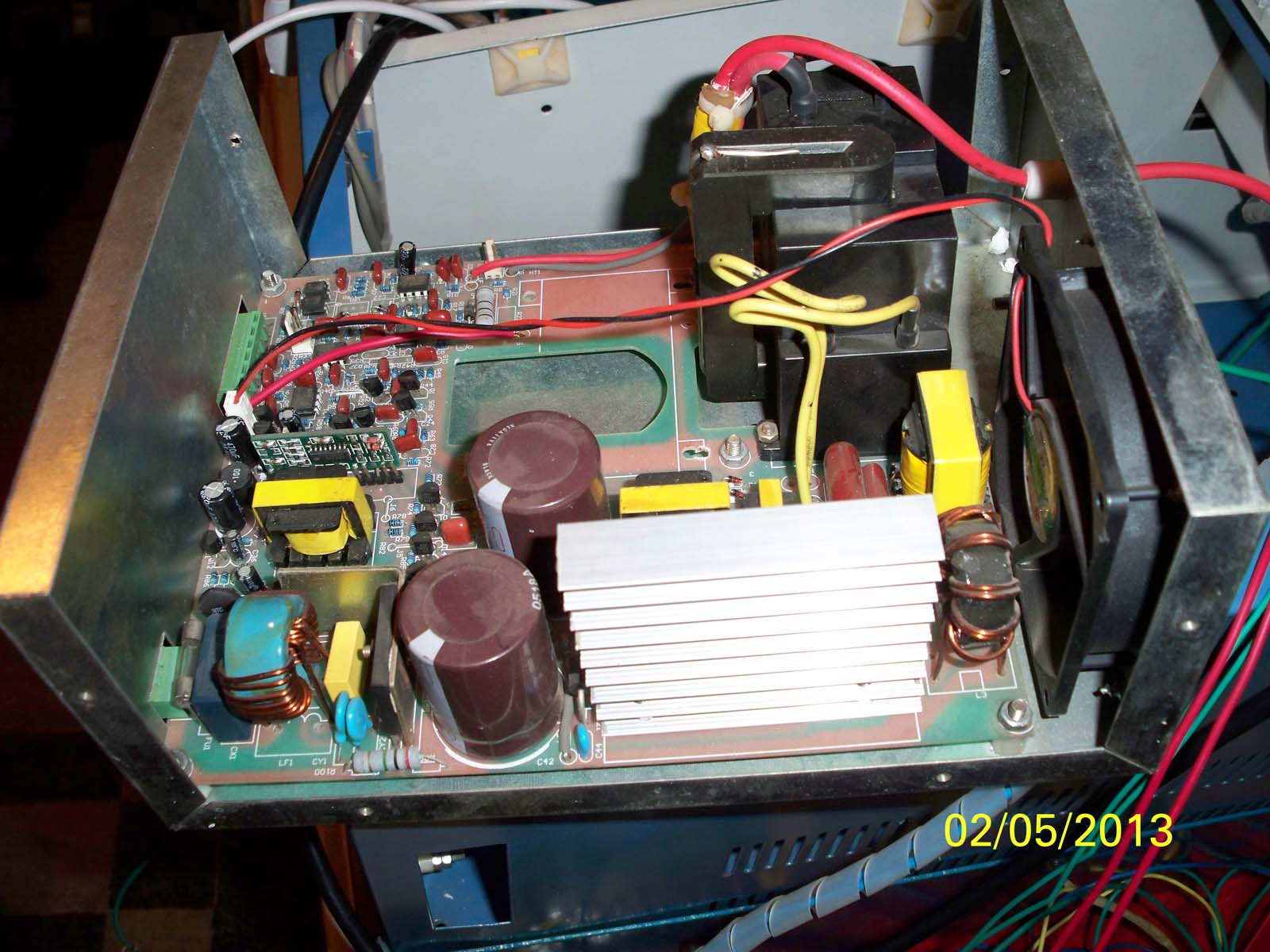

In my first post on this thread I posted three pictures of my Power Supply.
The second picture show a big RED cable that goes to the tube.
The third picture shows a smaller RED cable that I think went to the old analogue gauge. Where does this wire go to now?
