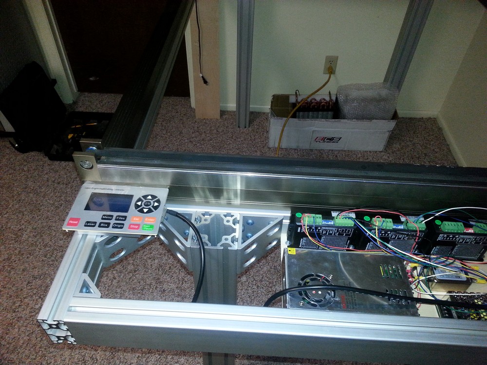

You can control the direction of HOME on LaserCad. Plus, you need to get a proper "um" in order for the motor to move smoothly. What machine are you running? Pictures? I always ask folks to post pictures when there is a problem to setup a machine other than K40

Alright, here are a few pictures.
One thing that I've noticed is that for the X axis, if I press the Right button on the panel, the laser head moves Left, and the Left button moves it to the Right...
I still have the calibration to do, so I'm still looking into that.

[quote="jarbon"]One thing that I've noticed is that for the X axis, if I press the Right button on the panel, the laser head moves Left, and the Left button moves it to the Right...
quote]
That is a simple problem and can be fixed by using LaserCad to change the direction of the movement. Please review the manual as it is clealy explained so I'm not going to explain again
quote]

Changing it in LaserCAD will change it on the control panel, then? (I'm talking about the hardware panel, not the software panel)
