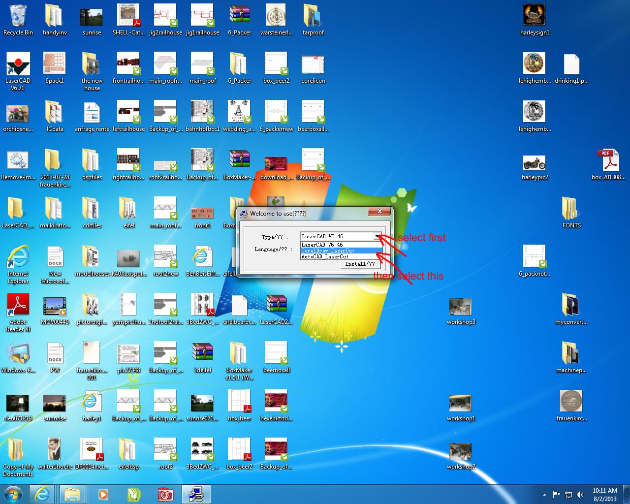

Re: Problem when import AI files, created in Adobe Illustrat
Ok guys
what version windows you guys are running??? if you run windows 8 already then its clear because the lasercad ( not lasercut was my mistake) does not work with windows 8 jet.
if you runn XP or windows7 then you should un-install lasercad including manually delete all lasercad files from the directory, empty the recycling basket. then shut down computer and restart then install lasercad new like shown here on the picture
then proceed with the previous picture for the CorelDraw macro
