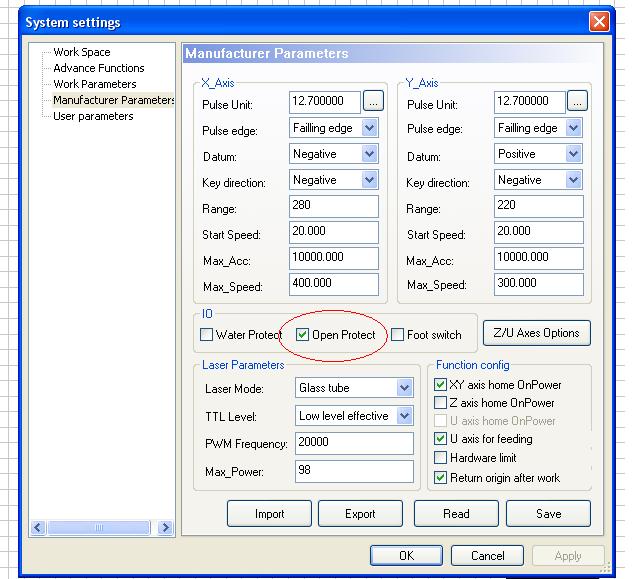

So I wired the switch into INT1 and GND and ran a job and tested it and I didn't see a result. Did I wire it wrong or is there a software switch?
Re: Open lid switch to the DSP
Gnd and INT1 shorted will turn off the laser and the machine until it closed again.
So you need a normally opened switch for that matter
Then, make sure to put a check mark on the LC to enable this function. See picture

Thank You!!
