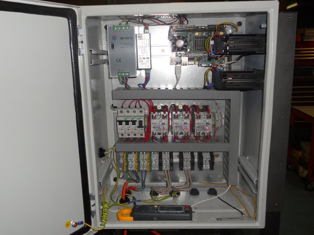

Here's the control enclosure

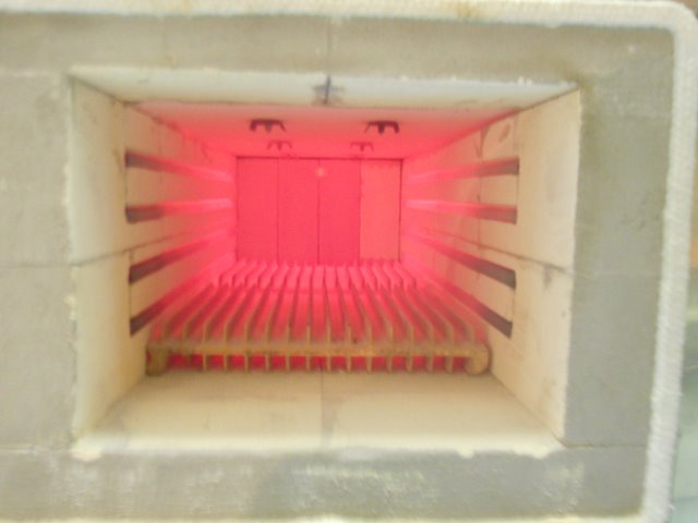

And of course a shot of the inside of the furnace..
