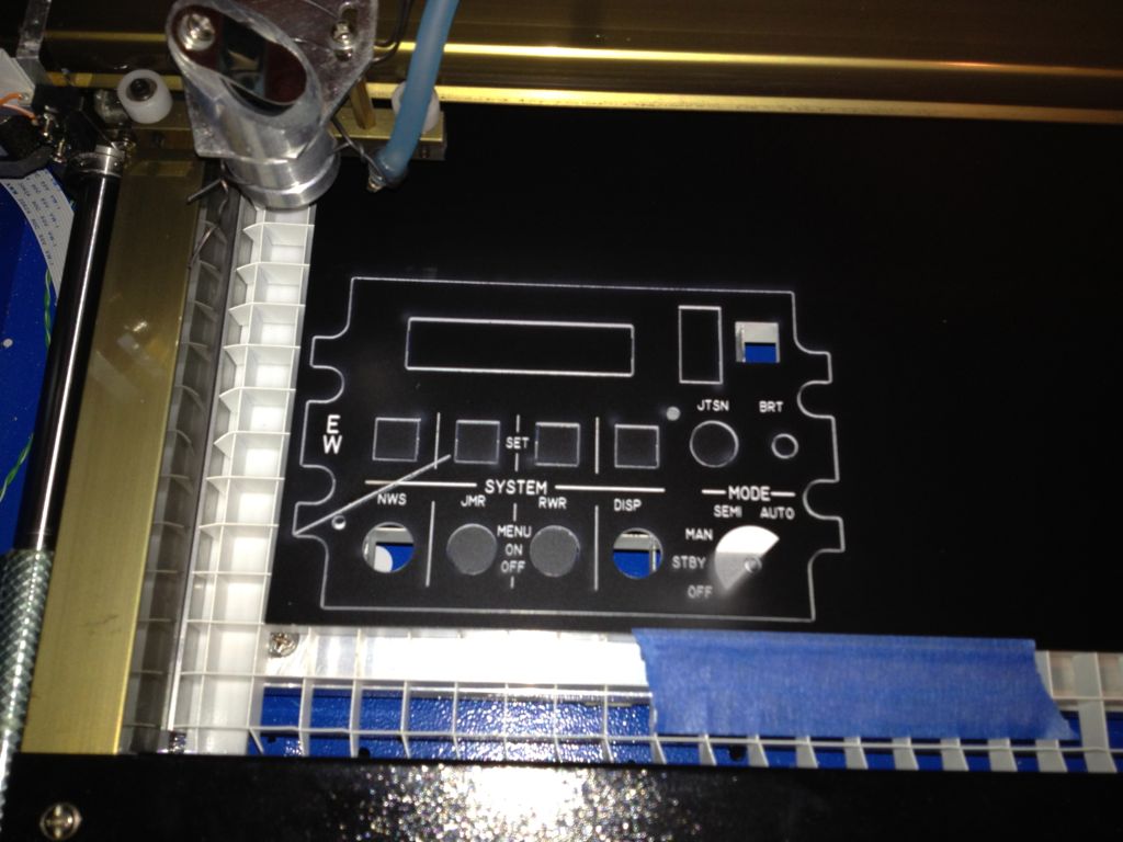

2) When the laser finished it's last cut on item 1 it did not turn the laser off before jogging to the next item causing a huge cut through the middle of my first piece. I have attached a picture of it. As you can see in the picture the last cut finished in the lower left corner and then the DSP started to move the laser head up and to the right to move to the next item in the array, but did not turn off the laser before doing so. I'm not sure whether this is a bug in the DSP or the version of LaserCad, but it effectively prevents you from using array output!

This is still happening with the latest firmware and laser cad 5.8.5. I just tried using the feature again. The laser is not turned off after the last cut on the first of the array, then the laser is moved to the start cut for the second array item. The laser is moving at cut speed and not space speed when it's moving between them as well. It looks like the DSP is not exiting cut mode at the end of the object, or possible starting in cut mode at the beginning of a job (which could also explain the 1/4" cut problem as well.)
