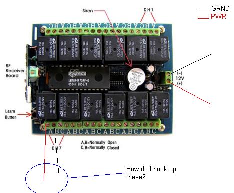

I ordered my new 12ch remote setup and have read through all post I can find on it. I tried to program it and everything went smoothly. Help program button til I got six beeps to reset it. Pressed it again and got the steady tone then quickly pushed button three and I got three beeps. That says the mode was accepted.
My problem is that I don't get power to any of the terminals at all.
A,B- normally open
B,C- Normally closed
Ive got that part but how does that translate to ground and power?
This what im trying to do....

As I explained before, the relay is just like a switch. Unless you route power to either COM or the NO port, there won't be any voltage coming out from the relay.
See the basic relay connection diagram at here:
viewtopic.php?f=12&t=316
