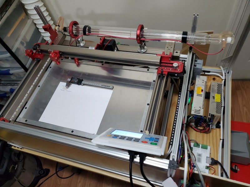

Long story short, I built a custom laser engraver and had double engraving problems. Marco was great, quickly answered my questions trying to resolve to no avail. I simply thought my over ambitious XY Stage was flawed so I built a completely new machine, this time using a PR5030 XY Stage from LightObject. The stage was stellar and everything is moving super smooth. Belts are properly tensioned and it feels real dialed in.
Now the problem, after buying a XY stage, building a whole new machine, I have the EXACT same double engraving issue. The only thing in common between the two machines are the X7S controller, power supply, and laser tube (and I ruled out the power supply and controller). When engraving the first line is always shifted left (the head is moving right) and the next line is shifted right (the head moving left). The faster the speed, the greater the distance between the double image. Either the laser is firing early or the x motor is moving late.
What has been ruled out:
The machine itself, with the change of the xy stage, all new motors and stepper drivers.
Power Supply - swapped with another power supply out of my K40 machine, same issue.
Belt tension - it has been raised and lowered, both with zero change in the problem.
The Controller - Swapped with a old AWC608, sent the same settings to it with the same results

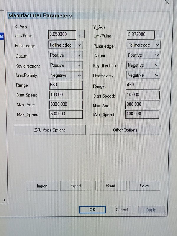

The only things that are consistent:
The laser tube (SPT C40)
LaserCAD (I am running x8.12.21)
Settings:
Both: Falling Edge
X Start Speed: 15
X Max_Acc: 3000
X Max_Speed: 500
Y Start Speed: 15
Y Max_Acc: 800
Y Max_Speed: 400
Stepper Controller Microstepping: 6400 Steps Per Rotation (32 microsteps)

video of engraving operation @ a speed of 300, power 20% photo of the results showing line shift photo showing scale of issue (almost 4mm, if it is a play/tolerance issue i would have to have 2mm of backlash, don't see that being possible) photo showing settings in LaserCAD photo showing current state of machine build photo showing LaserCAD version Build Specs:
XY Stage - PR5030
Stepper Drivers - DM420T
Tube - SPT C40
Power Supply: CloudrayLaser MYJG-50 (black case)
Controller: AWC708S (LO X7S), firmware 1.20
Included are:
XY Stage - PR5030
Tube - SPT C40

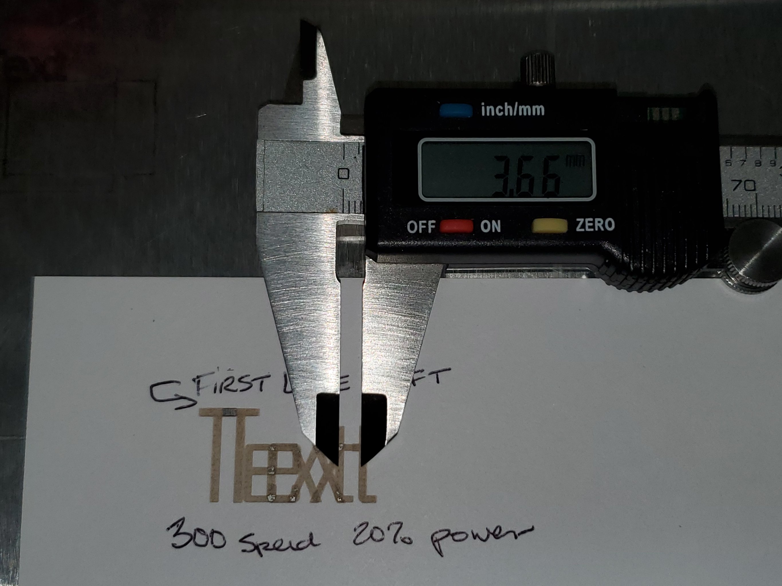

Update:
Worked on it a little more this morning with no progress.
What was done this morning:
Verified that set screws were tight on all pinions (the motors that came with the XY stage had press fit pulleys and were missing the set screws, I replaced them)
Retensioned the belt to about 1/4" deflection with the head all the way to one side of the gantry.
Swapped out the laser tube from the K40 to see if the tube was part of the problem, no change.
Verified mirror alignment, everything is dead center at all four corners of the bed, vertical alignment is centered as well checking at a depth of 2" and 6"
Can get a clean single image by using a engrave reverse offset of -3.6mm @ 300 speed in the software (but I shouldn't have to).
Doing the math, having to use a negative 3.6mm offset equates to the laser firing about 6mS early since I have checked every conceivable mechanical cause and have officially swapped out every single component except for the software (although I have tried 3 versions of laserCAD from 6.8 to 8.12 and lightburn)
Dropped stepper drivers to 3200 steps per revolution (16 microsteps) and adjusted uM appropriately.
If I have to operate with a speed defined offset to make it work I will but that to me is masking a problem, I would much rather fix the actual problem. Any advice from Marco or the community would be greatly appreciated. Since I started with this hobby, this forum is always one of the best sources of help around and the crew a LightObject know their stuff.
David
David
Re: Double Engraving Problem - NOT A MECHANICAL ISSUE
Hi Dave:
Can you post a video showing the engraving in process? I want to see how the double image happened. It is so strange that happened.
By the way, please change the setting (won't correct your issue but will work better)
Settings:
Stepper Controller Microstepping: 5000~5000
Both: Falling Edge
X Start Speed: 20
X Max_Acc: 15,000
X Max_Speed: 900
Y Start Speed: 15
Y Max_Acc: 3000
Y Max_Speed: 400
User parameters:
Start_Speed:20
Space_speed: 3000
Cut_Jerk: 4 (40,000)
Space_jerk: 5 (50,000
Speed_factor: 1.5
Mini_Acc: 300
Engrave_Acc: 15,000
X/Y Home: 100
Settings:
Both: Falling Edge
X Start Speed: 20
X Max_Acc: 15,000
X Max_Speed: 900
Y Start Speed: 15
Y Max_Acc: 3000
Y Max_Speed: 400
User parameters:
Start_Speed:20
Space_speed: 3000
Speed_factor: 1.5
Mini_Acc: 300
Engrave_Acc: 15,000
X/Y Home: 100

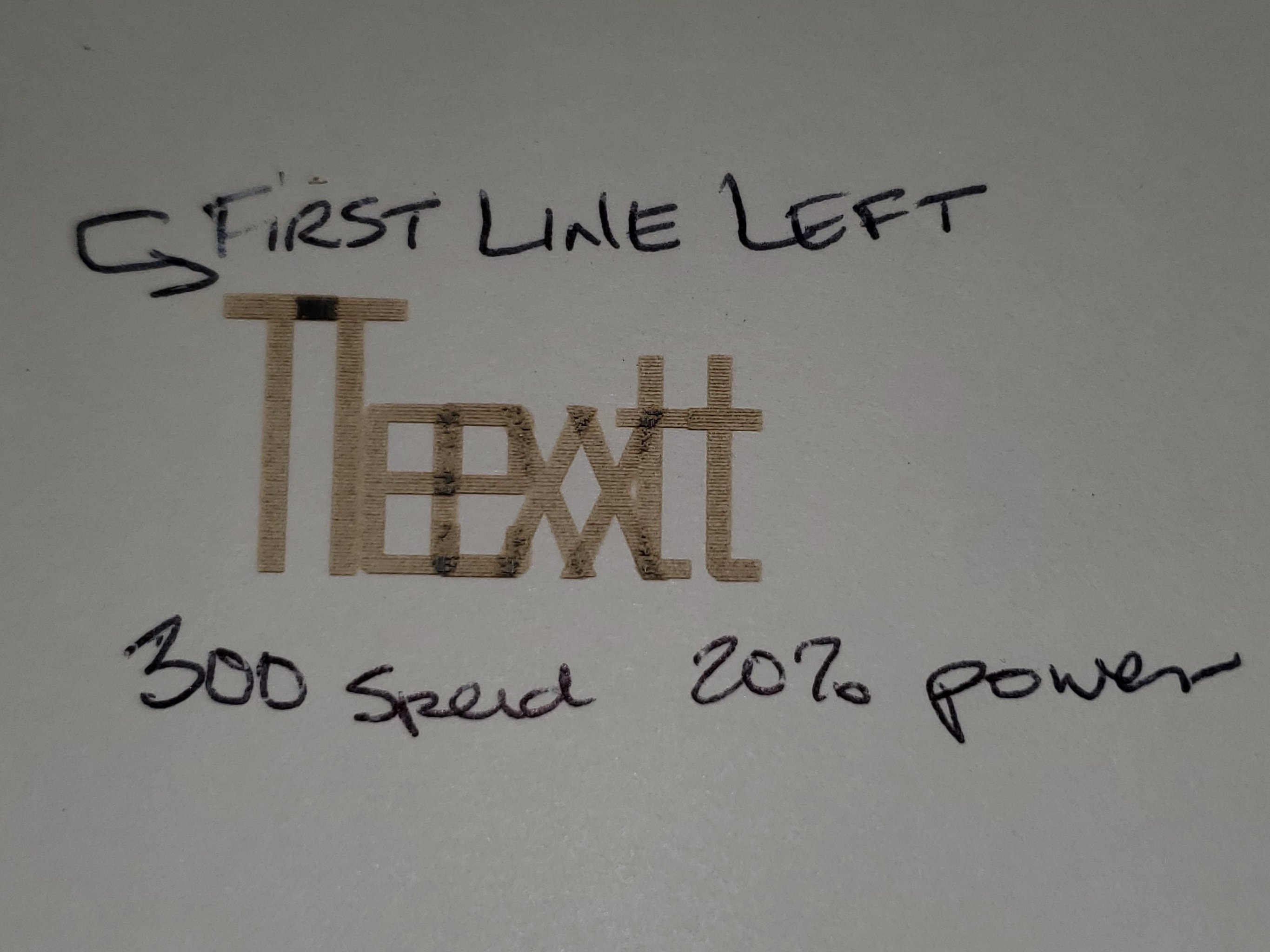

See my setting added after my post
BTW, the issue on your case seems a mirror or lens issue. Or, the beam was hitting to the laser tip
Clearly the beam is split.
Do burn test after the tube, 1st mirror, 2nd mirror with power set to roughly 10% on the LCD control panel
You need to check each beam spot after each mirror.
Thanks Marco I really appreciate it. I have done that but will go over it with a fine toothed comb again.
On my inspection yesterday, mirrors are secure and I aligned each in order starting with the tube mirror, x axis, then the head mirror. All are centered at all locations throughout the bed. The laser head mirror was centered as well with a dot burned at 2" and the bed dropped to 6" a larger out of focus spot made and they remained centered and inline. I used a small machinist square to ensure that the beam was exiting the head in the center. I initially suspected a reflection too, so went to great extremes to rule that out. As shown in the video, I did the test without the air assist cone on to minimize the opportunity to reflect.
If the video is slowed down, it is clear the left image is burned when the head is moving right and the right image is burned when the head is moving left. They are burned separately, alternating the bi-directional scan lines. If I do unidirectional and not bidirectional I get a single image, but it is shifted to the left. I will add some photos in a bit that demonstrate some of this.
Again, thank you for the prompt reply. I will get back to you after some further testing.
