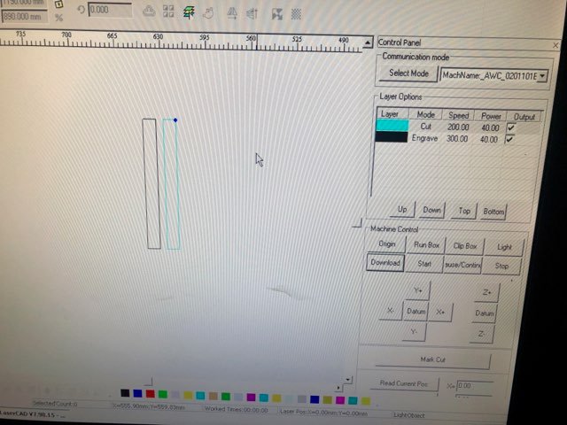

HELP!, I swapped out my controller on my laser for an AWC608c Controller a couple of years ago. This machine is mostly used as a hobbyist machine. It worked great up until 5 or 6 months ago. I tried generating a file using different software nothing helped.
Here is what is going on with the picture I have uploaded.

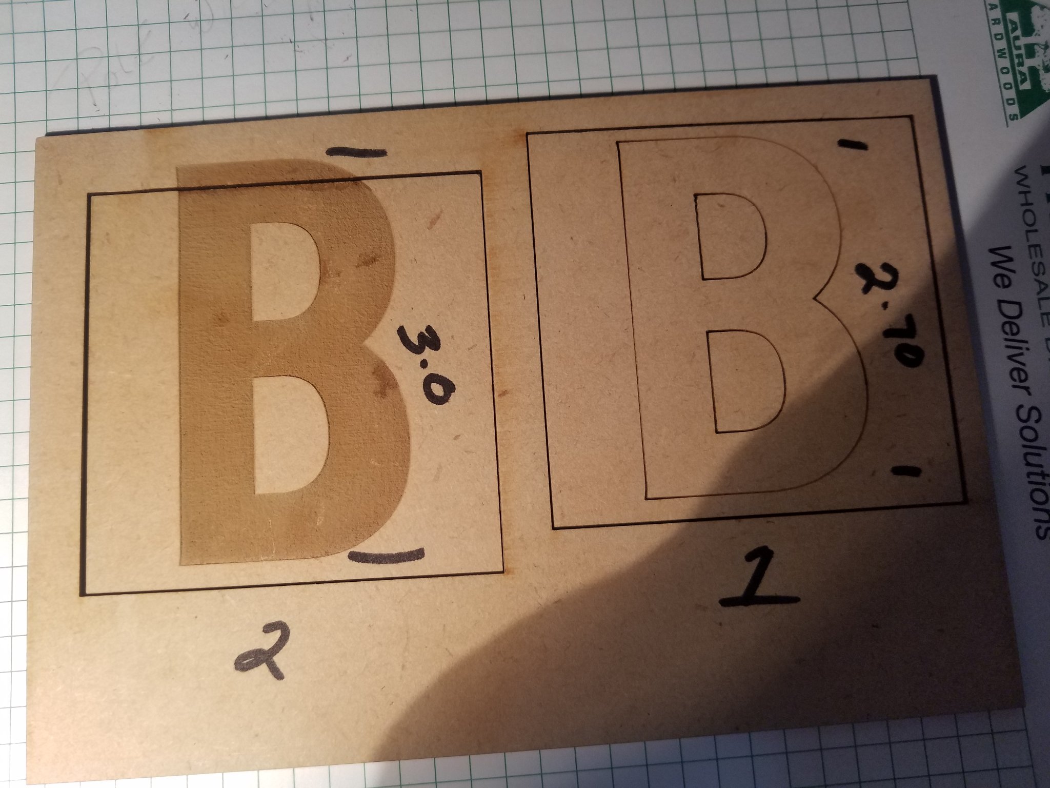

Picture #1..The letter “B” is raster cut then the box is cut with the Letter “B” centered in box. (Everything cuts correct and is the proper size and location)
Picture #2.. First the letter ”B” is engraved. Notice the size is stretched in only the Y axis. Then the box is cut around the letter. Notice the box is shifted down also. If I cut the box first it would be lined up with box in picture #1

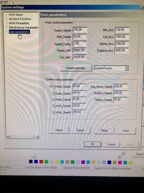

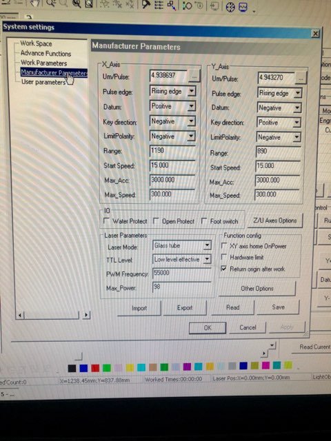

Can you post screenshot over user and manufacturing parameters here so that I can review.

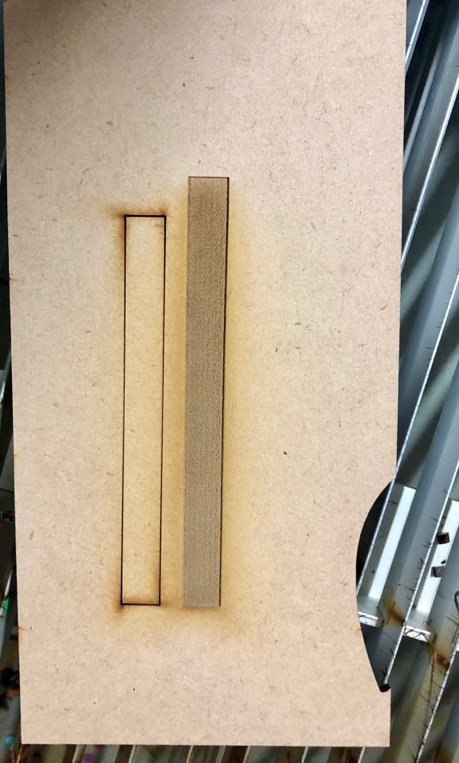

What you want to do is to draw a long box say X:10, Y:100. Then, do it over engraving and another next to it for cutting. Compare the result. I guess the one with engraving on it could end up longer than the cut.
Let me know

Ok Marco here are the photo's you asked for. Please let me know if you need something else.

Marco on the letter "B" I posted earlier the cut "B" was 2.7" tall. The engraved one ended up being 3" tall

I notice the pulse edge on both (X) and (Y) axis is set to rising edge. could you change that to falling edge? and retest

Ok, we changed both to falling edge and did the same test with the rectangles...same results as before. The engraved one is longer.

Hi there, It seems that your Y um is off when engraving, I would also suggest the built-in ‘um’ calculator on the LaserCad to find the correct ‘um’ value, draw a square 100 mm X 100 mm, cutting, then engrave to make sure it remains within the square.
Also have you try swapping drivers?, plugging the Y stepper motor to the X stepper driver and the X motor to the Y driver. Try engraving and see if the same problem remains.
