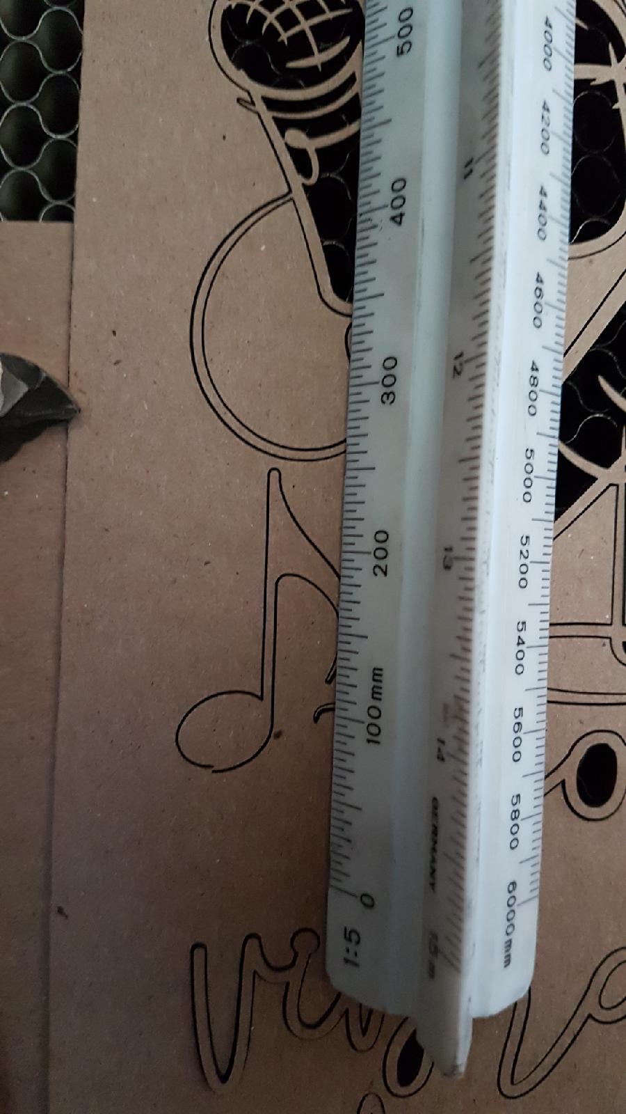

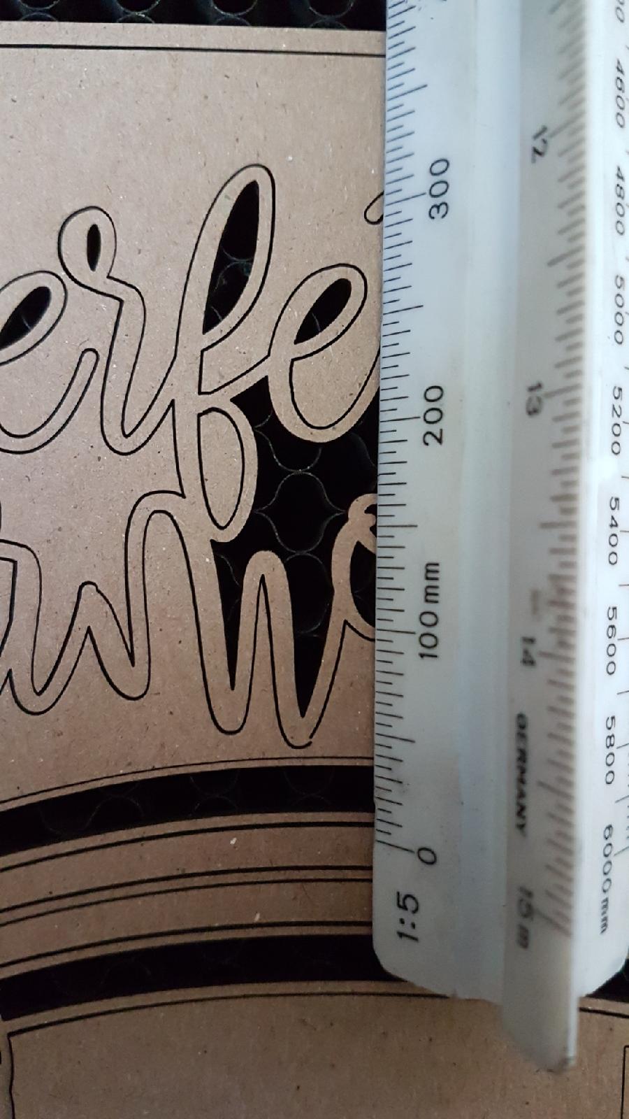

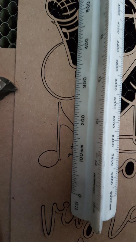

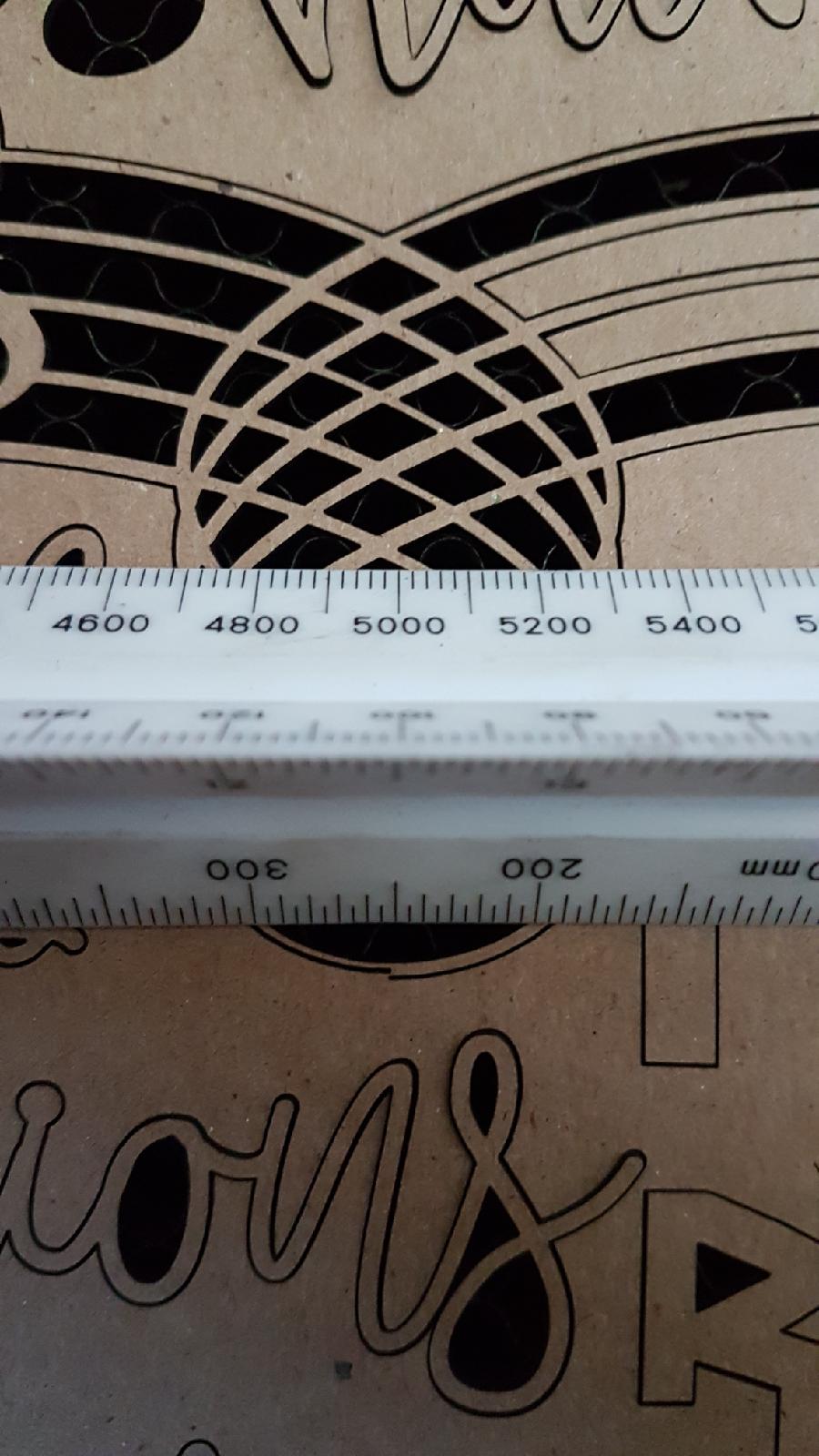

Hey folks...
Got another issue that I've stumbled on and I've exhausted all my ideas.
I recently replaced my v-groove bearings, rails, pulleys, and belts. The belts are now upgraded to GT-2 belts (SO much better).
Problem:
Occasionally on a curved line if the start/stop point is on there, it will do this offset. I have ruled out using "Manual order" to change the start/stop point to different area since it happens only sometimes with only certain vectors (not all curved surfaces which I initially thought). It's not the X/Y axis because everything else is 100% accurate without oblong shapes or inaccuracies. It's not all curved surfaces since they all cut very nicely. I just re-calibrated my steps which ended up being I believe 12.43 uM to be spot on. It's not speed dependent...I cut out a square and it's within less than 0.5mm square.
This is using LaserCad 7.98 with the latest firmware (as per the software dev's website). I'm at a loss here...any of you know how to fix this?
