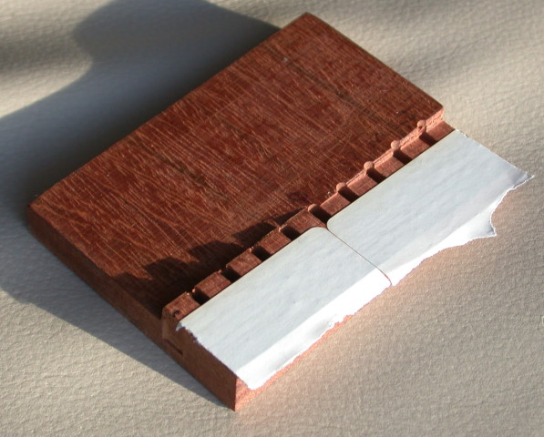

Lenses do vary a bit.
There is a way to find out the exact focal point, but you need to make a simple tool:
Make a block with a ramp on one side, about 100mm in length and with the ramp sloping from -5 to +5mm. Next to it a part that is at 0 level.
stick a paper on the ramp. Focus, like you did before, on the 0 level. And let the laser draw a line over the ramp with a length of 100mm (low power, just enough to see the marking)
You will see that this line widens at the ends. Somewhere, you see, the line is the thinnest. That is where your focalpoint is.
If this is exact in the middle, than it's OK.
When it is about 2cm in the direction of the lower end of the ramp, your focolpoint is 2mm lower than what you set.

This makes so much sense, I will give it a shot this weekend, thank you!

Worked like a charm, I was pretty much right on. Thanks again!
