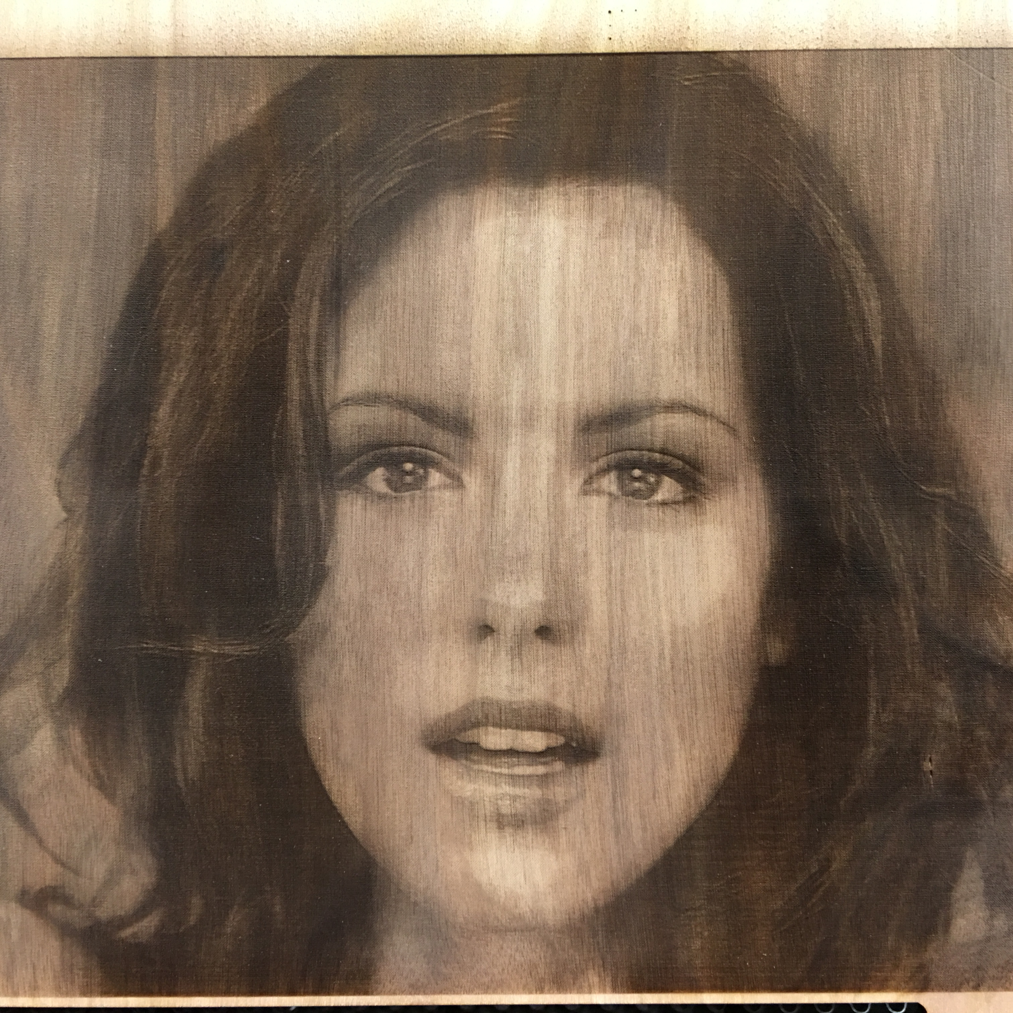

We have doing some tests on the T9 and currently is working on the video as well.
Following are two engraved images were coming out from default setting: dither:0.2mm, scan gap:0.1mm, speed:500mm/s, power(60W): 12%
Materials: Transparent acrylic + dark sheet background on reversed image
Materials: Birch wood from HomeDepot (not a good one because so many texture from the wood)
Will post more for fine tuning engraving and cutting soon! Will do rotary engraving as well with easy to use keypad.
