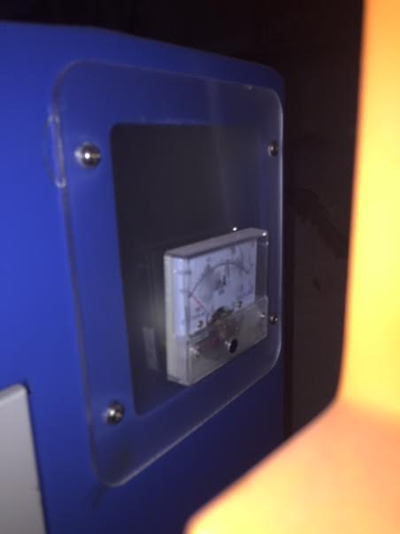

The bed is 500x300. I do realize its a 40watt tube, I put quotes around the 50 because that is what it is advertised as. I would like to step up to a 60watt tube and have seen many others do it by building a box to extend the tube past the case. In the case of my laser it would extend past where I have my meter mounted on mine as seen in the pics.
- unnamed.jpg (31.15 KiB) Viewed 4746 times
Re: New 60 watt tube and power supply
It is not just the length that you can add an extended casing, the other factor you need to take into account is the diameter of the tube. The 40W is running about 50mm (2") but the 60W is running at 60mm which is about 2.4". The SH530 as I know comes with two fixed tube mounts. I am not sure if there is a an alternative way you can go over it.
The connection for your LPSU is similar to ourd but not identical. But it is manageable.
Next thing is to check the mirrors and lens see if they can support 60W laser power.
Last thing to check is the water cooling. It is high risk if you are running a few gallon of water without using a chiller.

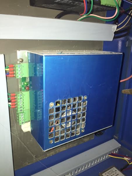

I do believe my power supply has gone out, water flow is fine and everything else is running fine, motors, X and Y, the laser acts like its working but the tube isn't firing at all. It started doing this half way through a job. It suddenly went from working great to not firing at all. There is a test button on the power supply, I can press that and nothing happens, press the pulse button on the laser and nothing.
You said that your power supply will work with my laser. Does it come with instructions on how to hook it up?
tansh
- Posts: 24
- Joined: Thu Dec 31, 2015 12:06 am
If I am not mistaken, the test button on the power supply works only "without" the signal cables connected (L, WP, G, IN). Is the fan inside the LPSU running? If you have a quiet LPSU with power on, then probably it's gone.
