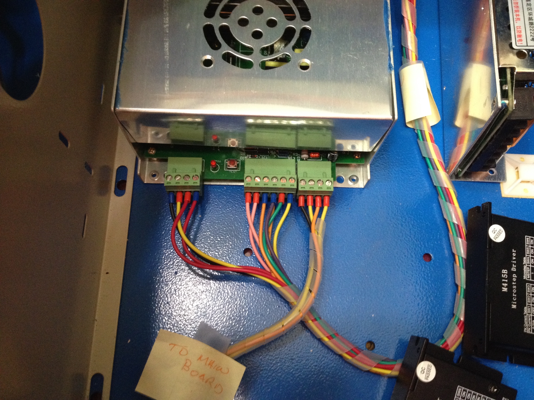

I purchased the X7 kit and I'm installing it right now. That's why I asked about the new mirrors. Next, I'm not very electronically savvy but I can follow the wire diagrams. Where I'm having issues is my PSU doesn't look like the wire diagram. Can you tell me which wires in the photo represent the wires in the wiring diagram.
