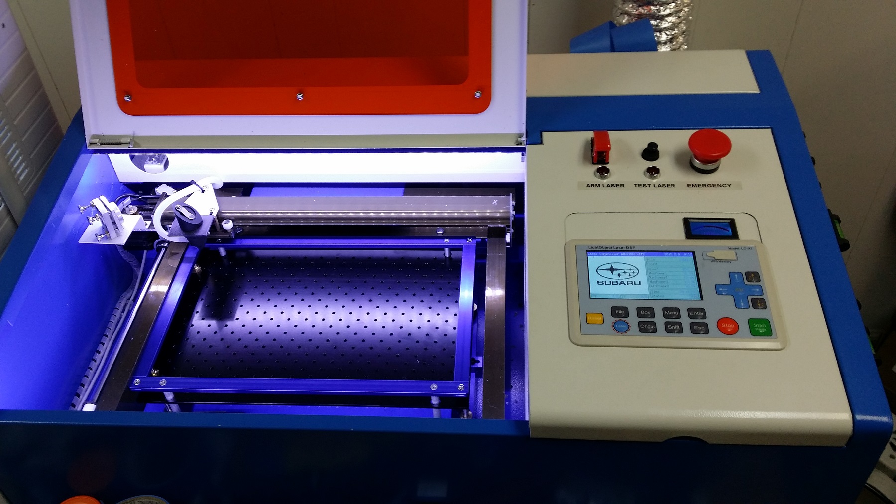

Thanks everybody for your help.......Especially Joe AKA " acuralegendz " who got me hooked on the Laser to begin with.....Now i just have to realign my mirrors and im good to go......

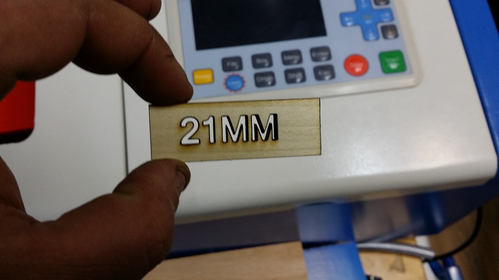

My first cut.....A block for my focal point measurment....

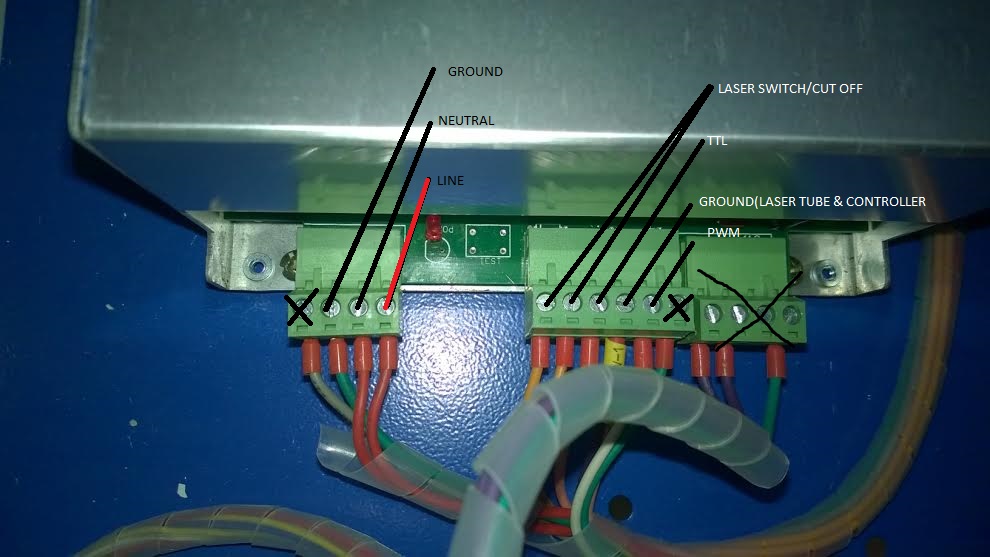

Can you tell me something
How did you wire up the TTL and PWM connections.
I have a very similar PS to yours and have held off till I got a definitive answer.
I really don't want to let the magic blue/grey smoke out of the components if you take my meaning (fry the poor thing).
Thanks for posting and again VERY AWESOME!!
James

Here you go....
