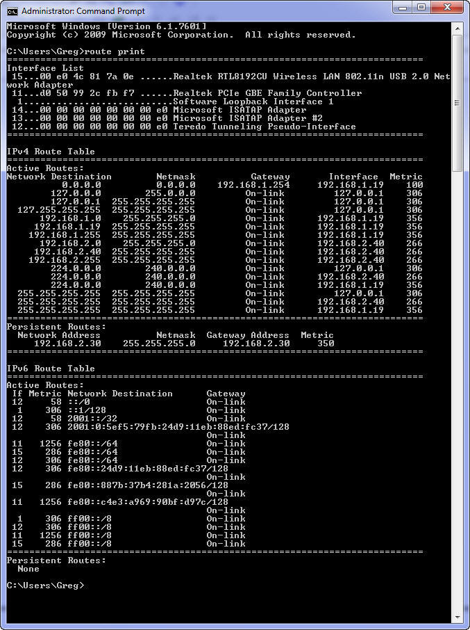

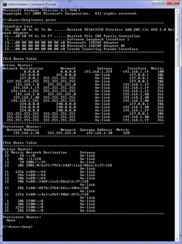

I have followed Maverick's instructions as well as I can.
Unfortunately the problem is the same. Most likely I have stuffed up somewhere.
Here is a screen grab from a "route print" which shows the result of the "route add"
The Laser IP is 192.168.2.30 and does not show up in the list. However a ping does return a result.
Does this give any clues as to what I am doing wrong?
EDIT: Looking at it again I can see that the metric of the persistent route is not the highest. 350 as against 356
When I did the first route print the highest metric was 306. Perhaps I need to set it as high as 400
It is late. I'll have another go tomorrow.
