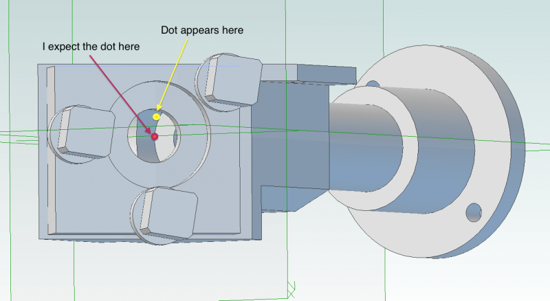

Oops, sorry Marco, I should be more specific. I can add a photo later this evening when I get home.
The beam combiner has the tube/stand, which holds the red laser pointer, and the reflecting mirror assembly at the top.
I expect the red dot to be visible more or less at the center reflection mirror (regardless of the adjustment of the mirror).
I've marked up my CAD model, see the picture below:
I've noticed two things about the red laser that comes with the combiner:
- It is not focused as it comes from the factory.
- I can bring the beam into focus by turning the top of the unit.
If the beam is centered in the vertical tube, I would expect the red dot to be visible in roughly the center of the reflection mirror. That would be ideal since it would also help for general laser alignment.
The combiner's mirror adjustments would be used to get it to the center of the next mirror (fixed reflection in my case).
In my question, I am talking about the beam combiner's red laser dot and its visibility on the beam combiner's reflection mirror.

Tech_Marco wrote:When you say "mirror" which mirror??? First mirror, second or the last one? Or the mirror on the beam combiner...
Sorry to have not been clear before!
/Mitch.

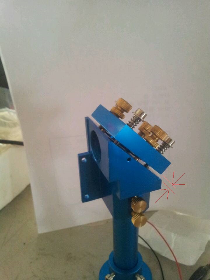

Re: Pro 25mm beam combiner red dot alignment
It is nothing wrong with the combiner. We tested it before making production. What you need to do is to move the mirror/lens holder up for 2~3mm up but not totally secured it down to the mount
See pictures attached. It is very simple to do and you will get perfect center hit on the mirror
Also, the laser pointer focus point is adjustable. If it shoot at the side way, just turn the pointer either left or right then by adjusting the gap level, you will get the center dot

I never said anything was wrong with the combiner - I just want to know how to adjust it properly.Tech_Marco wrote:It is nothing wrong with the combiner. We tested it before making production. What you need to do is to move the mirror/lens holder up for 2~3mm up but not totally secured it down to the mount
(although, there actually _is_ something wrong with mine, but it's an easy fix. One of the silver M4 screws with the spring underneath is badly bent. I have plenty of screws to replace it).
Yes, I see that, and my mirror is mounted with a consistent gap from the body. I will measure it to 2mm.See pictures attached. It is very simple to do and you will get perfect center hit on the mirror

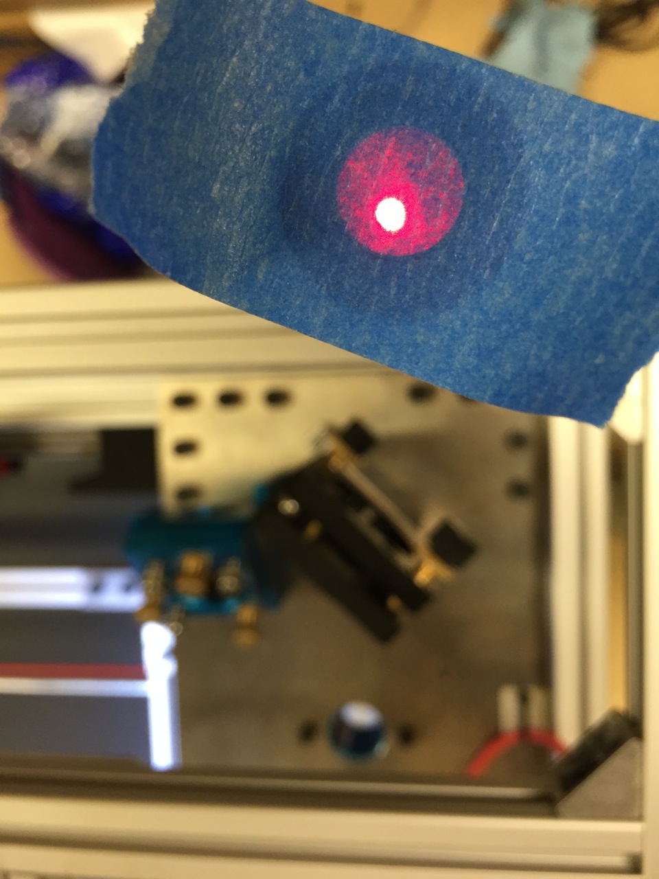

Funny you should mention that technique - that's *exactly* what I was doing last night, though I was less than a meter away.
I removed the #1 mirror and placed a target about "far" away (it was probably less than a meter).
I also constructed another target that I can place 2cm from the output of the beam combiner.
First step: with the *close* target, I turn the red dot on and fire the laser. I adjust the laser tube itself such that the red dot is centered in the burn mark from the CO2.
Next step: I remove the "close" target and fire the laser at the "far" target. This time I adjust the mirror in the combiner such that the red dot is exactly in the center of the burn mark.
Repeat a couple more times to make sure near far have their red dots centered on the CO2 mark.
Theoretically, this means the two beams are co-linear. Now I can replace the #1 mirror and use the red dot to get everything aligned.
I believe what I just described is your exact suggestion to me, so that tells me I'm on the right track!
