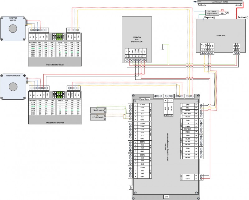

Hello Everybody,
I just purchased DSP with all other parts that Marco suggested to purchase in K40 conversion manual. The old wiring schematic is not accurate,it's showing different stepping motors and does not show the power to X-microstep driver . I need to see how 2 x ECNC-2M415 stepping motor drivers are connected . On page 27 in conversion manual (k40 > dsp) in reference of X-motor driver it said: "" the Red and Black cables on the left power (DC12~36V) the motor controller." What is the motor control? is it another part I need to buy? Y-stepping motor driver has two black wire coming to the ground to the left plug...Where they coming from? I tried to look in to different pictures on this forum, but I could not find it.
It is very nice conversion manual, but with out wiring diagram it's very hard to convert it. Please help. :?:

Sorry to reply late. Busy doing warehouse planning.
See attached image of the wiring diagram. I'm trying to find you a connection diagram for the 2M415 but I just couldn't remember where I put it. Just hand on there and I'll get you the image
