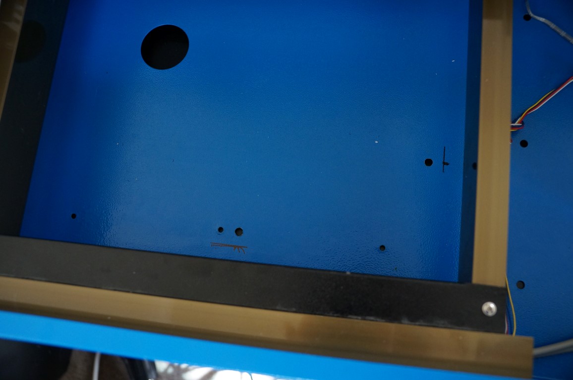

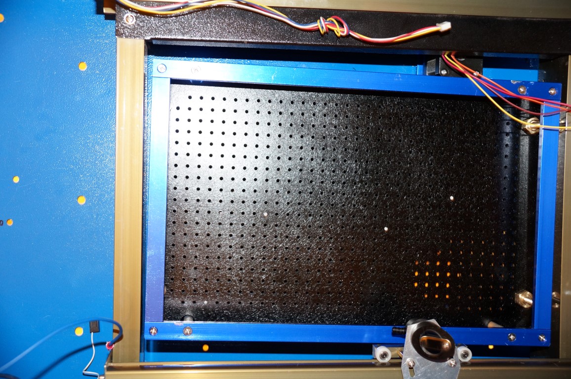

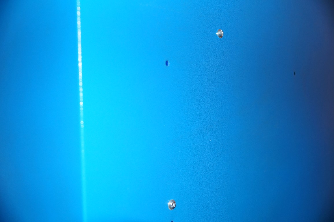

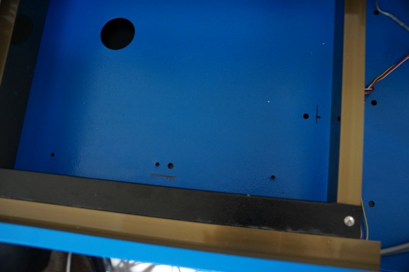

Now, for the physical part. First I noted on the bottom of the table frame that there were several tapped holes. One is an M3 but the others are all M4. Then I set the table inside the gantry and positioned it where I wanted it. Next I took a Sharpie and marked along the 2 edges I could get to on the case. I also eyeballed the holes and marked where they were along the line I just drew. I removed the table and measured with calipers how far in from the edge (that I'd just located and marked) the centers were. I locked the caliper for each one, positioned them by their corresponding marks on the case and used the pointy part of the caliper jaws to scratch a mark in the case. I center-punched the scratch and the drilled a hole. I made mine 3/16" to give me a little clearance (just make sure the hole is smaller than your washers!). Then I put the table in and bolted it in. I left it a little loose so I could line it up parallel to the X-Y gantry.
The attached photos show:
Holes marked (I'd already drilled at this point)
Bolted in from the bottom with M4 bolts and a washer
Mounted in case (I took this shot before I lined it up - the holes had enough wiggle room to line it up correctly)
