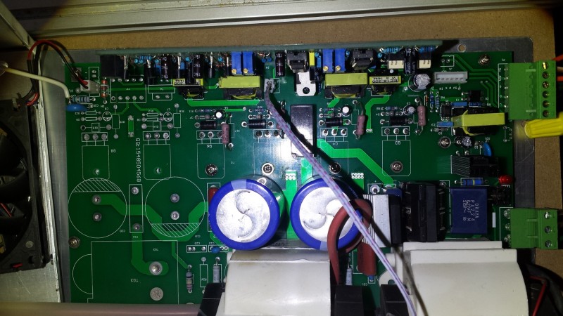

I opened the LPSU, the internal 6.3A fuse is not blown and I do not see any obvious shorts or burns.

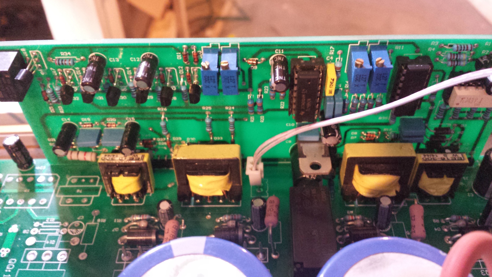

Since you already opened the case, take a picture of the main board an post it here. I may be able to do some troubleshooting
