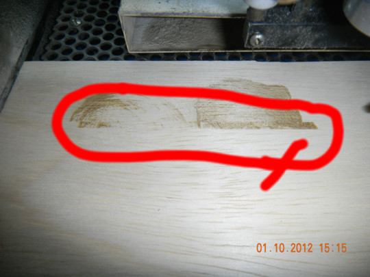

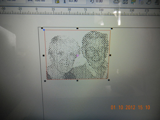

Hi all,
I need help from some people to verify if it is just my LCD panel from the 2012 DSP what create A JUMP when I change the setting speed and / or power.
the situation is the following :
I download a job from lasercut 5.83 to the machine and start then I realize that the settings does not bring what I expected .
then I hit the pause start botton on the display and change the setting to what I think is right and hit the start botton again and there the laser starts further right then where it stop
I could not attached the file " LCD test1" as a sample for someone to try because the extension PWJ5 is not allowed why is this not allowed it is the the extension for the lasercut 5.83 it would make it much easier for tresting and comparison.
so I have attached a picture how the picture looks at the lasercut what is used it is a normal 8bit greyscale picture and dithered in lasercut . I also attached the picture how the result looks.

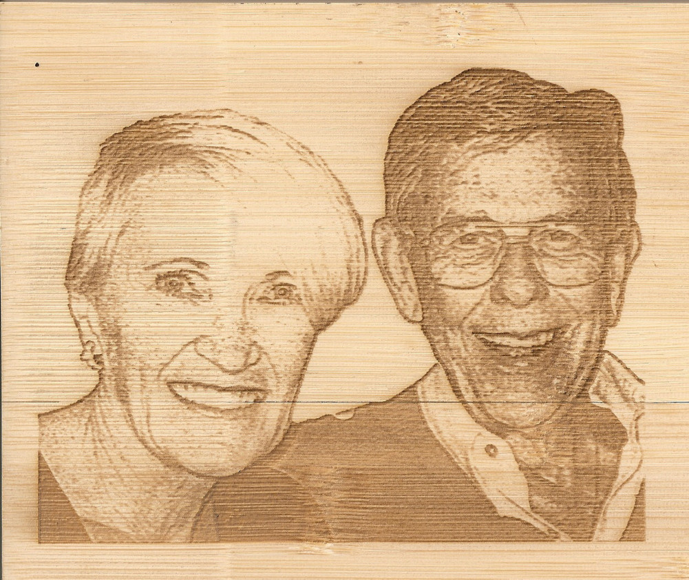

Hi
here is the lasered picture done without changing the settings on the LCD panel.
speed = 300
power = 8% ( 3mA)
scan gap = 0.06
dithering in LC 5.83 = 0.2
speed = 300
power = 8% ( 3mA)
scan gap = 0.06
