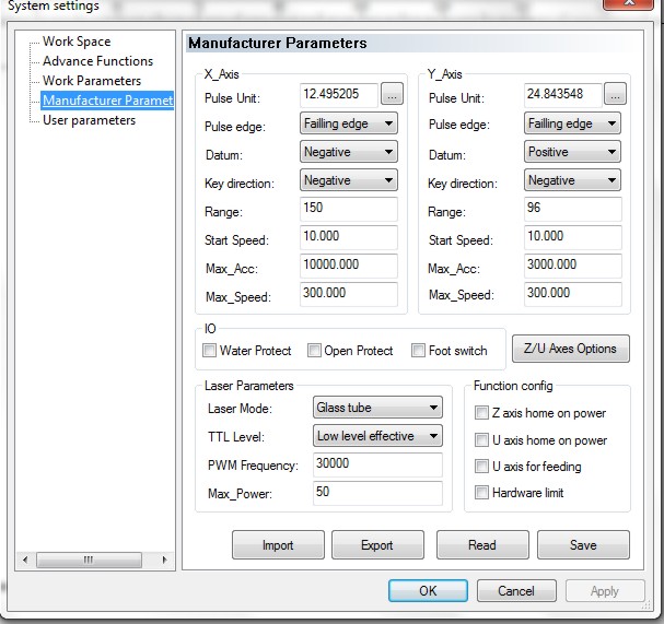

after the square is lasered take the measurments exact what was coming out, go back to the manufacturer settings click the ... botton to the right on the "pulse unit" X this opens a new screen there you got the top window with "expectet" you put the measurment in which you have drawn the square ( 50) and undernice in the window "actual lenght mm" you put your measured length of X in and click ok
the same you have to do with the Y pulse unit. then you hit the OK botton in the system settings screen
everytime you make changes you must close the lasercut programm thats the only way that the setting will stay in the programm.

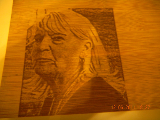

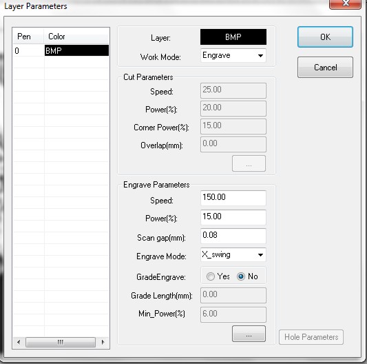

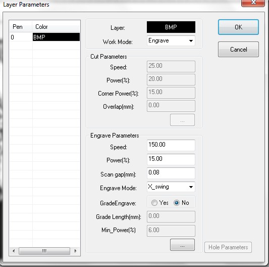

now I have done my first few engavings of pictures
here are a picture and the setting for it
greetings walt
