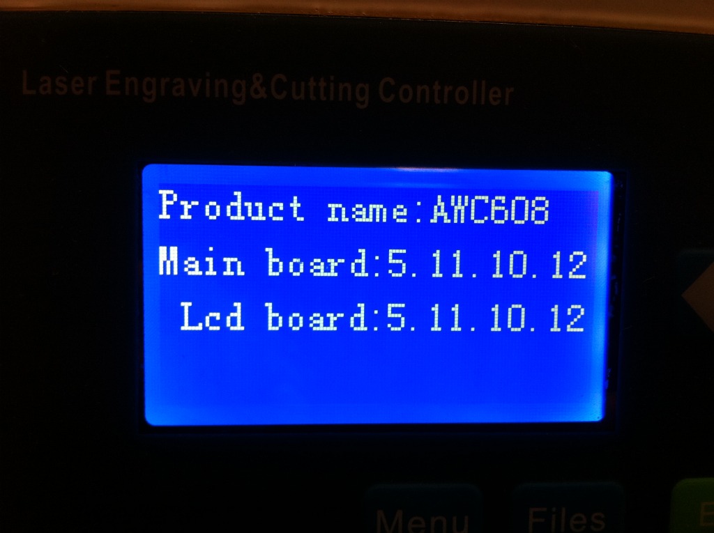

As for the menu check the system information option.
I display the following on it:
Product Name: AWC608
Main Board: 5.11.10.30
LCd Board: 5.11.10.30
Check to see if yours is a different version.

When did you purchase it? Is there a RJ45 network connector on the DSP board?
Only the 1st 10 board from the 1st shipment didn't come with network support. All cards shipped after should have the network card ready. I'll send your image to the programmer see if it's software issue. If so, it should be able to fixed easy by running a upgrade patch on the card

I purchased this from your ebay store (lightobjects) on October 18th and I receive it on October the 24th.Also I don't remember have seen the RJ45 connector in this board. I probably received one of the fist 10 boards
