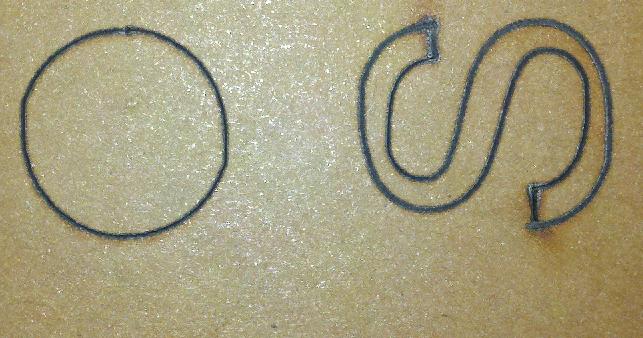

So I am having a heck of a time with the curves. They are horrible to put it mildly. I ran this file at 30mm per sec. I have checked to make sure of all of my pulleys are tightened uo. It is kind of a bigger machine with approx 4 feet x 5 feet with xl belts and pulleys. I also have the laser mounted on the gantry. Even when I run the machine at 5mm per second it produces the same results. Especially on the Circle it looks like it is cutting then juts up at the top of the circle and then continues. I was wondering if there are any settings I may be missing, etc. I am have 3:1 reduction on Vexta 5 phase drives. 16 tooth drive pulleys. Any ideas??

So I ran the file 5 times in a row and it went exactly to the same place everytime. So I guess it's not losing steps. The "S" and the circle are about .75 to 1.00 inches. Maybe it's binding somewhere??? I moved it to different portions of the table too, but still the same. Oh this is a bit frustrating... The straight lines and diagonal lines are great, so I guess that's a plus!! hahah

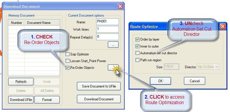

You should be able to stop it from doing the letters in pieces by setting the route optimization when downloading the image.
See image for instructions.
