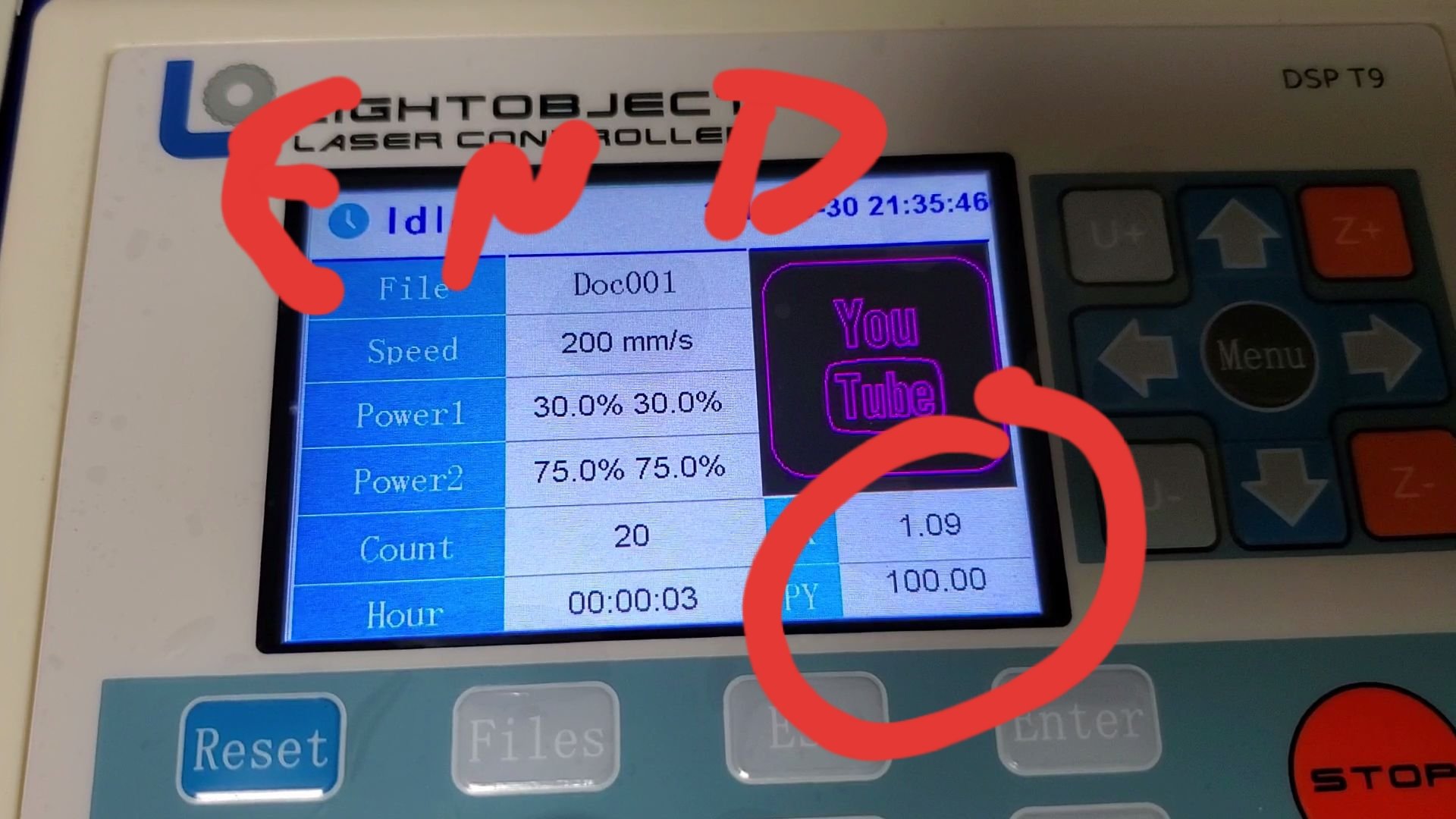

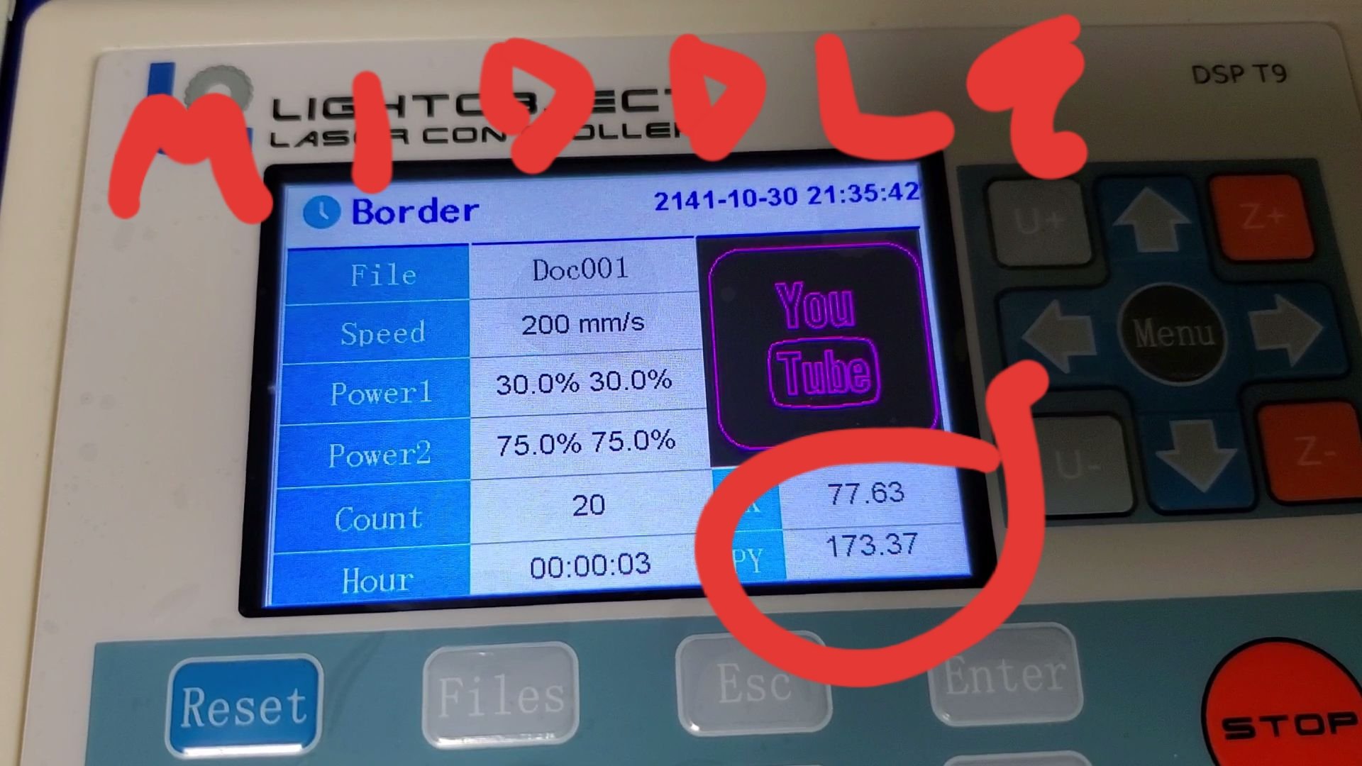

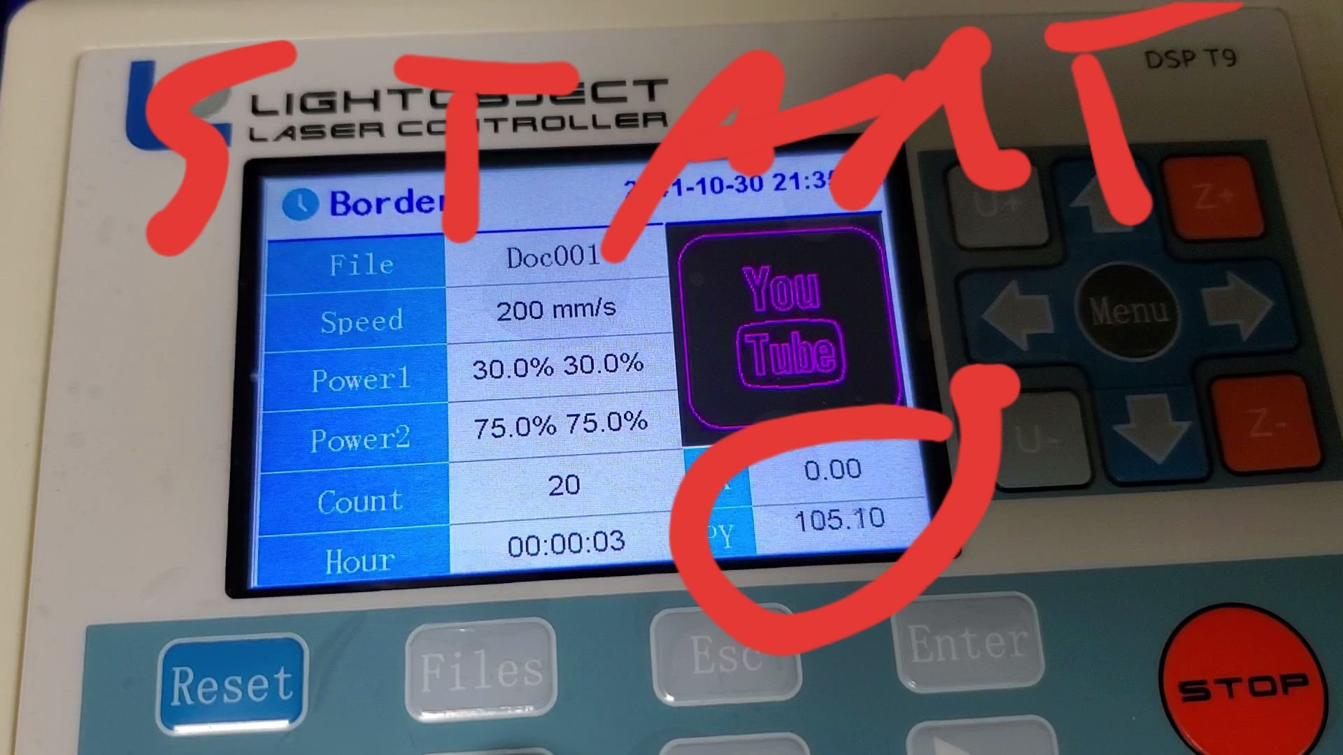

After firmware update done and parts reinstalled I started up the unit. It went to home position and stopped as it should. When I run the border the x-axis moves but the y-axis does not. The same thing when I push the play button on the dsp or run a file through lightsoft, x moves but not y. The dsp shows the x and y axis both moving(x goes from 0 up to 80 then back to 0 but y jumps to 100 then shows movement to 180 and back to 100). I can move the x and y axis from the control pad on the dsp and from the lightsoft software using the arrow keys . I've tried swapping the drivers, checked all the wires and connections several times(unplugged and reconnected) and tried changing "um" but still no luck. Any thoughts or ideas?

The display starts with px and py at zero then ends back at zero. When running a file this is what shows on the screen. The x axis moves but the y axis does not. Both move with the keys on the display and in the lightsoft software.

X and y go to home every time no problem there. X and y move with lcd and through the software. Table size is set to 300x200. When testing with a box x moves and y does not. In the above pictures it shows that the y axis on lcd jumps to 100 then runs the distance and then runs back to 100. When it shows the box is done it all goes back to zero. Multimeter shows power out to driver when moving y axis with lcd or software but no power going to driver from the controller when running the file or border. Nothing in the faq has these symptoms. Tried different um values and still nothing.
