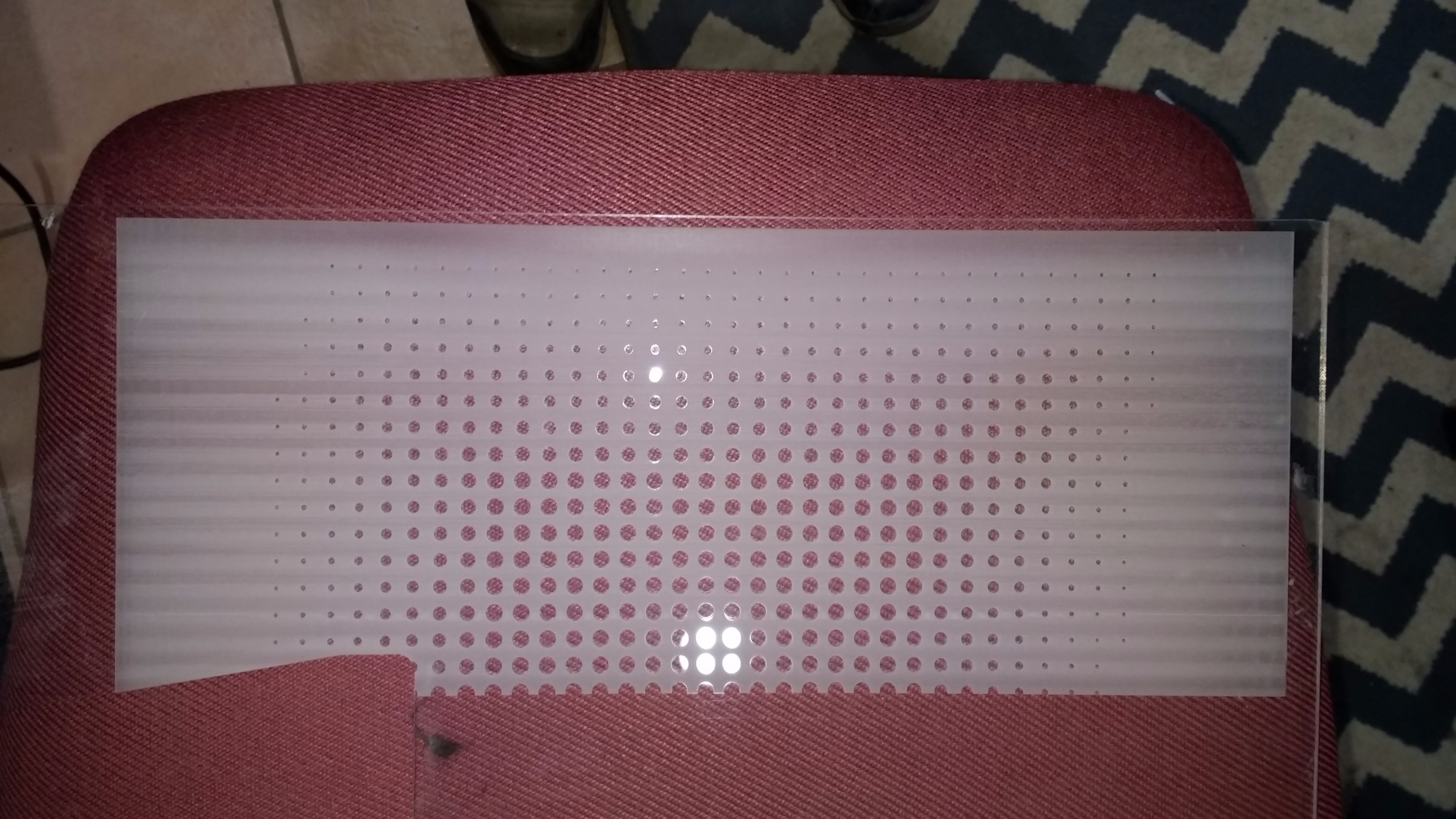

I am trying to engrave a large piece of acrylic which is mostly solid fill with dots here and there. The power level is the same for the whole piece.
I am getting "stripes" so to speak running left to right (X direction) that are maybe around 5-8mm wide in the Y direction. Every once in a while it will engrave a much deeper line for one and up to a few passes then settle down again (can't see in in this photo), but it still gives me the "change in power level" every few mm. Obviously it doesn't have to do with the closeness of the laser to the lens otherwise it would be changing in the other direction.
I'm thinking that my pwm frequency setting is too low. The question is; "what is the correct setting?" Does the power supply care or is there an optimum setting for each particular brand of power supply and if so where do you find the information?

I see some banding too (vertical stripes)..
The horizontal striping can be a instable tube.. I had that with an old dieing tube.. After i placed a new tube this problem was gone.
It can also be some interpolation effect when your scanlines are close to the step-resolution of your Y-stepper..

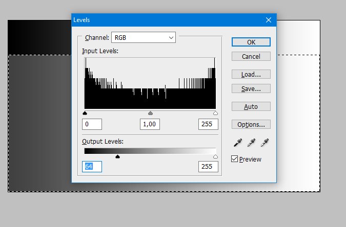

You might use the next trick to get a more equal surface:
Open your picture (with the dots) in Photoshop or a similar program. If you use a scangap of 0.08 (~316dpi) set the picture size to the right dimensions with a resolution of this 316 dpi. Adjust de levels from 0-255 to 64-255. convert to Black/white (1 bit) with a dithering you like (Floyd-steinberg for instance). Instead of an equal picture you will get a lot of dots.. The result, when lasered, will be a much more even surface.. Maybe even your horizontal stripes will be gone??
I tested about all PWM frequency's but i didn't experienced any difference at all.. All engraved parts where exactly the same crips and equal..

In Photoshop this is called "levels" and looks like this: What do you see there? I filled a plane with a black to white gradiënt, selected the lower part and made 100% black a kid of gray (64/255)triumphstephen wrote: I just am not sure what the de levels are you referred to. Where do I find those settings?
As you can see the black isn't real black anymore..
When i convert this to gray-scale and to Bitmap with dithering you will see that the Black on the left side stays black but the adjusted level becomes a dotted pattern: In that way the laser has to start and stop every time at a more-or-less randomly frequency.. This will reduce vertical banding significantly..
