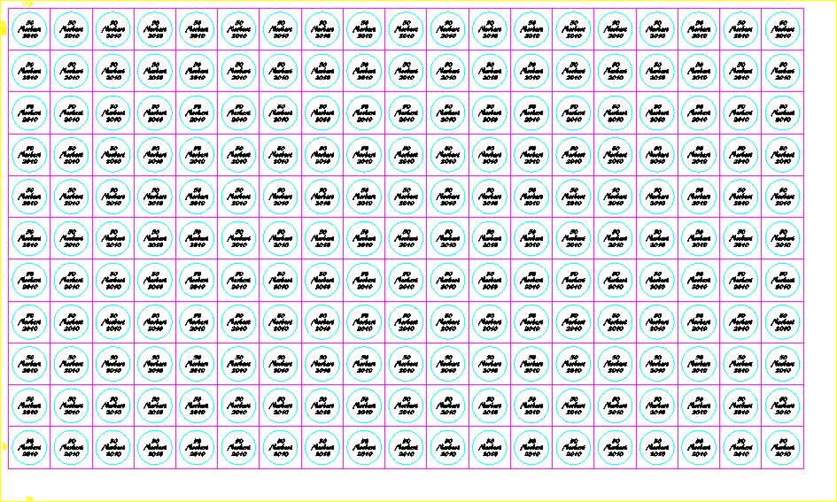

i got used to engrave choco-sweets like M&M´s and so on. So therefor I have a special part where I can put ca. 280 M&M´s in and i have to start the engravingbutton (Process) at my software to engrave all 280 M&M´s at on time.
I´made an schematic at Corel, put in only one time the Stuff i want to engrave and the start the VBA-Plug-In to fill out all the M&M-Places at my Board.
Now, since I have the new Mainboard / Card from lightobject.com I can not engrave the M&M´s because every time I start the process-Button ist start to say: "Processing..." and after a sertain time it says "drLsRun has not enough RAM.
I tried to engrave only one line, but it also does not work. Does anyone has an idea, what else I can do?

I used the corel-Draw to make the rows and the columns, becaus i cuttet tho board, where the M&M´s are in also with coreldraw. and i could use the corel-plug-in to engrave with all the data I created in corel. than i can also mix the different pichtures for engraving, when i want to make laike 200 different names, I don´t havt to wirte they all seperated, I can use a VBA in vorel to organice all the m&m´s. attached you can find the corel-file.
Black is the engraving
Yellow is the frame, that it fits in the Board with the holes.
Cyan is the cuttingway for the m&m´s.
Magenta is the row-direction for the seperated quaters / fields.
When i export the file as an AI or EPS at Corel and import it at RLaserCut it will work.
Thanks for the help.

OK, I tried your file and got essentially the same results as you did - not enough memory to handle the job.
I tried reducing the complexity of the job, but even removing all but one set (ellipse, rectangle, words) it was still trying to process something that is the size of the whole page.
I took one set, put in a new document, and replicated it. I noticed that as I copied and pasted, everything get pasted as groups. Copying several and pasting made even bigger groups, etc. Grouping adds a lot of complexity to the final output.
I removed all grouping from my file and tried - everything works perfectly. I did not get time to test the same on your file. I suggest you remove all grouping from your file and try again. Or you can use my file (see below) as a starting point and rebuild your setup. Either way, it is a bit of work to get set up, but I am confident the controller will handle your job once it is simplified.

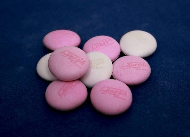

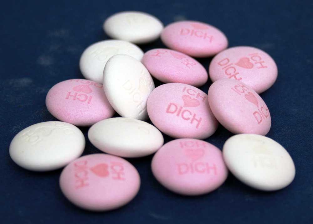

I have a laser with 50 Watt and I engrave the candys normaly with following settings:
Power1: 60 %
Power2: 65%
Speed: it depends on the deepnes I want: between 20 and 25 m/minute.
Attached you can find a foto of engraved Candys, but you don´t see it so good on a picture as in real.
Greetings.
