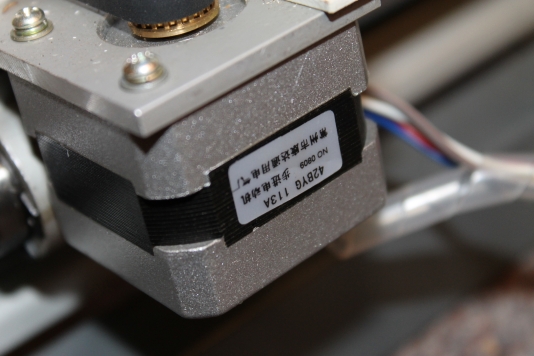

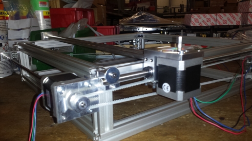

I rip of the hole X-Y-Stage. Because i dont like it and there is not really much space to make big cuts! The motors are not really big. So i cant drive high speed on engraving.
The small motors:

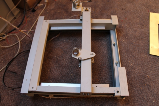

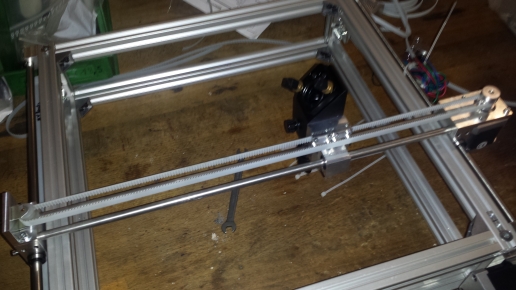

After ripping everything out i need to do a better construction. I have the option to use a machining park with milling and turning machines. So i make a new construction for the X-Y Stage.

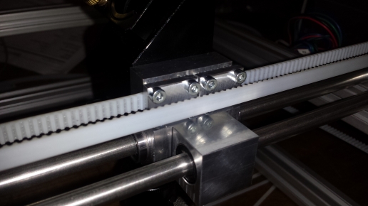

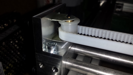

It takes about a week and i have a good construction. For the hole construction i use the constructionprofiles which marco uses for his selfbuild laser-cutters. Milling all the parts takes about 2 weeks. Everyday after work i finish 1-2 parts and build them slowly together.
Here is the result:
With my new X-Y-Stage i can cut in X300mm and in Y270mm. I have to do some more improvements.

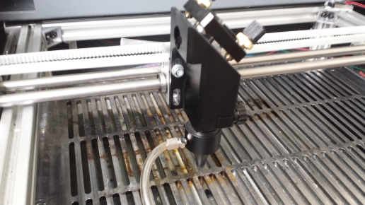

I need a new laser-head. The old one is without air-support. I bought a new one at lightobject with air-support.

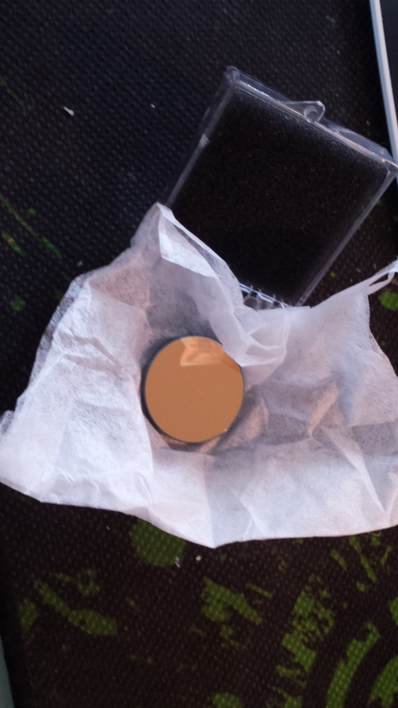

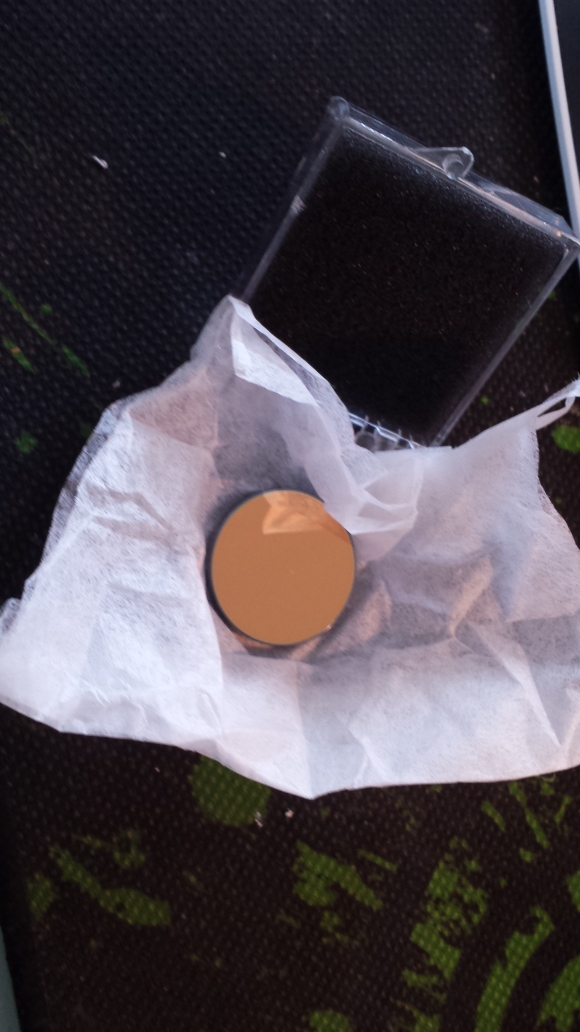

In addition i need new mirrors. So there are new ones. I bought the gold-plated from lightobject. They come in a great packaging and really fast.
I live an europe and every order takes about 10-20days. And i never have any problems!

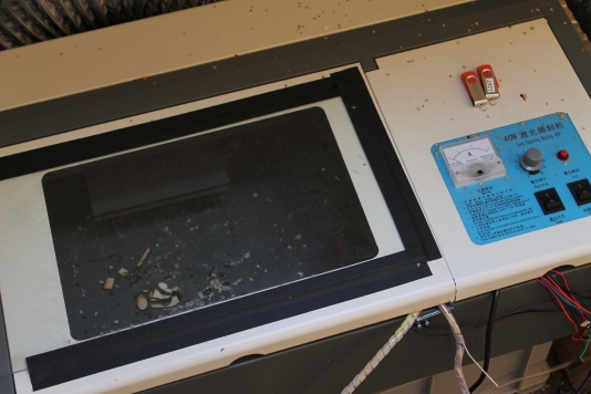

Okay now it looks like this. I cut of the housing at the front side. Because i want to open it for bigger parts!
The new mirror:
The new laserhead:

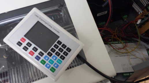

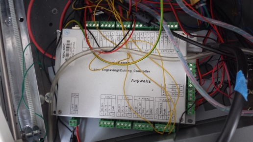

The new laser-controller:

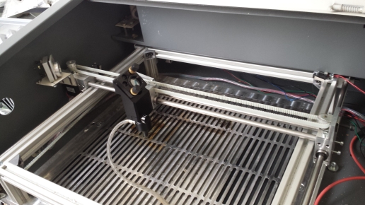

At the moment the machine looks like this:

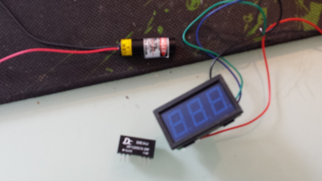

I have to do some other improvements. I bought the ampere-meter and a reddot laser. The ampere-meter i will use to check out how much power my laser have.
The reddot laser is for position the parts and setting my focus. I find a nice way to check my focus with it. I will post it later.
