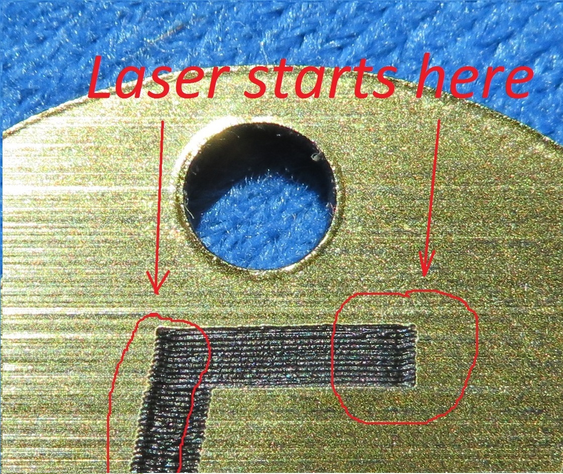

During engraving, the laser beam starts with normal power, after 1mm from the path of the laser, the power of the laser decrease with 30%, and keep it like that to the end of the path.
The result its very ugly.
These 30% its enough to material to not be engraved.
If i increse the power of the laser, there will be a deepest area when the laser starts.
For cutting, all of my setting i need to increase with 30% to cut successfully.
Please help!!

my maximum speed it's 500mm/s. , but thank you, i will try.
These result it's with 500mm/s speed.
