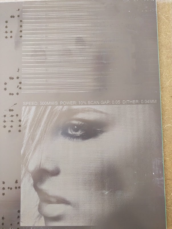

Marco here is an example of what it does
The bottom part completed at 500MM/s 10% power and a 0.05 scan gap. The top image is the same settings only changed power to 20% and it started skipping lines like crazy. Hope this helps with understanding what the issue might be. It seems to be speed / power related.
Larry
Larry

I downloaded the Ninja pictures and tested it on 500mm/s and 1000mm/s with my 60W laser and has the power setting set at 50% and 60%, it came up fine
I don't think it is DSP issue but something else. The most suspicious cause is the interference from the LPSU. Double check the grounding and avoid too closed distance between the HV cable to the signal wires

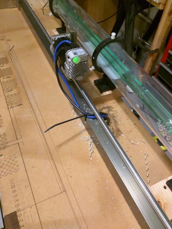

I was able to figure out the issue. I am using clear path servos from Teknic.com. I moved the ground for the servo to the output port on the DSP and the problem went away. The DSP does not provide dedicated ground outputs for the Step an direction ports so I was using one of the laser output ports to ground the Step signal.
Thanks for your help. This was a tough issue glad it's fixed.

Great to know that your problem got fixed. I'm hopefully if you can post the connection of servo as I believe that it is not singular case. Many folks are using servo and I never used servo motor or drivers. Your input is greatly important and appreciated
