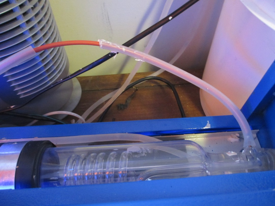

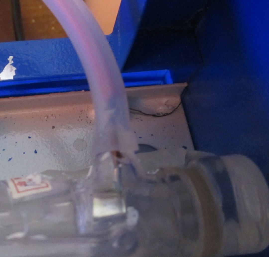

I just got my upgrade hardware installed on my K40 and everything seems to be working well except that I can't track down where I'm leaking voltage at. Somewhere I'm losing power between the laser PSU and the tube itself that's causing the laser to not only cut more weakly but is causing a charge to build up on the machine.
I've grounded everything I can think to ground: the plug, the chassis, the PSU case, and the case of the DSP controller, plus obviously all the ground terminals on the hardware. I even have a redundant ground line set up from the screw on the chassis to the ground of the wall plug.
For my red laser cable from the PSU I twisted it together with the laser cable itself, then double-sealed in shrink wrap, and stuffed the whole thing into vinyl tubing then capped with silicone.
I also turned off all the lights and watched to see if I could visibly detect a discharge, but no such luck.
At first I thought maybe my ground wires were too thin or I had a weak ground, but my tube is most definitely not cutting as strong as it was prior to this issue arising. Which to me suggests that I'm actively losing current rather than merely collecting ambient static, which would not be fixed by grounding directly to a metal stake or using thicker gauge wire.
I'm largely out of ideas, please help!

I re-wried the laser tube several times, using several different sealing techniques, moved the wires all around and far away from each other, re-zip tied the wires both positive and negative to the laser tube, arranging them away from each other, checked the ground on the laser PSU, checked the other grounds as well, did multiple corona tests, and now the problem is....worse.
What else can I even do?!? The laser's completely unusable until I figure out how to fix this. Right now I can't even fire the test-laser button.

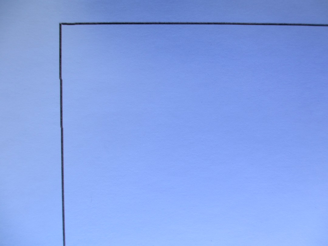

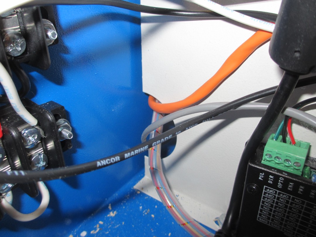

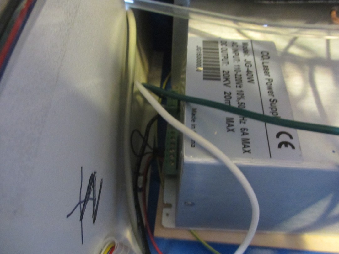

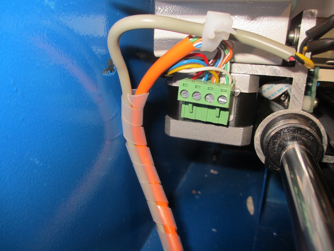

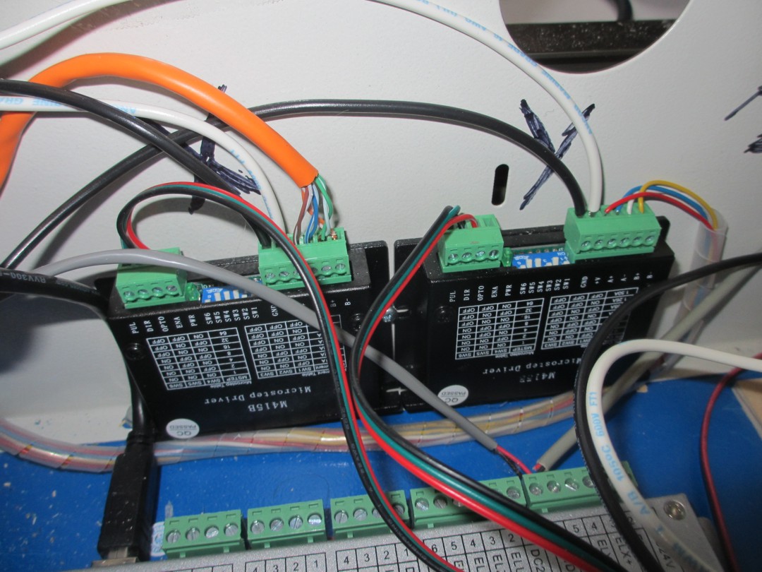

After some more digging and talking with Marco, I discovered my LPSU was set to 220V rather than 110V and there was a crack in the silicone seal at the positive power input to the laser tube. But even after switching the LPSU to the proper voltage IN and re-connecting the power to the laser tube I'm still not getting proper performance from the machine.
At first I was only getting a maximum of 6 mA coming through the laser as measured by an analog ammeter, even when running at 80% from the software with PPI turned off. Now after making the changes to the voltage selection and reconnecting the laser, I'm able to get up to about 15 mA, but the laser does not seem to be performing correctly I'm getting tics from my stepper motors.

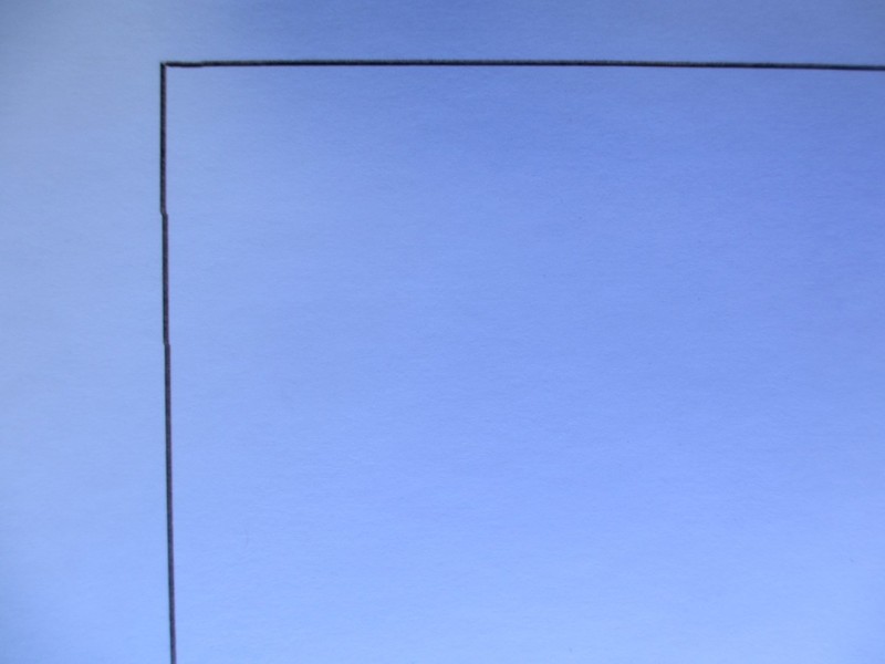

For example, even after aligning the optics, if I try to cut a square out of basic cardstock at 30 mm/s, 500 PPI, 50% power, it barely makes it through at all. If I engrave an image, even at 1000 PPI, 60% power, 200 mm/s I don't get a very dark and certainly not deep engraving. One of the pictures below shows the same image on a single-pass engraving. The left image is the 800 PPI, 60%, 200 mm/s. The image on the right is 500 PPI, 50% power, 300 mm/s.
But I'm also getting tics from my stepper motors where they jog one step when they're not supposed to. I included a photo below of what it looks like when they try to cut a rectangle. There is also sporadic resetting of the LCD.

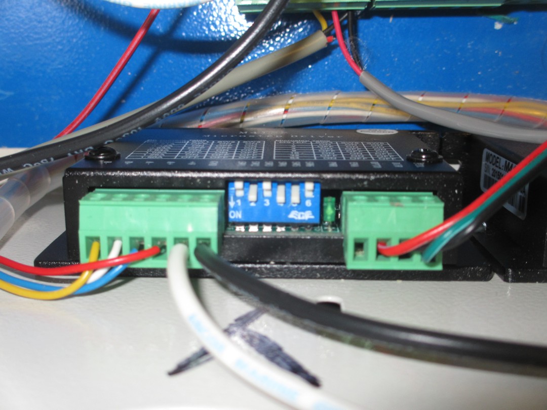

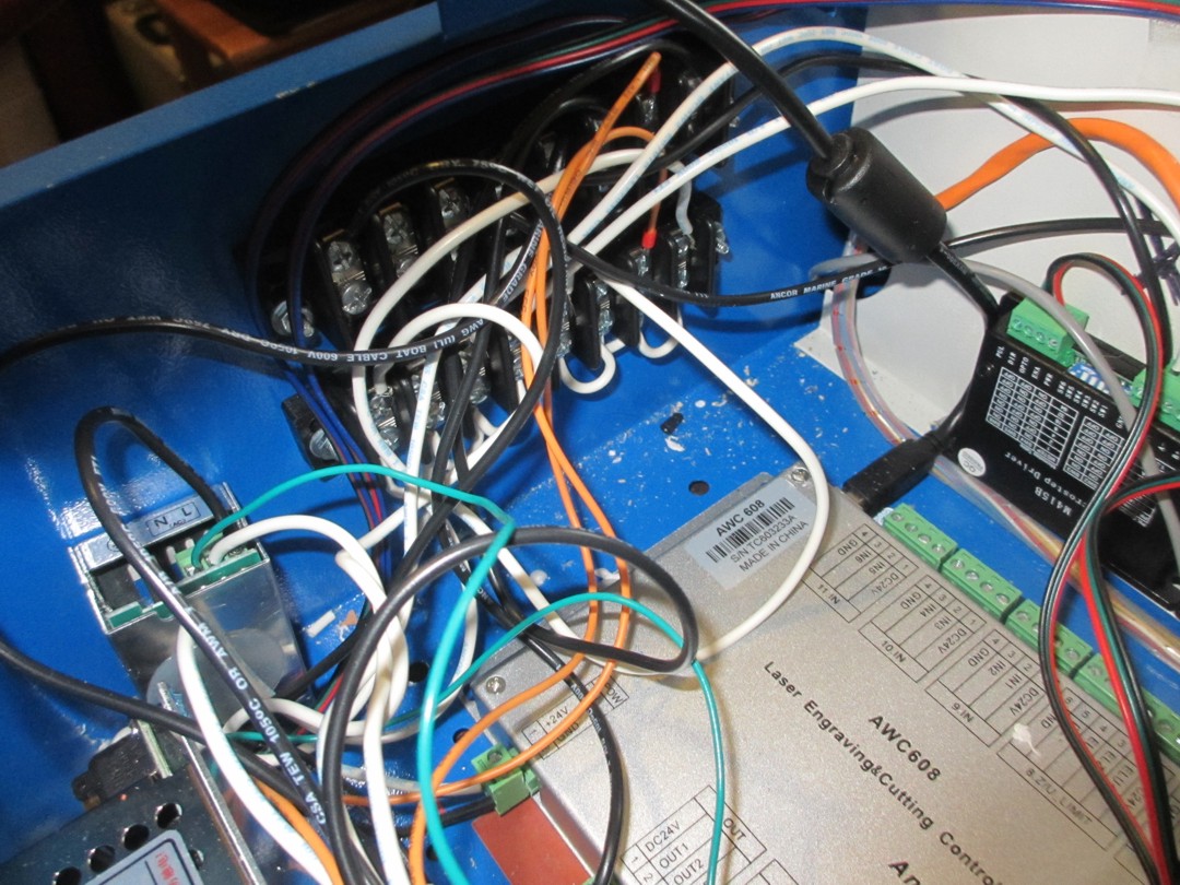

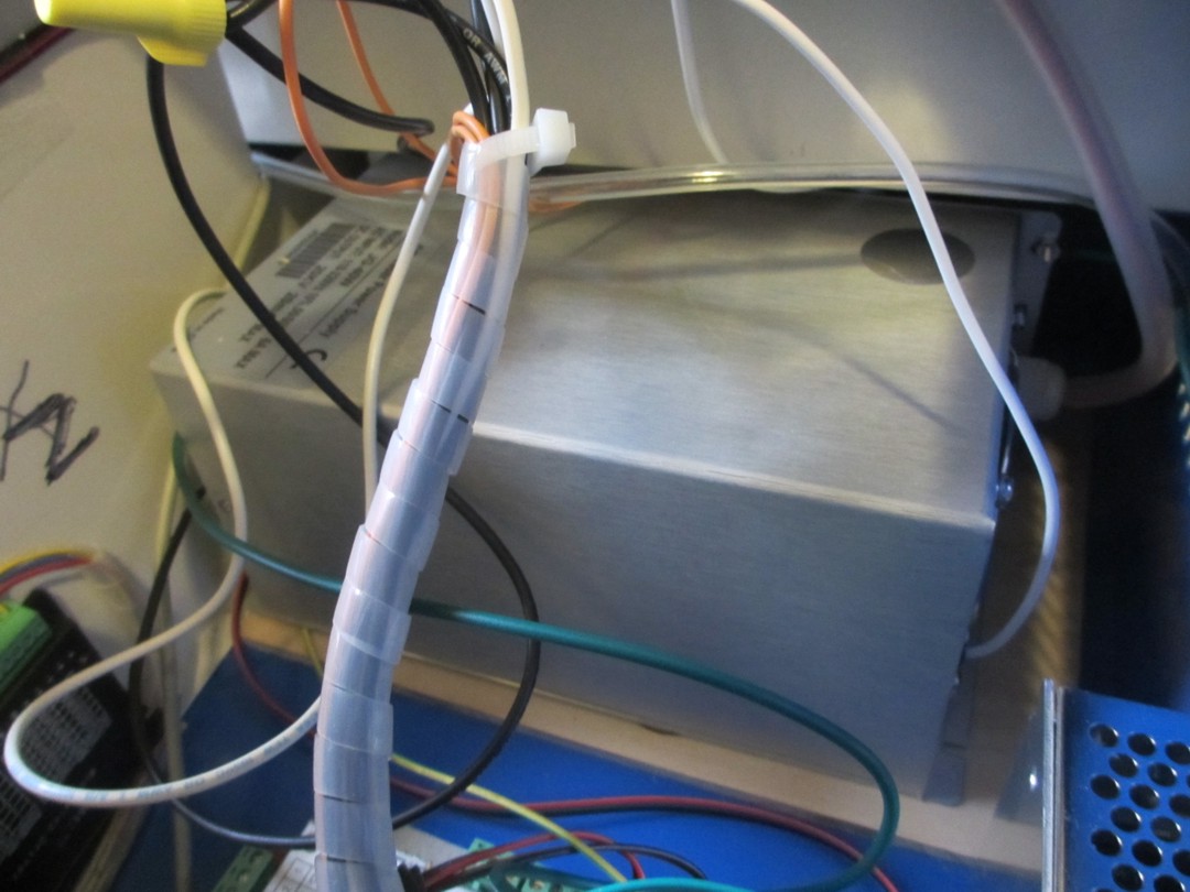

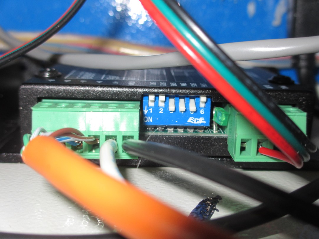

I also included photos of my general arrangement of wires inside the machine and how everything is connected. I followed the wiring diagram supplied in the forums, and didn't really improvise anything. The only exceptions are that I used RGB LED wire to connect the drivers to the DSP, and I included LED strip lighting inside the machine that runs on its own driver and is independent of machine power. Also, during the troubleshooting process, I added an additional ground line to the chassis of the DSP controller, and a separate isolated ground line from the chassis of the LPSU directly to copper piping with an additional layer of plywood separating the LPSU from the chassis of the machine. The LPSU is still grounded along with the rest of ground lines through its power-in adapter, so its not off the floating potential.

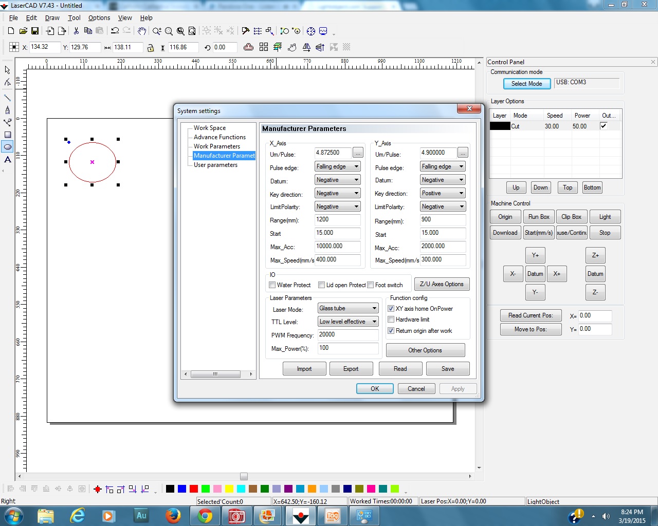

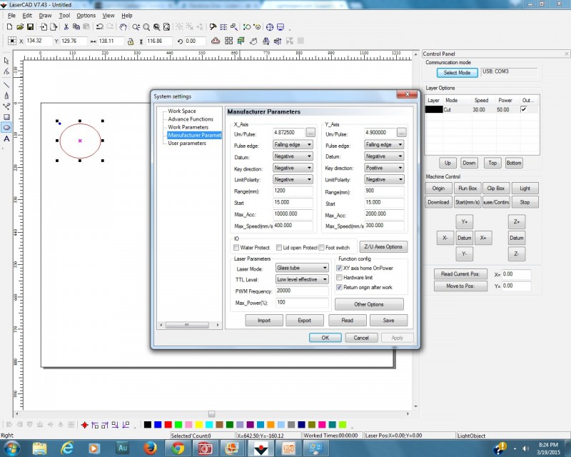

As I said, post your manufacturer parameters screen shot for review

Sorry, I missed the part about the manufacturers parameters. Its attached below now.

First thing: why you set the range to X:1200 and Y:900 ??
The workable of K40 is merely 340 x 220. So....
I saw that you set the motor driver to "16" which is fine. But for 16, I don't think that the 'um' is 4.87 or 4.9. It should be around 6.6 or 6.7 or around. (It has nothing to do with the resetting. I just curious)
Double check the AC plug installed on the K40. Pay a little attention that whether the "N" is connected to the case or not. In my previous experience, 99% (1% for system I didn't touch) machine made by "ShenHui" are having the "N" un-connected. Terrible tech issue there!

Make sure the HV (red cable) is short and state away from any signal wires. The electromagnetic field caused by the HV cable is strong enough to make your hands hair straight up (someone has mustache should try it too)

The area setting is 1200 x 900 because I never changed it after install. I wanted to get an exact measurement of the work area and I hadn't done that yet.
I'll re-run the um setting to see if it was done correctly.
Going by memory, I don't think the Neutral AC-in is connected to the ground on the machine. Based off your wording, I'm assuming that if its not, then it should be. I was wondering about the water as well. I've come across one other person who had static building up in their water, but I have yet to actually test for that.
A big part of my problem may be the HV line. I actually left the length of the wire coming from the LPSU uncut, so I will shorten that down as well.
Tomorrow I'll examine the AC in and post up some photos so I can make sure its wired up correctly. Last thing I want to do is directly charge the machine.

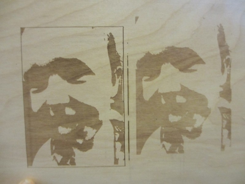

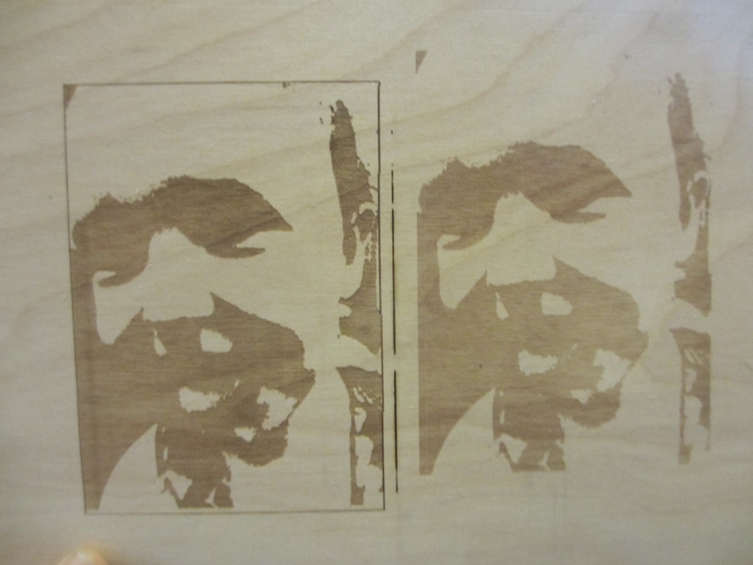

If you can, post the original picture from your previous engraving.
It looks not very good to me. It seems that it was over saturated.
You may import an .bmp or .jpg, then use the `Dither` function to make engraving better look

I'll have to upload the photo later, its on a different computer.
I grounded the water bucket and shortened the HV cord going to the laser, and that has fixed the LCD resetting and motor tics, but I'm still getting weak power out of the laser.
