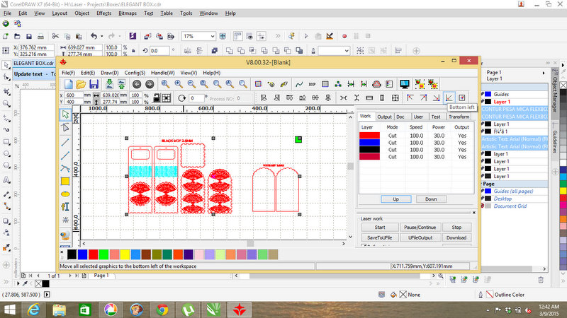

Greolt wrote: The only thing I will add is that I don't believe Ruida suppports CorelDraw X7 at this time. (Anywells does not either)
I installed their software on my PC (I don't have their controller), but it lauched RDworks within X7 using the plugin and transferred the drawing into RDworks
BrianJenkins
Posts: 17
Joined: Thu Feb 05, 2015 5:18 pm
Re: Advice for Laser Machine and Upgrades
Post by BrianJenkins »
Screenshot
Fullscreen capture 392015 124227 AM.jpg (129.06 KiB) Viewed 7209 times

That is good to hear. The manufacturers site says that it is only compatible up to X6
My daughter has a Gweike laser with the Ruida RDC6442G controller.
She is running CorelDraw X7 and has not been able to install or run the plugin. (I use X5 and had no such issue)
With this new information in hand, I now need to go over there and see if I can sort her out. :)

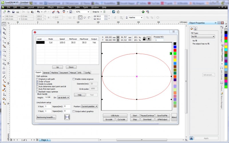

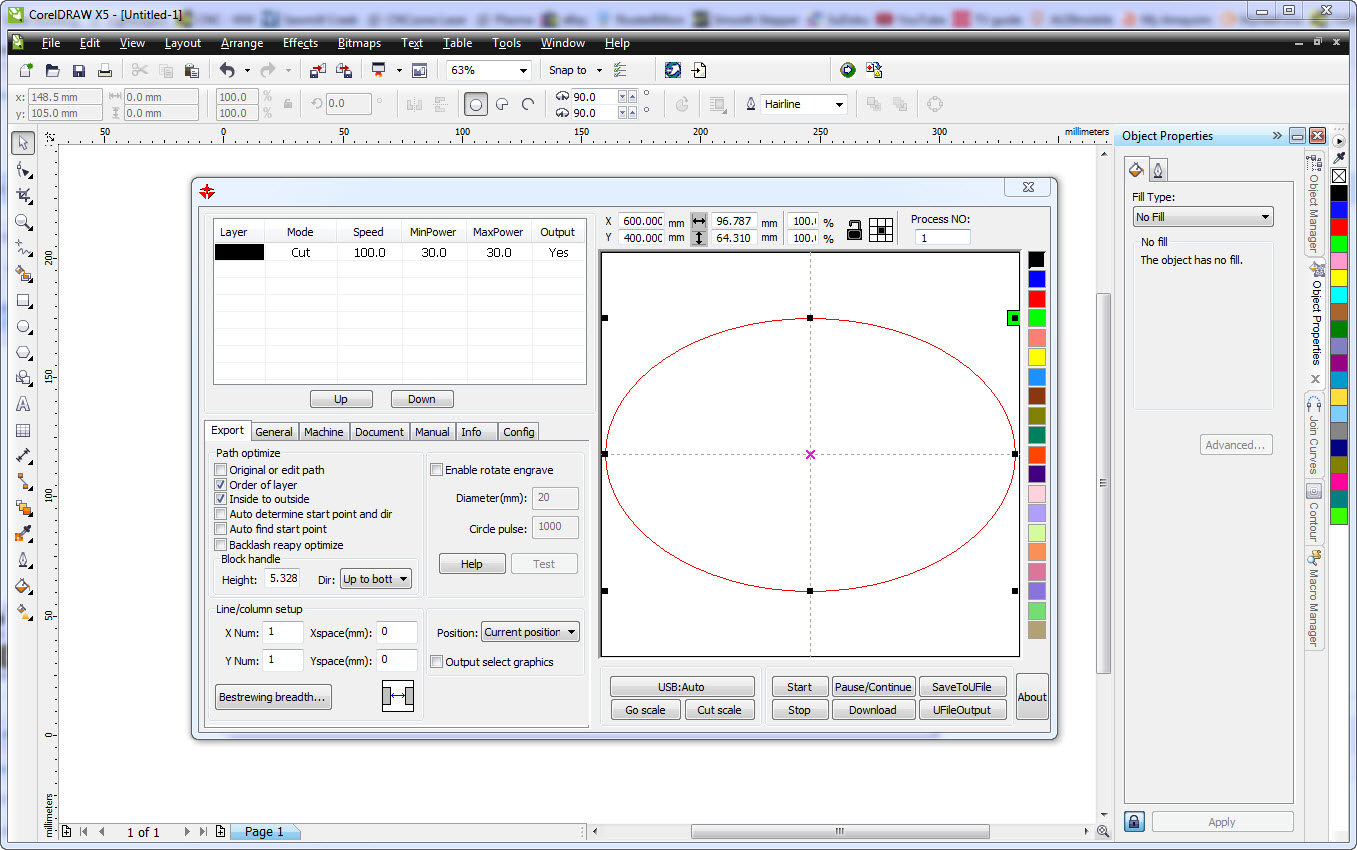

Post by Greolt »
Looking at this again,
I find that from within CorelDraw X5, the plugin looks very different than the pic you posted. I don't have x7 here to try.
This has me wondering if we are looking at different RDworks or some other difference.
The RDworks I have here is V8.00.28
Perhaps if we have more to discuss we should avoid taking over the OPs thread and start a new one.
EDIT:
Installed V 8.00.32
Still the same plugin window from within X5. Perhaps it is a completely rewritten plugin for X7
Your pic looks like the stand alone version rather than the plugin.
