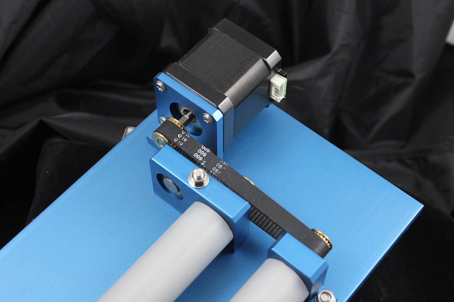

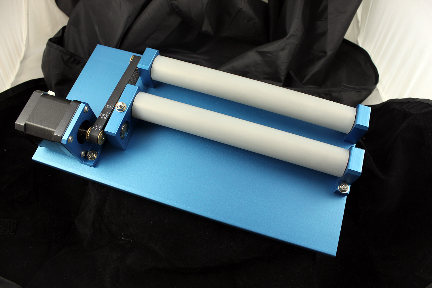

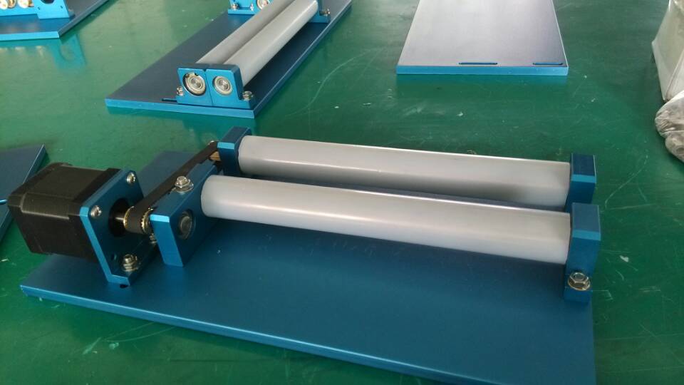

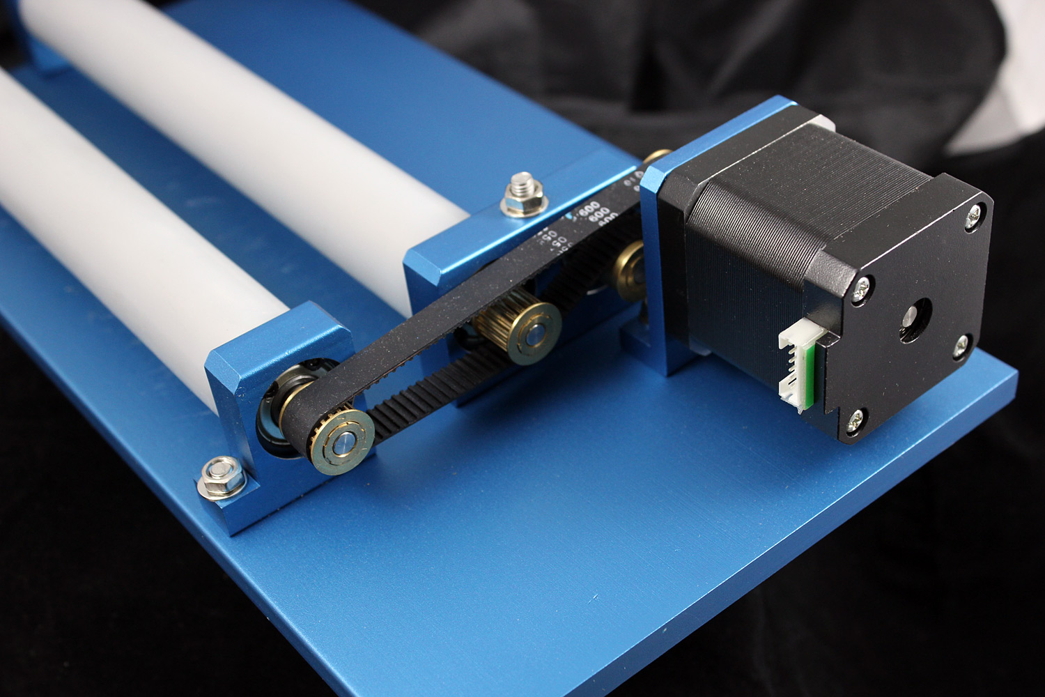

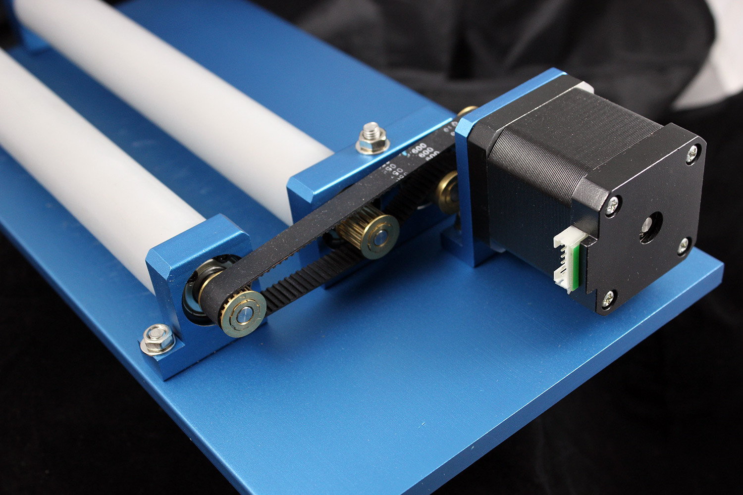

Redesigned a mini rotory for the mini K40 machine. Similar mechanism but with better materials and enhancement.
Instead of using aluminum, the two rolling rods are made of steel and has a silicon jacket wrapped. So that it will not cause any scratch on dedicated object like anodized aluminum, glass, or object with coating. The base board and other parts are made of aluminum. Motor is a higher torque EMOT-42HS03.

It should be available in two weeks. Production is closed to complete and I'll try to get 10 units to ship direct to us while the other will be shipped through ocean shipment

The motor that used on the rotary is 42 series with 1.5A so a M415 driver is good to be uaed.

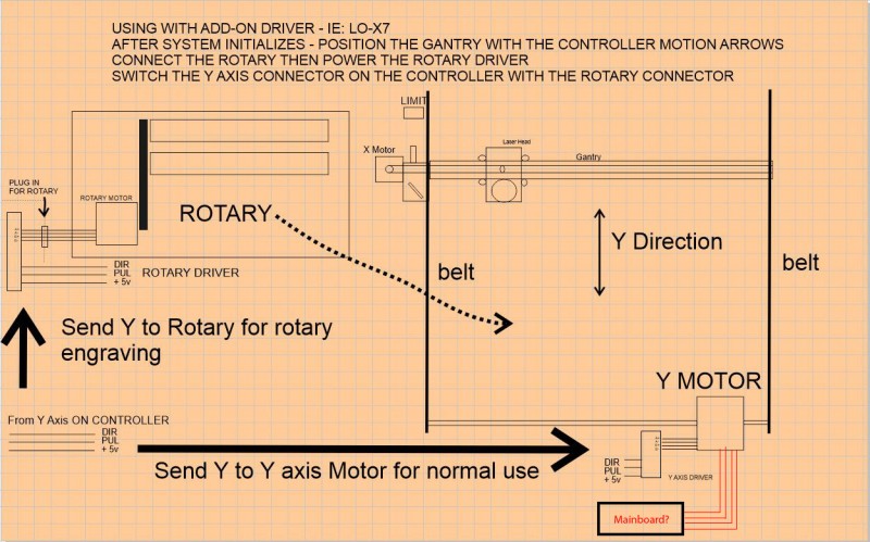

Will this fit inside the Z Table for the K40? Also I would assume I can control it with the X7 DSP and another Mini 2 Phase 1.5A 1-axis Stepping Motor Driver?

as I install my
Rotary unk40 with
DSP controller 608

Got mine in the mail today! what is the wiring procedure?

I can't find the wiring diagram for this motor, please advise.
EDIT: Do not purchase this mini rotary, the motor is wired incorrectly. Please refer to the Nema HS datasheet!

I can't see it very clear but it looks to have a 6-pole connector(?)
In that case it can be a unipolar motor.
But this type of motor can be connected as a bipolar type:
First find out which connectorpoints belong together. There are two sets of coils in it (A and B).
With a multimeter in Ohms you can measure a small resistance between the connectorpoints. The Connectorpoints that do conduct are from one coil.
In case of a unipolair motor you will measure a resistance between 3 points: two equal and one double. example:
between point 1 and 2 you measure 2.4Ohms, between 2 and 3 you measure 2.4Ohms and between 1 and 3 you measure 4.8Ohms.
In that case point 2 is the centretap of that coil. Leave that unconnected and connect point 1 to A+ of your drive and point 3 to A- of your drive.
Do the same for the other 3 pins but then connect it to the B+ an B- of your drive.
If the motor turns in the opposite direction, just swap the A+ and A- wire on your drive and the motor will turn in the right direction.
Select a current so that your motor will not turn too hot after half an hour.. Handwarm is fine. If it stays cold, you may increase the currentsetting for more torque. start with a relative low current, not to low else it will stall..
BTW the rotary looks very neat but i have my doubts for objects that are round but not cylindrical (like wineglasses, conical forms, flashlights, some bottles etc)
