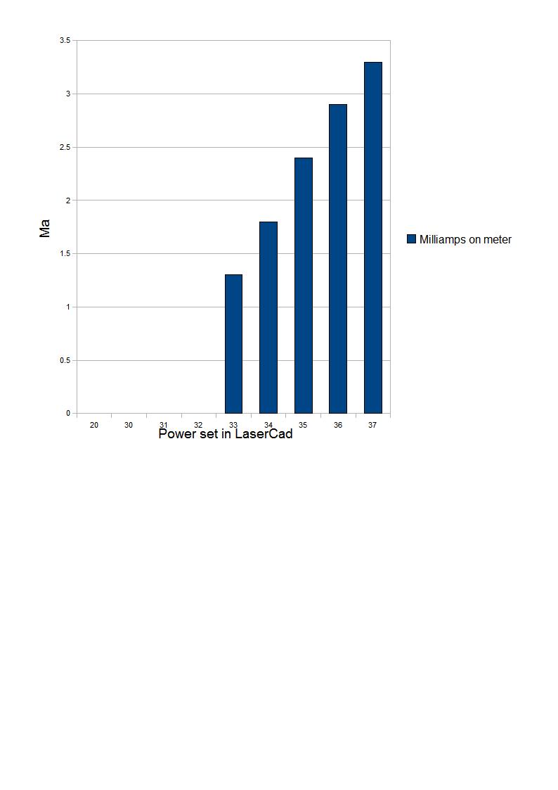

I just ran some tests using Lasercad. I drew a rectangle and set the line to cut.
Here are the results:
Power-------------Milliamps on meter
20-----------------0
30-----------------0
31-----------------0
32-----------------0
33-----------------1.3
34-----------------1.8
35-----------------2.4
36-----------------2.9
37-----------------3.3
I even graphed the results. It looks nice and linear from 33% onwards but below that it just falls off the cliff. Most strange!!!
- Posts: 4656
Re: Why can't I set my power level to less than 35%?
Then what is current when 100% is set?
Usually it is the power input issue on the PSU
But if you can get as low as 0mA and full output at 100%, I don't see a big deal. Just get used to it.
