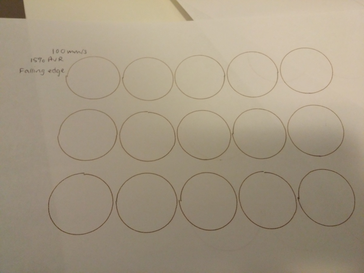

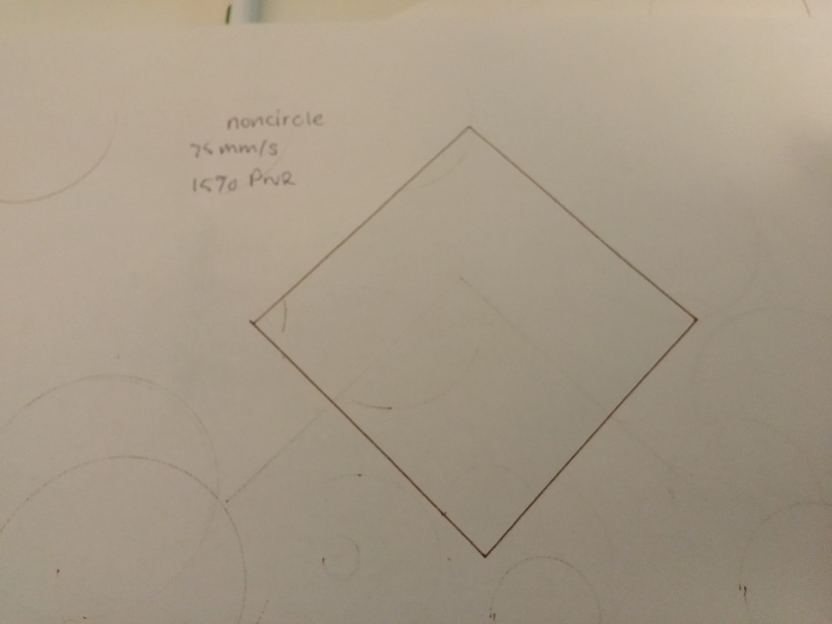

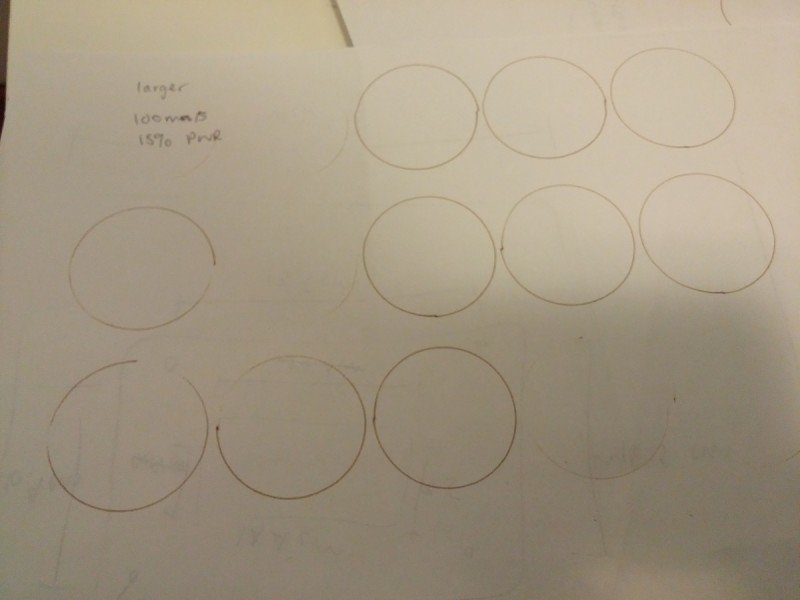

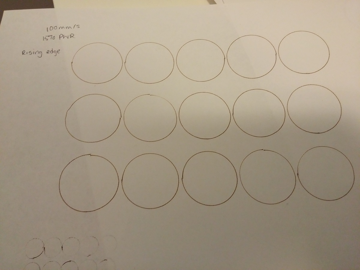

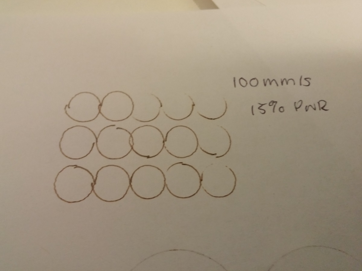

Just finished installing the AWC608 upgrade for the K40. When I tried to make cuts, however,I noticed that the endpoints did not connect--something more prominent when cutting circles. I tried searching the forum, but nothing seemed to quite match my problem.
So far I've tried adjusting the acceleration and speed, changing the edge settings, and changing the step length. None of that seems to have worked yet. Next step would be to check any mechanical issues causing this, as opposed to the software. Is there anything I'm missing?

Check to make sure that your belts are not loose. It looks like your issue might be backlash. My K40 has the ends align perfectly.
It also might be possible that you have some type of mechanical binding in your system causing you to skip some steps, but really looks more like backlash. With your laser powered up try moving the stage slightly with your hand and see if there is any noticible play.

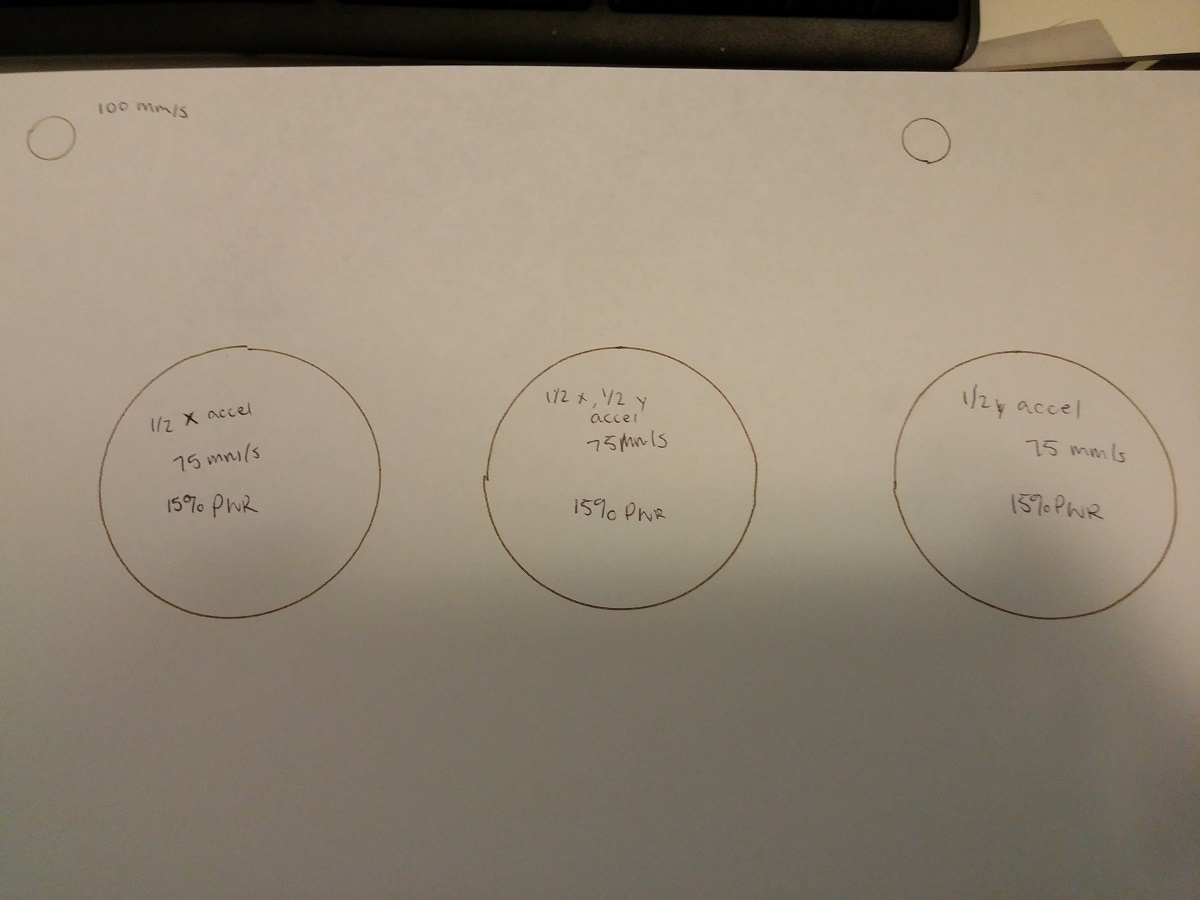

So far I've also tried playing with the step size, the current to the motors, and the resolution of the motors since Thursday.

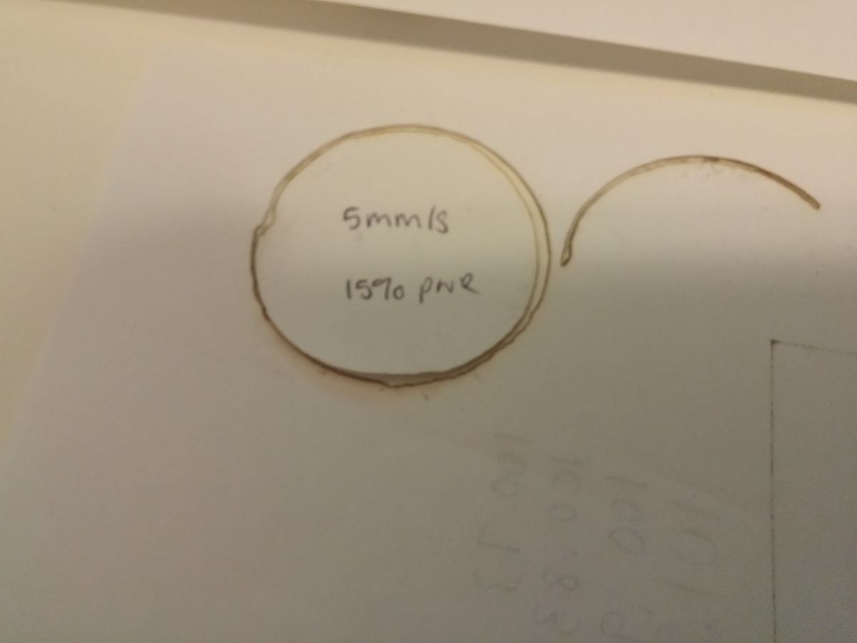

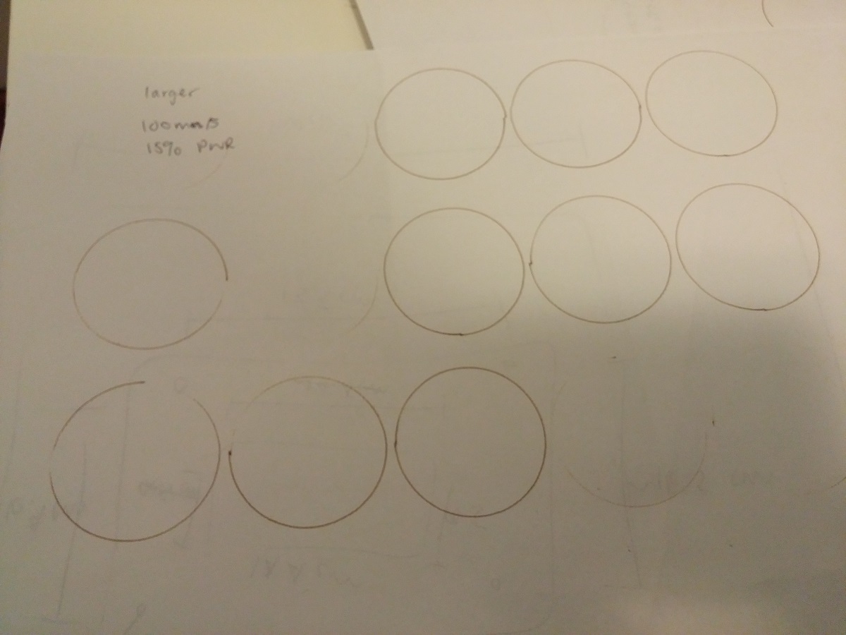

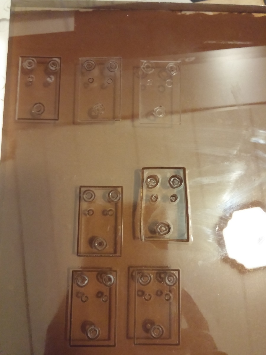

I attached a picture of some more tests. The particularly grotesque cut was done at a speed of 1mm/s; slightly less deep ones are 5 mm/s, then 15 mm/s then 45 mm/s.

Check your focus lens see if it got lose. If not, either your motor driver or motor may be in trouble
