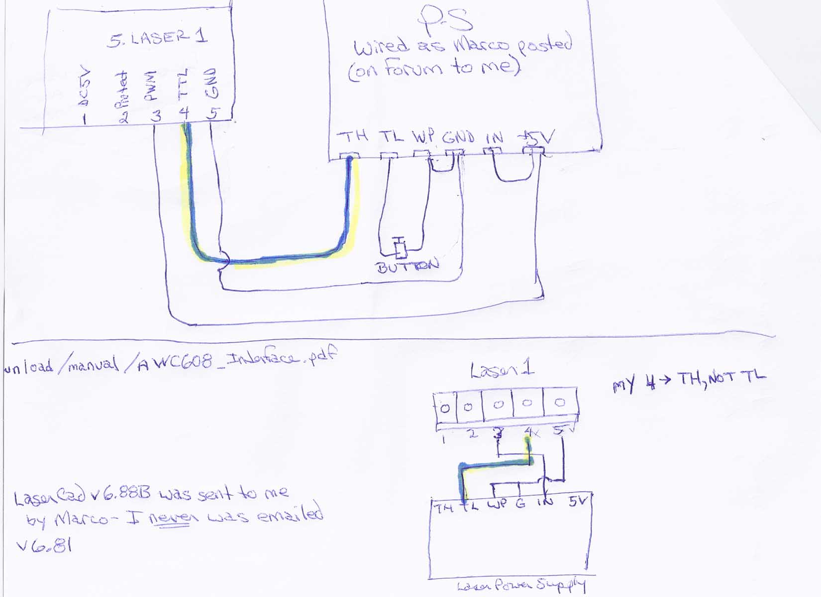

O.K I have Lasercad v6.88 running and can control the laser x and y using Lasercad but the laser is firing as soon as I turn the laser on. I have played around for hours now and can not find where or how to turn it off.
My analog meter reads 30Ma as soon as I turn laser on.

do you need to be more specific if you say "turn the laser on" you mean the machine or the laser?
do not turn it on if you meter reads more then 18mA because you will destroy the tube within minutes.
download lasercad v.6.81 not 6.88.
does your display button work that's what you should use to move the X and Y and also with the laser button fire the laser.
the laser ( beam) should never stay on on its own, maybe you have mixed up some wires or settings.
post picture from you machine wire connections
When Laser machine turned on,the laser is firing a laser beam
do not turn it on if you meter reads more then 18mA because you will destroy the tube within minutes.I changed a wire from the Power Supply which is shown on this threadhttp://www.lightobject.info/viewtopic.php?f=8&t=1458 and now when the Laser Machine is turned on with the laser beam still firing the meter now shows only around 14 mA
download lasercad v.6.81 not 6.88.The last email I received from Marco only had the 6.88 Lasercad and I figured that I should be using it,so that is what I am trying to setup. How do I get the v6.81?
does your display button work that's what you should use to move the X and Y and also with the laser button fire the laser.Yes. But I wanted to see if the Lasercad software was connecting to the Laser Machine.
the laser ( beam) should never stay on on its own, maybe you have mixed up some wires or settings.Yes, this is what I also suspect. I connected the Power Supply wiring according to this thread...viewtopic.php?f=8&t=1458 but as you can see from the attached diagram I am including is that TH on the P.S connects with #4 TTL on the DSP where it shows in the manual that the connection should be as shown in the lower diagram. I am not sure what changes I should make here.
I hope this all made sense.

To Wrench
I think I explained to you before that your connection was wrong. You don't want to connect +5V to the "In" as that is supposed to connect to the PWM output from the DSP controller. The connection diagram I sent you clearly showing the connection and `m wondering why didn't you follow it for the connection. Connecting+5v to the "In" will trigger the PS to fire in full power, dangerous
LaserCad 6.81 or 6.8i has nothing to do with your issue. You need to use TL instead of TH. Please review the connection and try it again. I'm worrying that you may damage the controller as you injected 5v from the laser power supply to the DSP output port PWM.
Looking forward to see a correct connection. Keep posting news to update us and we will help you as much as we can
