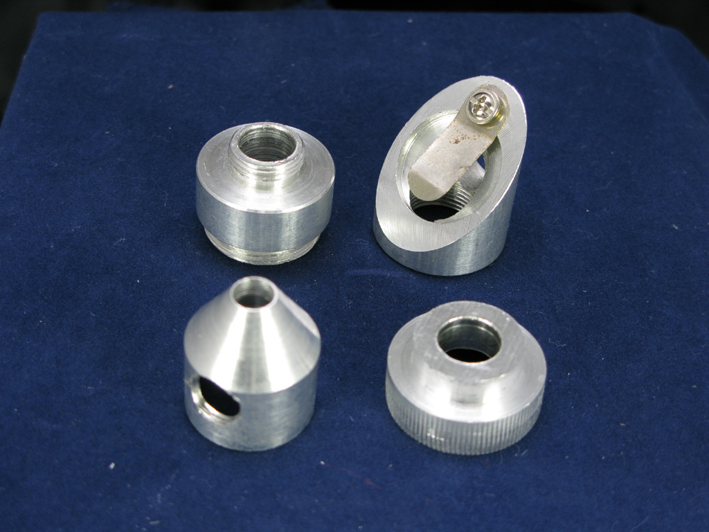

It is nothing wrong with the laser head but you used the Wrong side of the threaded.
Update: just posted an older version for your review (4 parts)

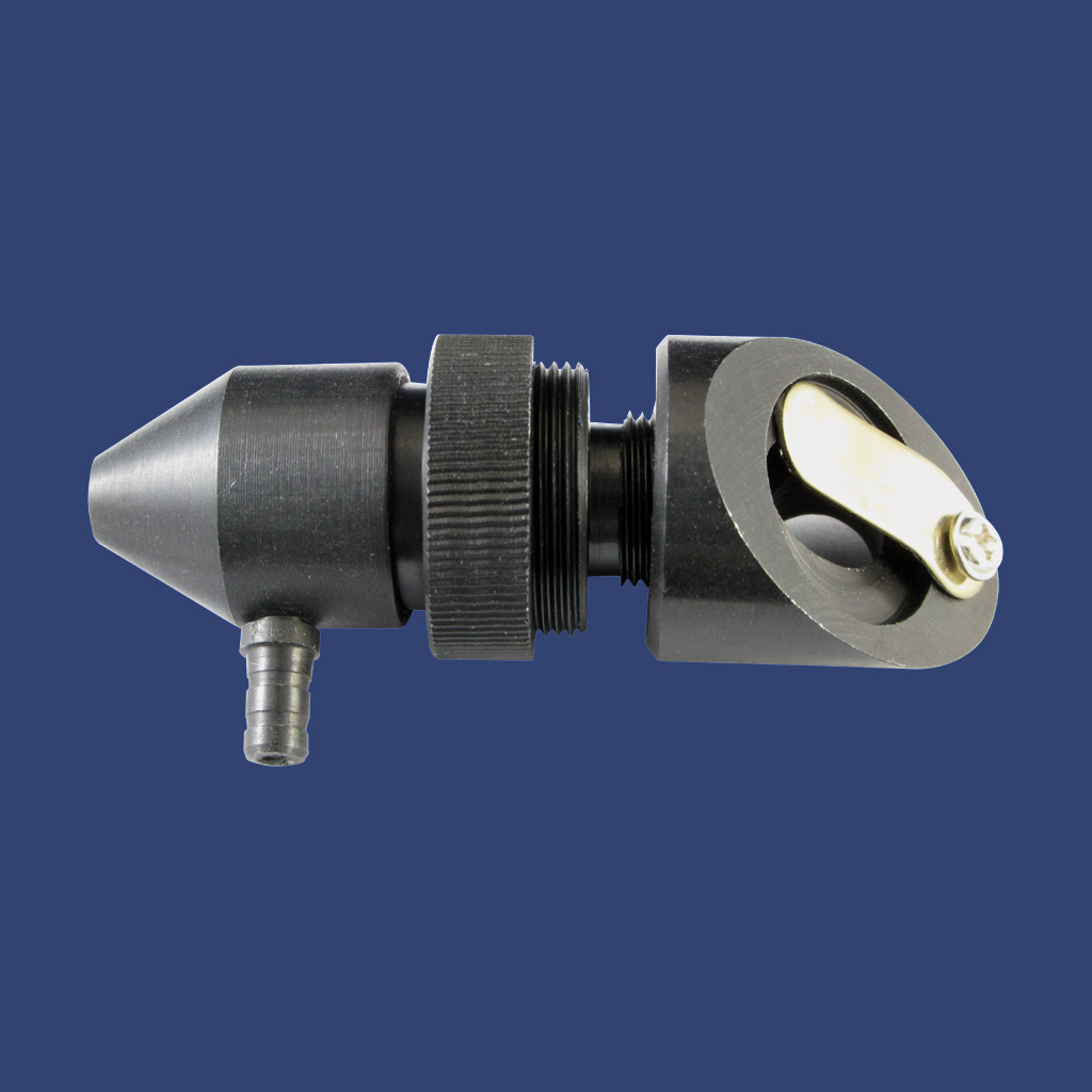

Updae2: I took some pictures of the newer version
