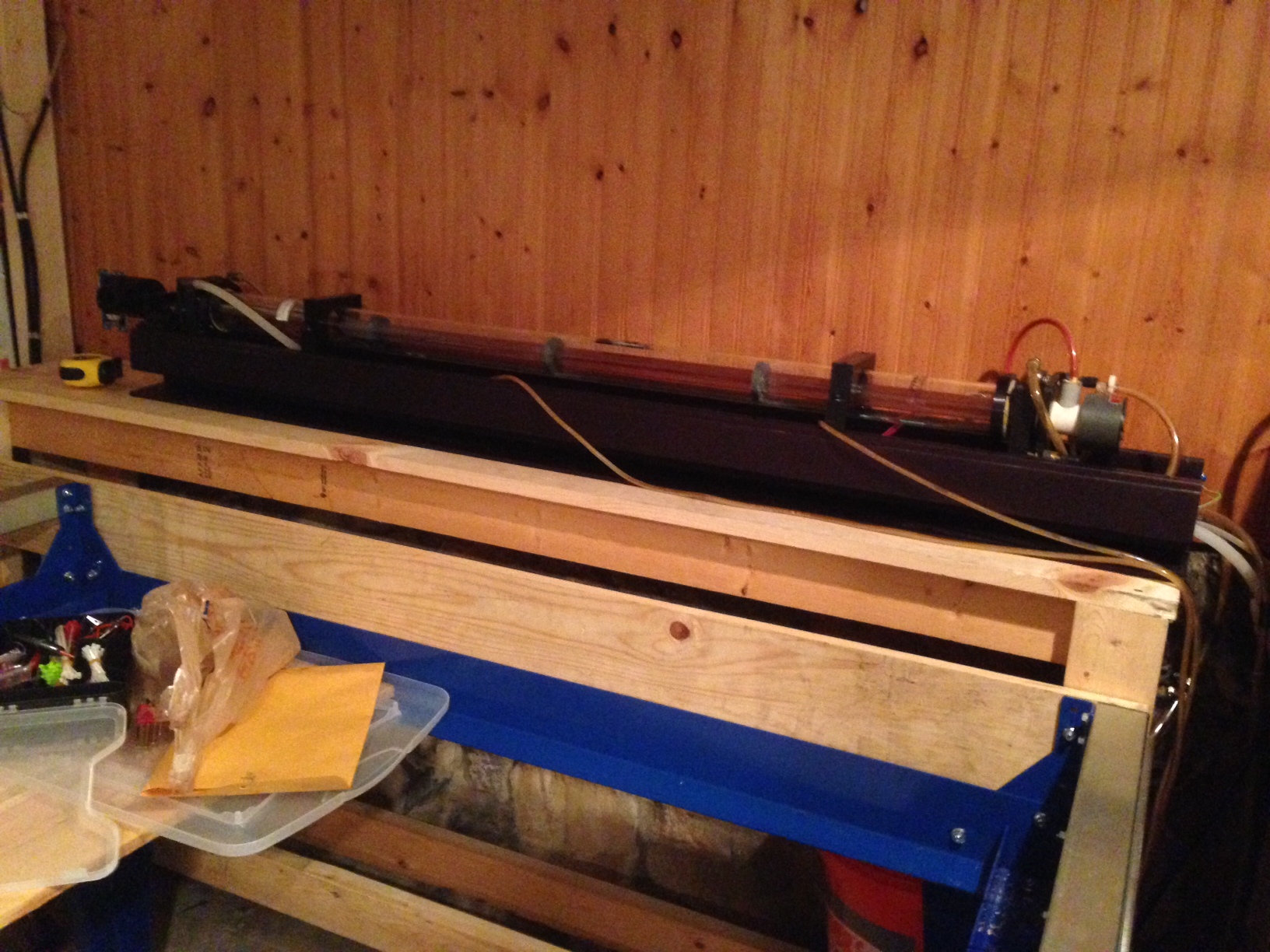

Thanks for the response! I am attaching a few pictures I have from my phone (I will take more pictures tonight of the other parts you mentioned and get those uploaded as well tonight). If you would like to see the schematics I can send those too.
As for the Power Supply, this is what is connected to all of the internal components of the cabinet (water pump, gas regulator, interlocks) as well as the Laser itself (basically it makes everything run that I purcahsed from this guy).
Here are the pics I have, will get the rest tonight for you!

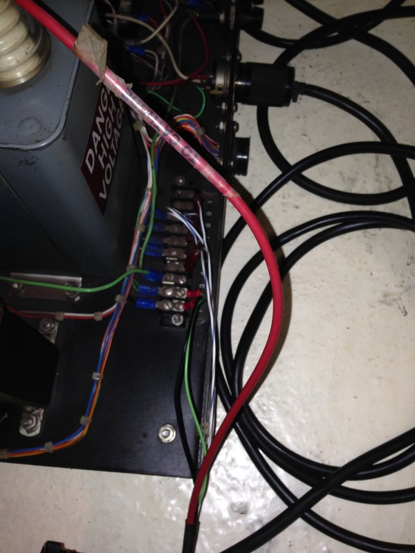

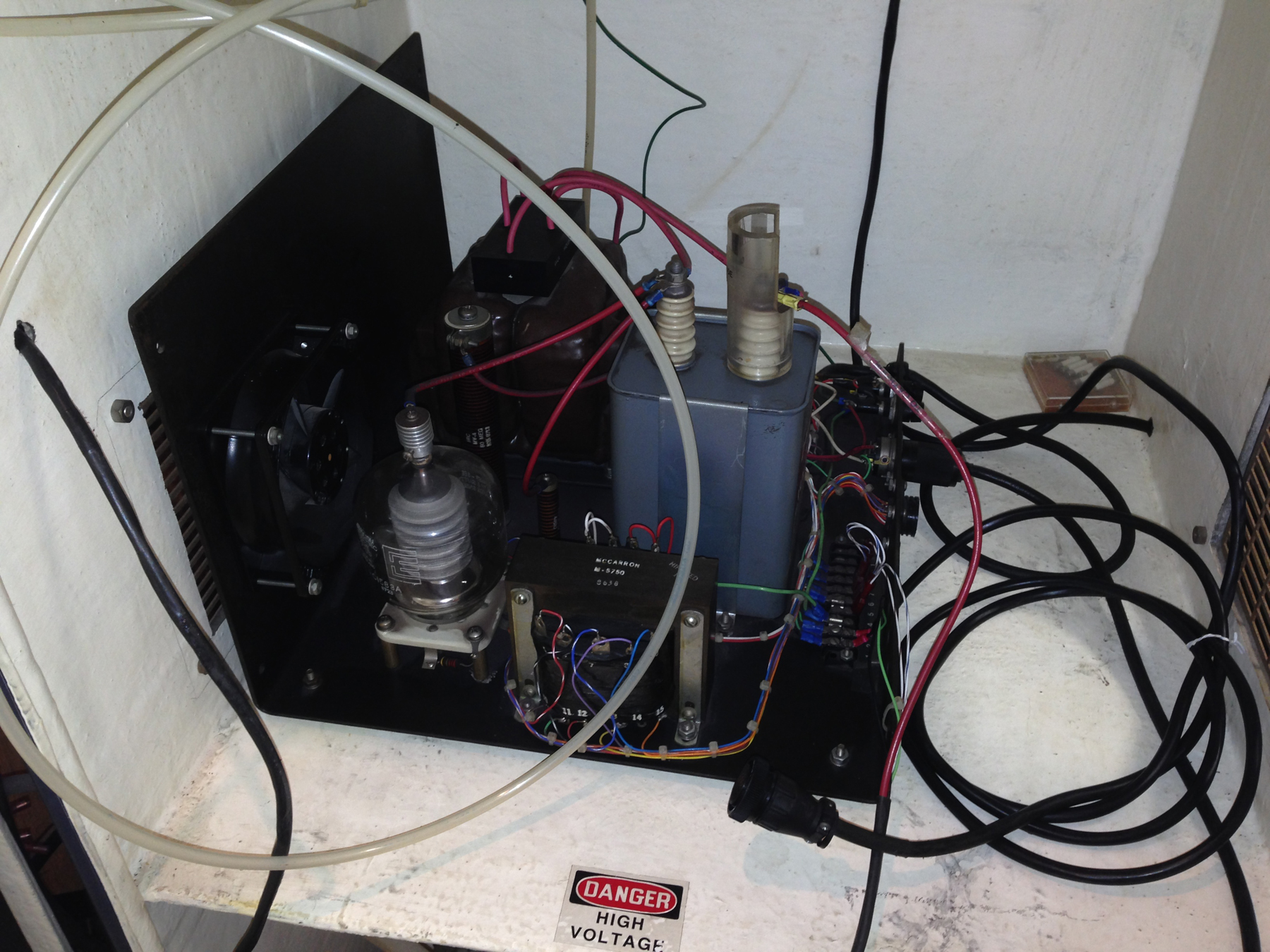

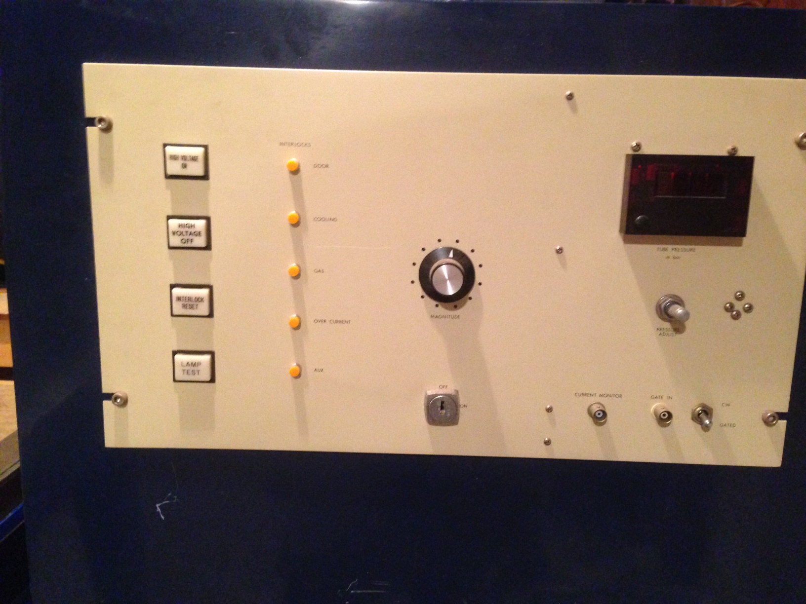

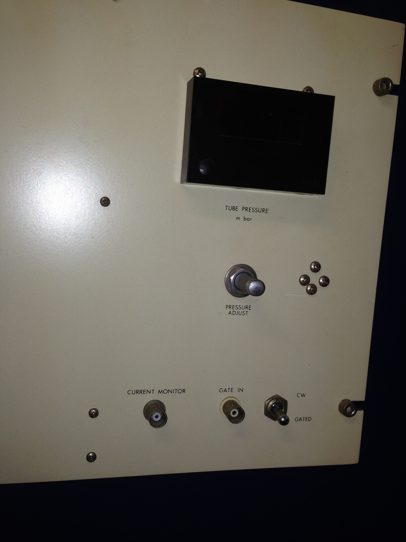

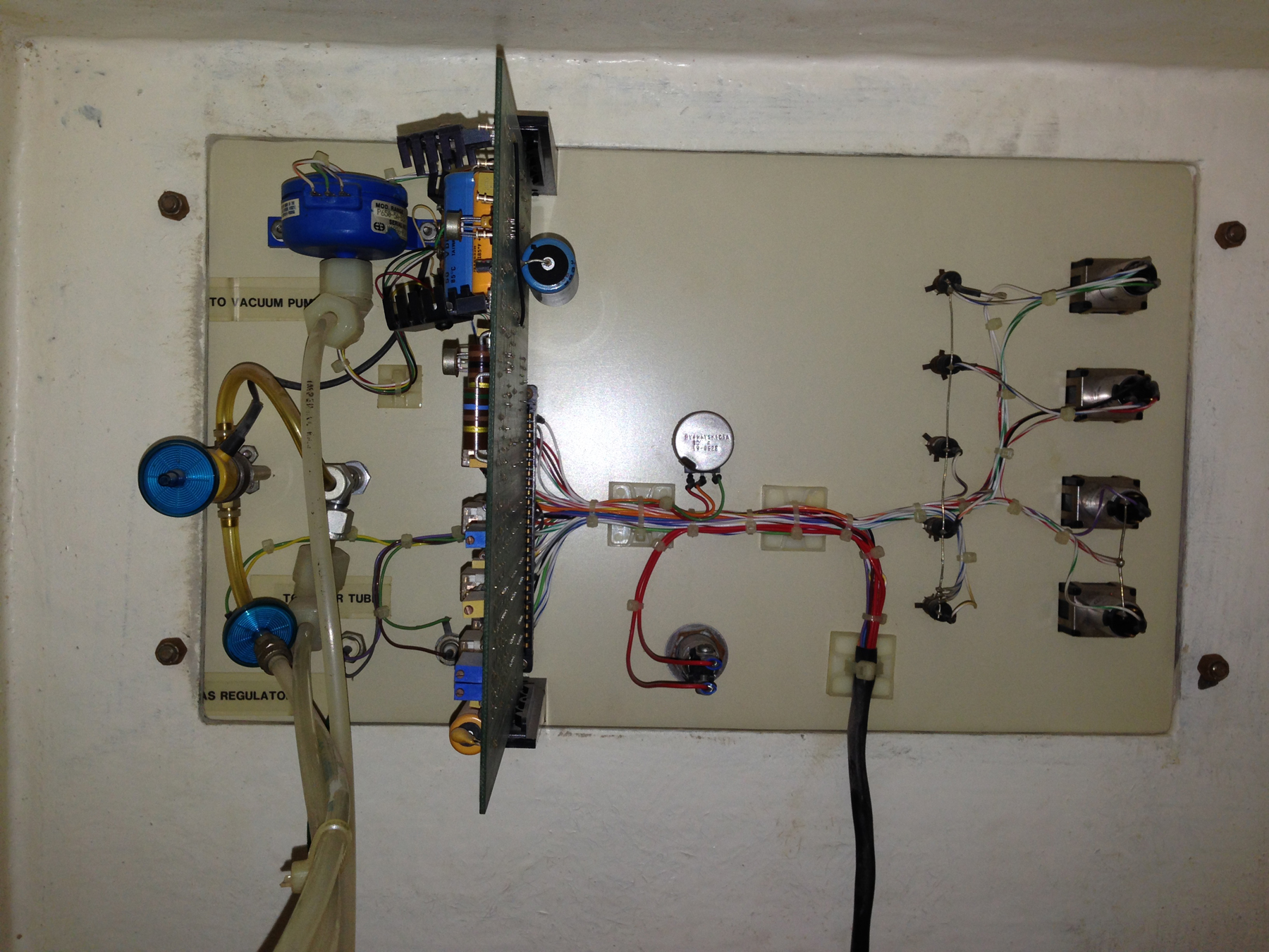

Ok, here are a few more pictures. As you will notice, this isnt an "ordinary" power supply - or at least I do not think so. That being said, it shouldnt be impossible to still communicate with it - but I may need to post the schematics for someone to fully understand it.
I am also posting a picture of the "Wire Port" as I call it. This is a simple wire station where I can unplug wires and plug in others (this is where I plugged in the wires laser to the power supply - as well as to the cathode).
The other two pictures are simply a closer shot of the Gate In on the front of the interface as well as the entire back-side of the interface (the Gate In is in the lower left of the image and slightly covered by the "To Vacuum Pump" hose.
Again, any thoughts/comments are greatly appreciated. If buying another "up-to-date" power supply is the route I need to go that is understandable but ultimately this thing runs everything for the laser, I simply need to have it communicate with the AWC608 controller.
Note: I apologize but I think the images were uploaded in the reverse order (the power supply is at the bottom of the list).

It is such a piece of nice class electronic art and I admired the guy or company who built it (I'm EE in major so I like electronics stuff
By looking at the pictures you posted, I'm afraid to tell you that the DSP may find a hard time to work along with the interface it has. I suggest you to get a modem laser power supply to work along with the DSP controller. It will save you a lot of trouble as connections are standard. Plus, you can by pass all those controls on the panel. By the way, is the laser tube 20yrs old? Or is it a new replacement tube? FYI, most laser tube works fine within 2~3 years. Over 5 years some CO2 gas may leak out and performance will be greatly affected.
