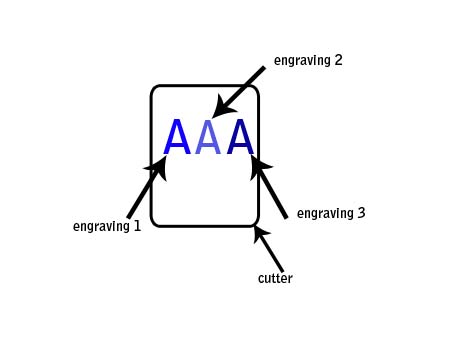

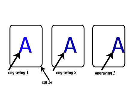

I have a problem when I carve or cut more objects, not the same, I'll explain: the first incision and cutting are fine but the second moves only engraving and cutting remains where it should be, the third is even more moved. may depend on what?
I need help, thank you.
do not match the incisions or cuts

- It is not the alignment, when it affects you move slightly to the right (Image1), even if I do the engraving in the same place (image2)
- engraving esempio1.jpg (28.85 KiB) Viewed 3432 times

Sounds like your laser alignment worsens as you travel away from your laser.
Re: do not match the incisions or cuts
It seems that is was an mechanical issue. How fast you ran it
If it wasn't running fast and it happened,it could be a motor issue.
What resolution did you use onthe motor driver; 1/2, 1/8, 1/16... you may want to try 1/16 see if it fixit
One more thing you can try. Change the falling edge/rising edge see if it fix it. If X was in falling edge, change it to rising edge

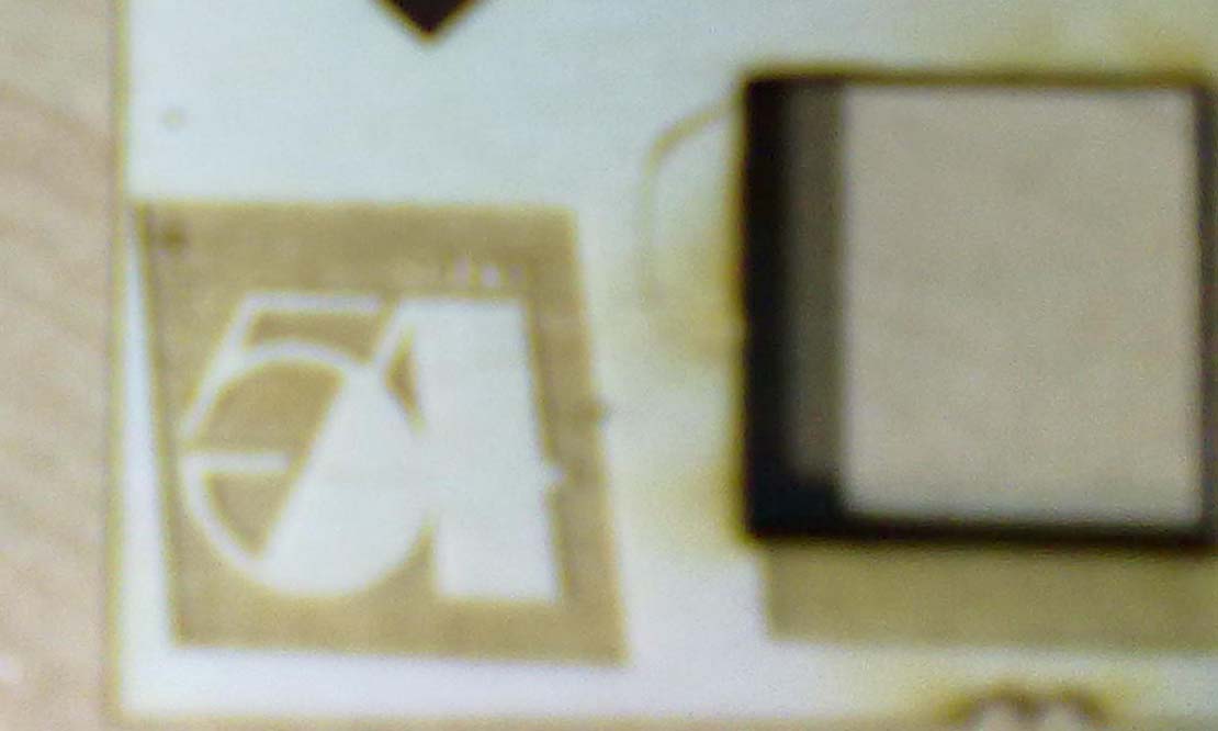

my steping motor is set to 1/16.
140 to engrave speed and power of 10%. and it always worked.
I tried to do as you told me, but it did not work me is worse.
I motato a new problem, all you carve is distorted (see the logo of the study 54 photo 2) and instead cut what is right.
the engraving of the logo and made from top to bottom, I also tried from below upwards, but it is worse.
I checked all the straps and screws but that's okay.
I reversed the microstep 2m415 but nothing changes.
might be a firmware problem?
