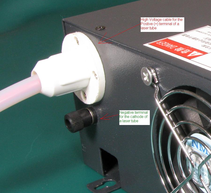

Re: connections for k40 laser tube
If you have ordered a 40W PS with black case from me, there is a connection terminal (screw & banana plug) and it is used for negative connection of a laser tube
See attahced image
See attahced image
