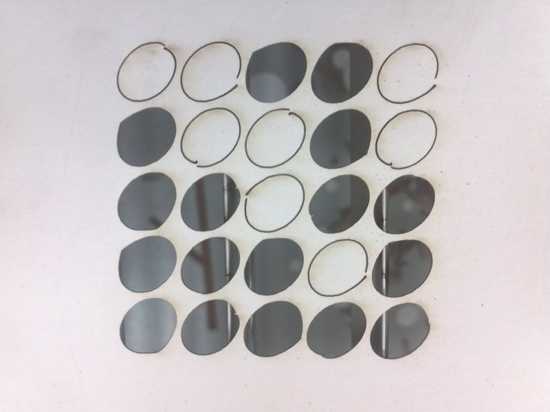

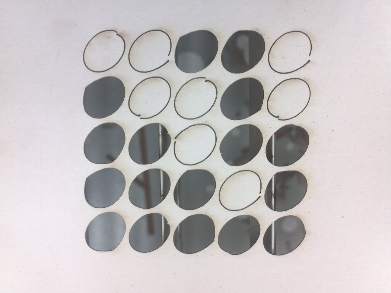

Hello everyone,
I ran into a pretty weird problem today, we just finished building 2 cutters with the 2012 DSP, both with the same exact hardware, one of them runs perfectly fine while the other shows the issue you can see in the attached pictures:
, the circles don't come out round!, I tested cutting an array of circles of 10mm diameter, perfectly round in the drawing and the result is awful, I tried everything I could think of to solve the issue, I checked for bad grounding, bad connections, switched to a previous firmware, changed encoder resolution, retuned the motors, but no luck, I noticed one thing though, the issue gets worse with higher cutting speed, the cuts in the pictures were made at 100mm/s and 50mm/s, the letters were cut at 100mm/s, if you look close the letters only show defects on the curves, the straight lines cut well, with accurate dimensions. Does anyone know what could be the problem?, as every other build we make this is for a client and downtime is a problem.
Edit, 2013/23/05:

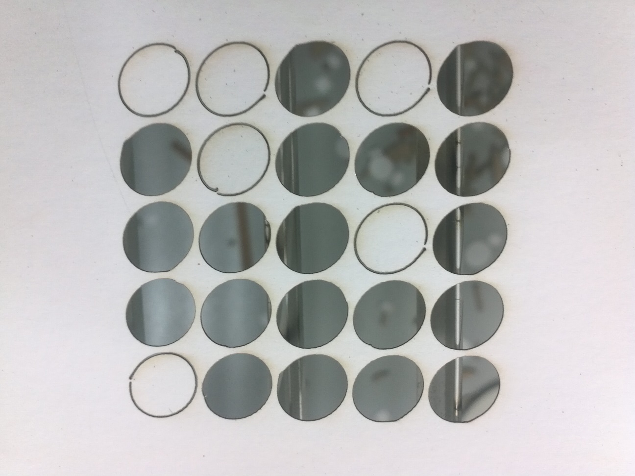

I solved the problem!, it was the Y axis servomotor tuning!, it seems that the autotuning function of the Yaskawa servopack is not that good, I retuned the motor manually and the problem is now completely gone, I can vector cut a 5mm diameter circle at 100mm/sec and it comes out perfect!, thank you everyone for the suggestions though.

I tried your suggestion but it didn't work, I unplugged everything from the laser controller and checked the X and Y outputs with an oscilloscope, the signals are coming wrong from the controller!, if I send the controller to cut a triangle I get an uniform waveform in the lines that use only the X axis but when both X and Y move the waveform gets very distorted, this only happens to the X axis pulse signal, the Y axis pulse shows a perfect waveform, I think I may have an old lasercad or firmware version, I have version 6.27, I have 2 DSPs and I tested both, both of them show the problem I described and It has never happened before, this happened only with the last controllers I bought from you, any suggestions on what to do?, should I try upgrading lasercad and the firmware?, my firmware versions are:
Main board: 7.12.8.17
LCD:5.12.2.29
on the other DSP i have:
Main board: 7.12.12.26
LDC: 5.12.2.29
Please help me solve this, my client is getting impatient.

I updated firmware and lasercad, no luck, I even tried replacing the DSP, the power supply, the motor driver, the problem remains, for the record I'm using Yaskawa Sigma 5 servo motors and drives, I read somewhere that someone else is using the same motors, any similar problems?

I swapped motor signals, when I do that the problem changes, it seems to "rotate" so I think it's not a mechanics issue, but it's hard to know, maybe I'll think about a toolpath that helps me determine Wether it stays on the X axis or moves to the Y axis when I swap signals.
One more thing I noticed: This problem happens only when the two motors have to move simultaneously, if I make a square or rectangle it comes out perfect, I think that means its not caused by a loose pulley, I made an array of squares to look for backlash and the sizes and spacing comes out perfect, my machine uses high end belt driven linear actuators, these have nearly zero backlash and are very rigid, if you see the letters I cut the problem only shows on curves or diagonal lines, not on horizontal or vertical lines, I think it has something to do with the the motors not being able to maintain the correct speed and synchronization between each other, I think that since the issue gets a lot worse as I increase the speed, and it is more noticeable with small objects, if I keep the speed low and the objects large the problem is minimal but sometimes my client wants to run a vector cut at high speed, low power just to mark the material and that's where the problem gets worst.

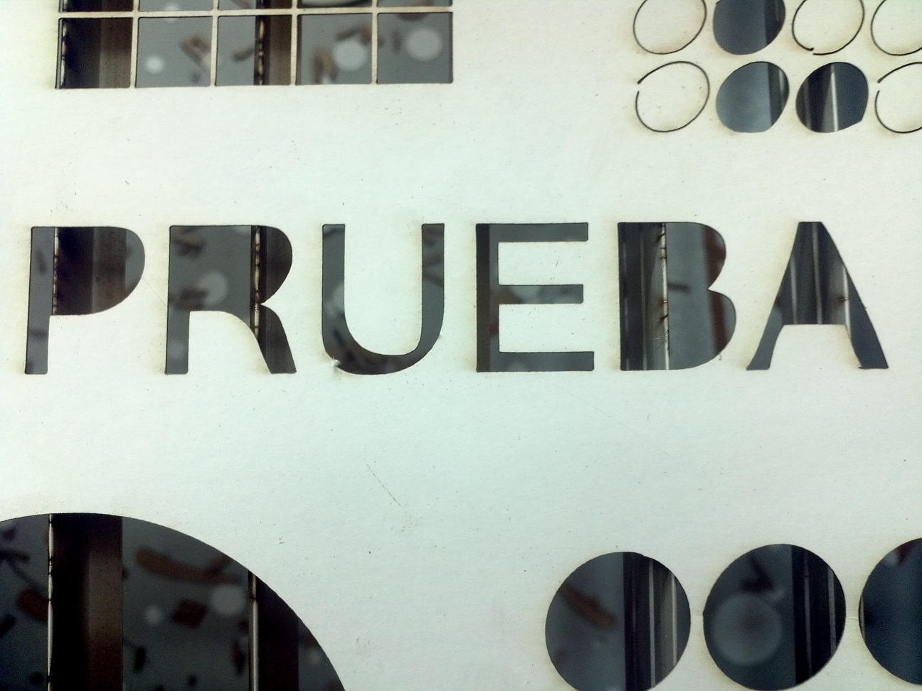

I noticed one last thing, if I engrave something and then cut it the engraving is moved to the right by a couple millimetres only in the X direction, and this offset is constant no matter the size of the artwork, the engraving comes out with correct size and shape but it is not located correctly. Hope that makes sense, English is not my first language.

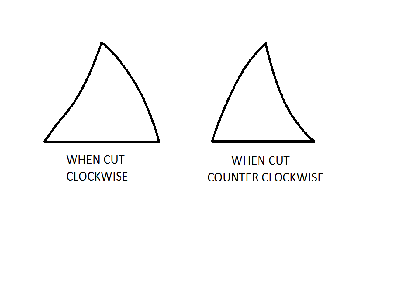

You're right, I tried a triangle instead of a circle and only the diagonal lines (where both motors move) show the problem, the result is something like this:Raman Narayan wrote:The problem is definitely due to XY steppers loosing steps.

Notice the problem is reversed when I change the order in which the lines are cut (clockwise vs counterclockwise) from the results I think its one of two things: a) the X axis is accelerating too fast compared to the Y axis or b) the Y axis is accelerating too slow, lagging causing the line to be distorted, the amount of pulses seems correct as the height of the triangle is of correct size, this means there are no lost steps, I think it is the acceleration/speed that's not in sync or something like that, it actually could be crosstalk as you suggest, I'll rewire the pulse/dir lines with shielded cable just in case, now that I think about it I used the drives software autotuning feature to tune the motors, maybe it didn't do such a great job, I'll plot some graphs to check if the motors are following the command pulses correctly, any other ideas are welcome, this problem is really confusing me!

Re: Circles not round!
I assume the triangles are approx 10mm per side.
Cut them at something like 50mm per side. Same speed etc.
See if the resulting shape is the same or not.
My guess is that the Y axis is lagging but eventually catches up.
Elasticity in the belt drive or similar concept in the servo drive.
When a servo gets behind the drive feeds it more amps until it catches up. Unless it gets so far behind that the drive faults.
Too many things are blamed on "loosing steps". If steps are lost, you generally don't get them back by the end of the move.

Having this same problem, once I changed out the wires from the DSP to the stepper control board to twisted pair (CAT5), shortened the wires as much as possible, and added space between those wires and the limit switch wires most, if not all, of the position error has gone away over long cuts.
