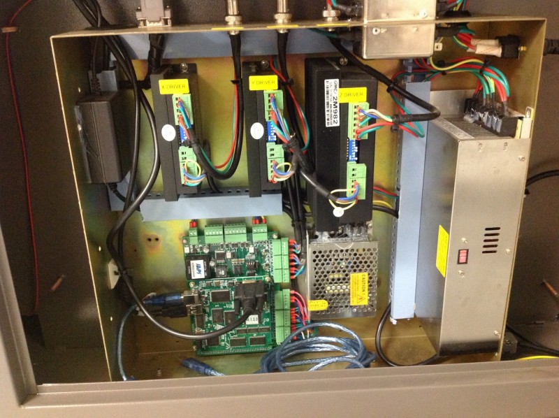

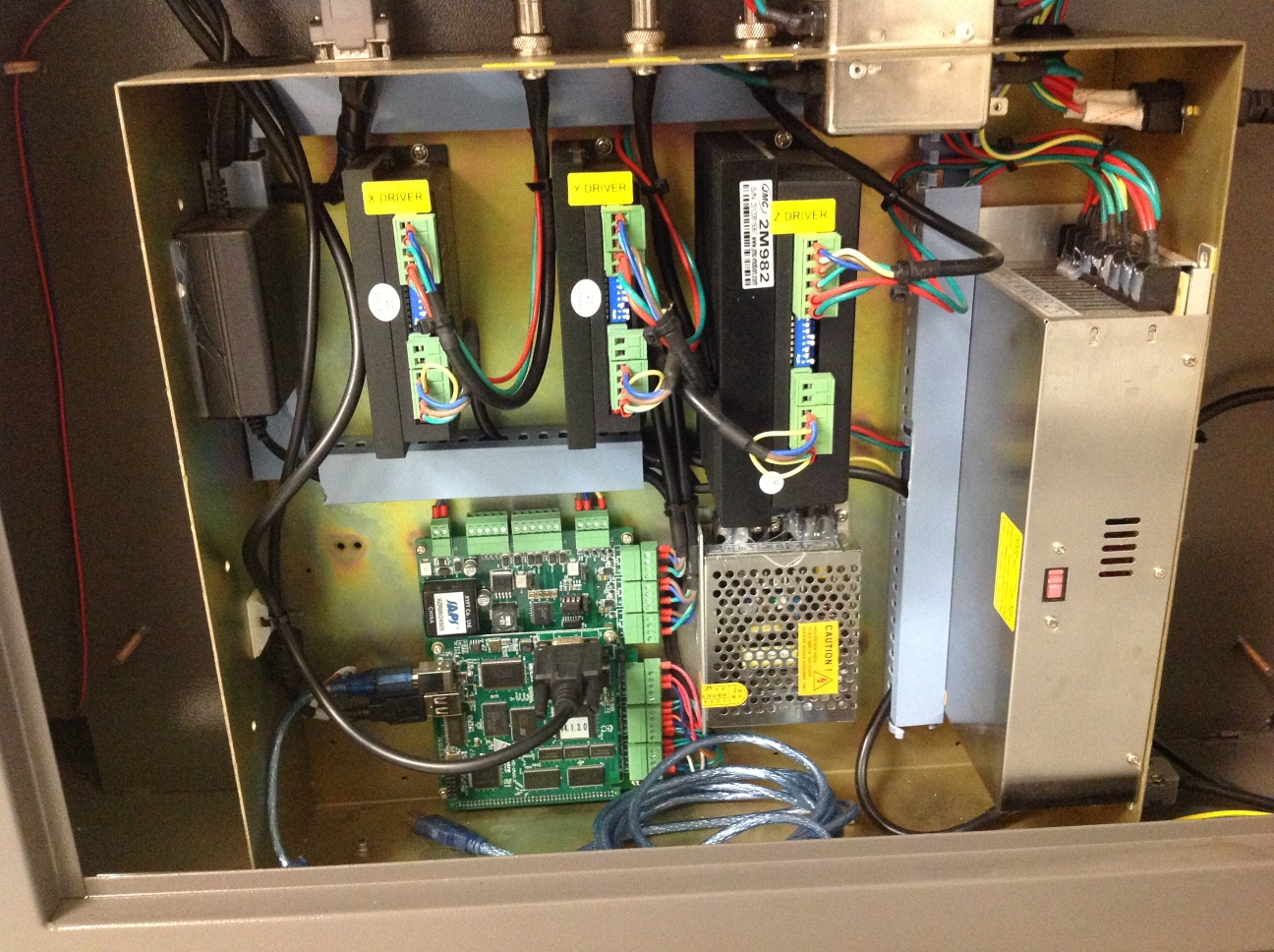

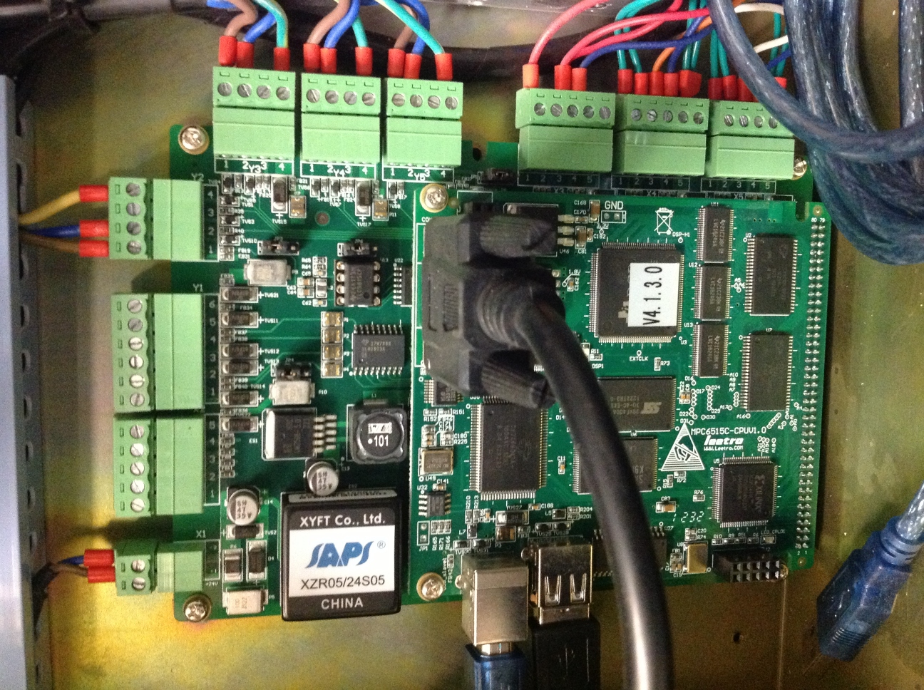

Here is a closeup of the MPC6515C
Entire controller area

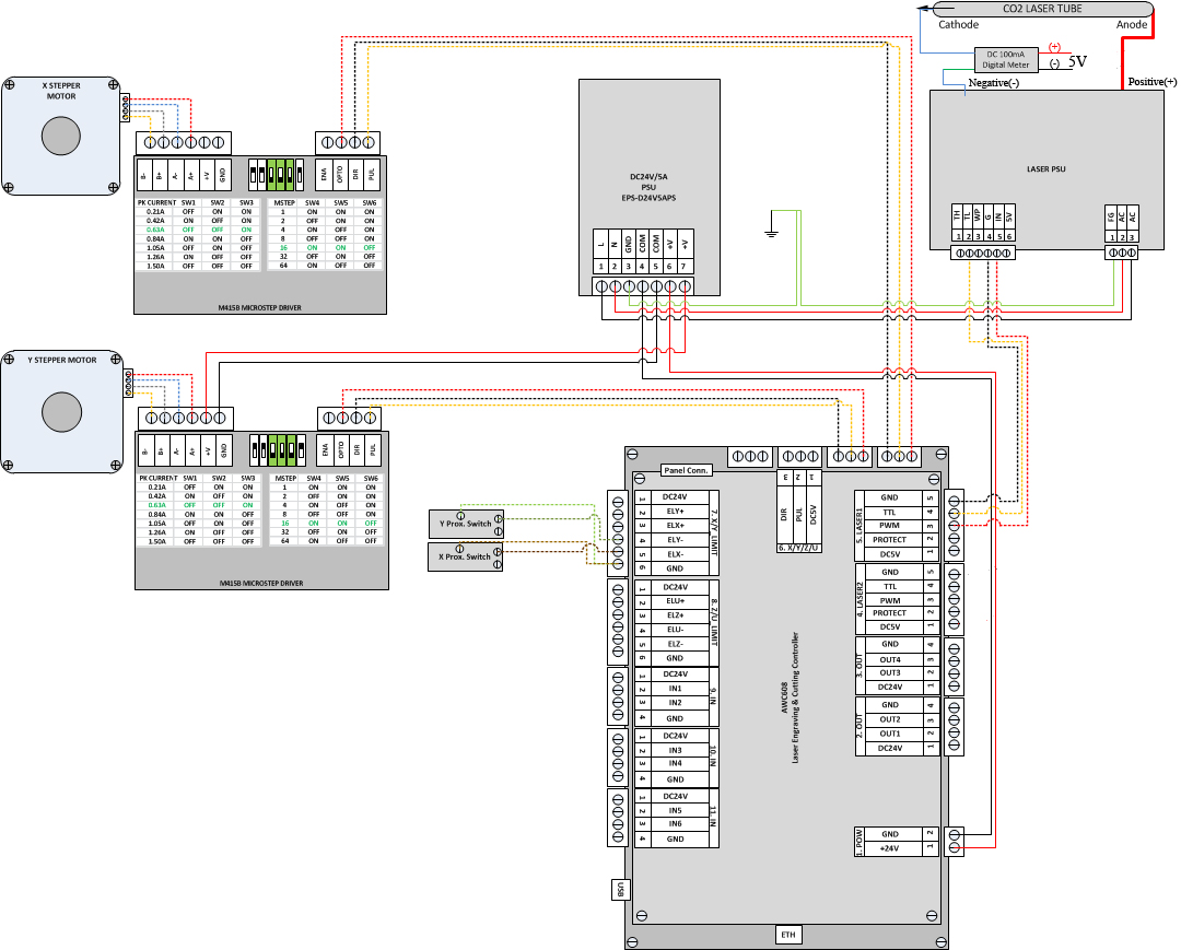

If you can read the connection on the MC6515, then it's easy for you to do the AWC608
See attached image (conneciton diagram of AWC608) created by one of our member.
