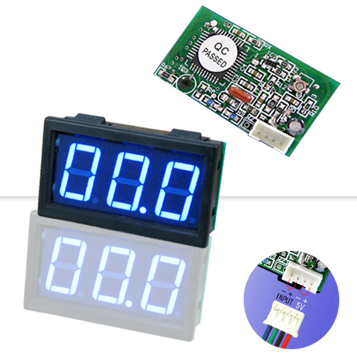

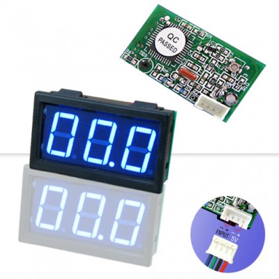

Oh, that will be great. FYI, we're ready to launch our 40W laser machine with this 3-axis controller card installed. We have added a couple things to the machine that came out from a big laser company in China. We then take the 'gut' out, replace it's PS with ours 10A PS, replaced water pump,fan to DC12V version, and other feathers are added like the Emergency Stop, Limiting sensor switches, and it's capable to run a joy stick. It runs very fast if you look at my video post on YouTube under "Speedythinker"
Oh! almost forgot to mention that we add a Blue Color digital current indicator with faster sampling (others are slow) to monitor the laser current. It will looks good! I'll post the image here very soon. Cheers!
