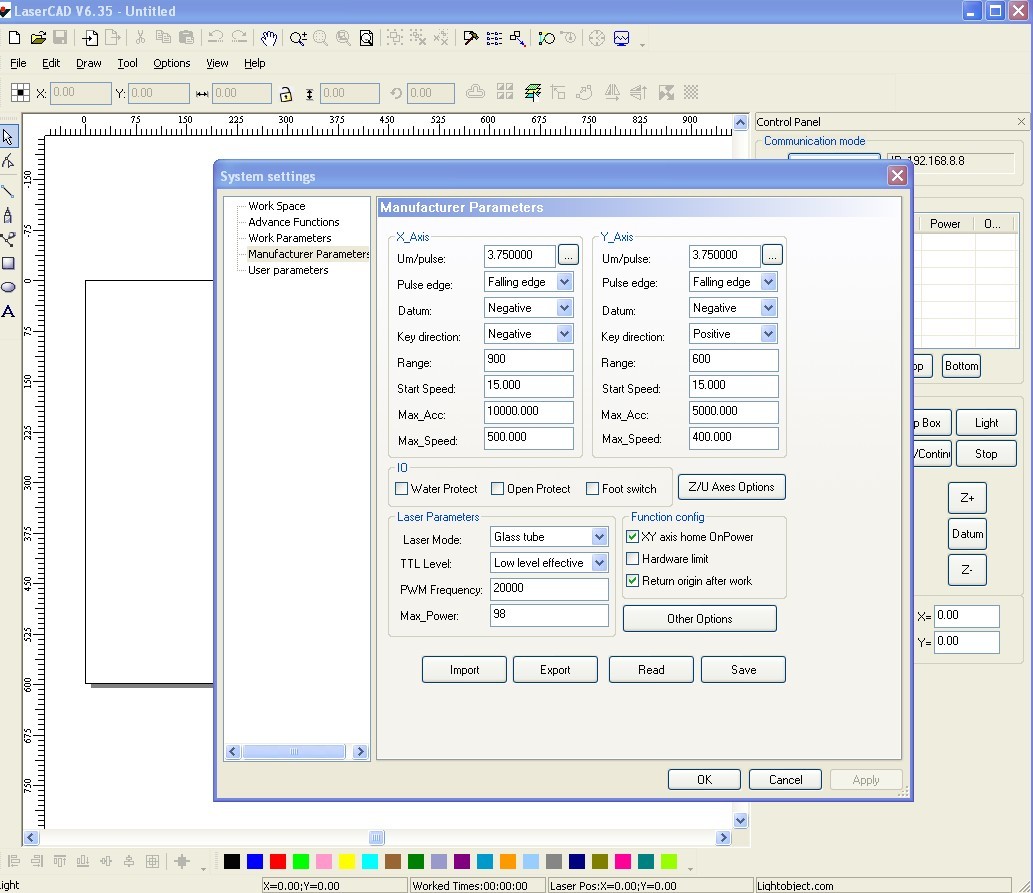

I have a few questions about the DSP setup:
Question 1:
I have tried loading the updated software files to the machine, I select them from udisk and press enter on the keypad and it says error for V6, v7 and v8.
Which file do i need to upgrade to? How do i upgrade?
Question 2:
The laser works and cuts the work piece but it wont turn off afterwards, how can i solve this?
Question 3:
If i set the origin and press box or start the machine moves to 0, 0 and cuts from there. How do i position the machine to cut where i want?
Dan
- Posts: 4656
Re: Dubstar_04 - 40w Chinese Laser DSP Conversion
Question 1:I have tried loading the updated software files to the machine, I select them from udisk and press enter on the keypad and it says error for V6, v7 and v8. Which file do i need to upgrade to? How do i upgrade?
Ans: Look at the version of yours by using the LCD control. Scroll down to the last one and check the version. It will show one of those 6,7, or 8. Use a USB memory stick 2GB to 8Gb and plug it into the USB connector on the DSP controller.
But, you don't need to do it as you're the latest one.
Question 2:The laser works and cuts the work piece but it wont turn off afterwards, how can i solve this?
Ans: Check "TH" or "TL" connection. You may want to use "TL" to instead of "TH" for firing control
Question 3:
Ans: Use LCD control panel to change the Origin setting. Currently you're using "Machine Origin". But you may want to use the other two modes; Software or
Question 3:
