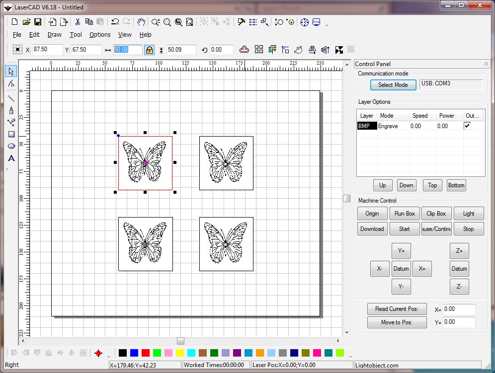

Hi, I was wondering if anyone else was having the same problem I am? The problem is the size setting always automatically adds .01mm to whatever size I input (see highlight area in attached file).
These were set out in Corel DRAWX5 and sent to LaserCad 6.18, the original picture was copied and pasted to make the 4 copies.
So I started out with the size set to 50.00 x 50.00 in CorelDRAW and sent to LaserCad. As soon as LaserCad opens the size automatically changes to 50.01. I have changed this several times to be 50 x 50 and it automatically changes to 50.01. I have also noted that if I click between the two boxes it adds 0.01 to the size, example if I click on 50.08 and the click on the box beside it 50.09, then click on the 50.08 it will change to 50.09. The same will happen to the 50.09, it will change to 50.10.
Any ideas, I didn't have this problem with version 5.95.

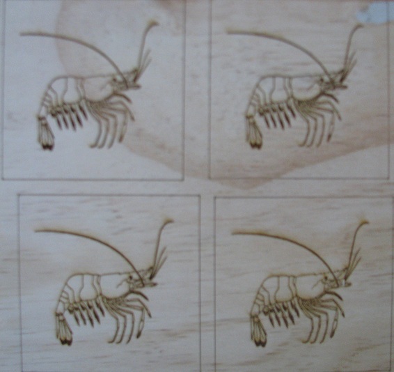

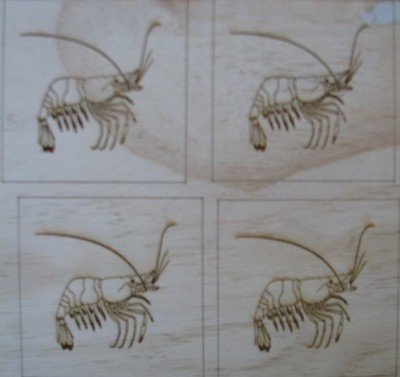

I am also having a problem with array output not lining up when engraving but it looks right in LaserCad. (attached file also)

It's just an 'display' issue. Nothing to do with the 'physical' error
Anyway, a new version LaserCad V6.27 is available now. And OS for maineboard upgrade is also available
