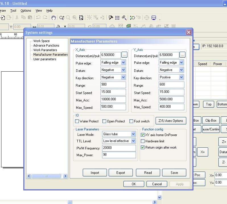

What is the setting on the "Manfuacturer Parameters"?
I haven't had a chance to test it yet. Can you post the setting of yours to let me to take a look. Pay attention to the "Distance (um)/pulse" FYI, you may try to recover by running the previous version. Give a try.

I have the manufacturer parameters exactly the same as they were before the upgrade, note that the problem only happens on engraving, if I do vector cutting speed and acceleration are normal, here are the settings I'm using:
Manufacturer parameters

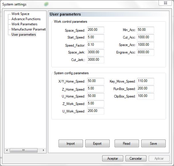

Can you also send "User Parameters" and the file you have trouble with (.pwj5)

This is the user parameters, I even reduced cut jerk and speed jerk a lot but the problem persists, I had to load an older OS version, Please make some engraving tests, thank you!
