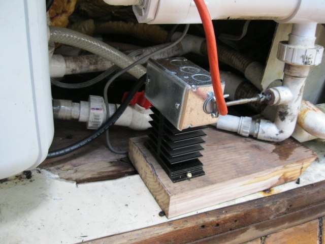

richiem
- Posts: 270
Re: SSR wiring
I have a couple of times cut a slot in a box the dimensions of the center web of the heat sink closest to the mounting base for the SSR, and slipped the heat sink into the slot, with the SSD inside the box and the heat sink outside. That way there was ambient around the heat sink but the wiring was protected. Pix attached --
