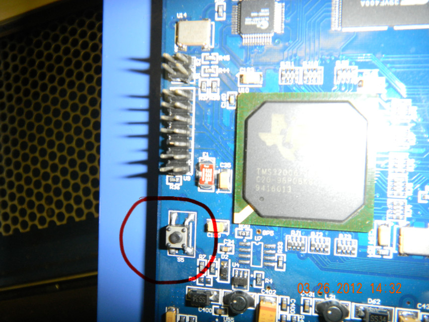

Hi there
if you have the PHcad dsp v. 2.0 ( the blue caver) the probleme persist and as far as I know there is no patch.
this has to do with the way the memorie is used because the memorie is right on the min border
of the size what is needed ( acording to Ti the manufacturer of the dsp chip) the memorie what stores
the files is also used for the working of the machine some of the stored files will be over writen because
the machine data have priority.
the only way to solve it is like you allready found out to download the files everytime new after interuption
steps should be format the memorie ( from the PHcad software im download menue) and the dispaly,then reset
from both again ( programm and display) delete all files during download process in this submenue and download the file with different name.
if this still doe not help take off the DSP cover and there is a little switch ( see picture) press and hold it for a few seconds
this is the general reset.

Hi Walt,
That sound like my problem, I already formatted the DSP from the PC but haven't tried from the LCD menu, I'll try that, and if it doesn't work I'll use the reset button, after testing I'll come back to you with the results.
Thank you!
